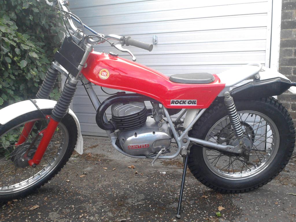

Another update...
I had a price to get the exhaust header chromed and to be honest, need to get some other bits sorted at a later date so opted to paint it satin black, fit and use the bike for testing purpose. I will remove all the chrome parts another time and get them all looking new again.
So now the bike has been sat for a couple weeks I wanted to try get it back together and running again.
We got the rear tyre sorted on the old girl so fitted that back up and adjusted. I also tapped up the engine so I could spray the top half black
Tyre fitted
Montesa Cota Restoration by Mark Boon, on Flickr
Before
Montesa Cota 247 Restoration by Mark Boon, on Flickr
After
After this I fitted the exhaust back on
Other things I have done is cleaned the tank and tap filter out.
Sprayed the screw and bolt ends etc,
Fitted the air filter
After putting the tank back on and checking everything I primed the carb and gave it a couple kicks. She fired straight into life as she did before.
Took a video again, still missing the rear exhaust hose so getting exhaust gases leaking but that will be resolved soon enough.
I even
took it for a little ride up the garden and out the front of our house. Showed my dad and put her back. Just got to clean up a few bits now like the rear fender, get them fitted and she will be out for a test.
I have noticed one thing not working and that is the rear brake. I fitted it as it came off, it is not pulling the brake enough to engage the pads. I have checked and adjusted as much as I can... Looking for ideas on this?
I compared the pad thickness to new and they have well over half left...?
This is the video of her running again

Looks and sounds good! Regarding the rear brake, I am no expert on this bike but most mechanical linkage brakes are made with splines on the brake levers and shafts. this allows you to mount the lever to a different angle to get more or less brake pressure. The screw adjuster on the brake rod is for fine tuning once you get the major position right.
Cheers mate. I have tried adjusting like you mention but moving the splin to the next notch means it is miles away from the cable :( I will double check it to make sure it was not me having a bad day.

Install the lever on the brake hub end, but do not connect the cable yet. Rotate the lever until the brakes begin to touch. If there is a lot of rotation, there may not be enough travel in the cable. So, you may need to index the lever on the spline to take up some of the slack before you connect the cable.
From memory the brake lever fits on to a square on the end of the cam. What I can't remember is if the square was aligned with the cam or whether turning the cam through 180 degrees would effectively change the relationship with the cam and give a better action with part worn shoes. I hope that describes things properly.
Edited by 2stroke4stroke
Guys, I think you have it spot on. I know my mistake.. or at least I think I do. Will confirm when I see it on the bike.
Fingers crossed that is a nice simple fix. I am tempted to try get the bike out this weekend and give it a run, see what is what.

I also sorted the rear brake out. Just needed the changes mentioned above. Thanks for your help on that one.
I kicked the old girl into life, started first kick! Had a little drive up the garden and the front brake is ever so slightly sticking on but think using the bike will resolve this. I also fitted the foot pedal. She is ready now for the tank cover and to be used and tested. I might have to remove the exhaust manifold and repaint with heat resistant satin black :(

Hi Mark
Just noticed that the front brake arm is behind the fork leg, it should be in front . This will move the position of the brake actuation lever so you might have to adjust it like you have with the rear brake , it will give a straighter pull on the cable making it less likely to stick.You can just make it out behind my horrible Red Forks.post-18607-0-96087100-1380201584_thumb.jpg
Cheers
Dave
