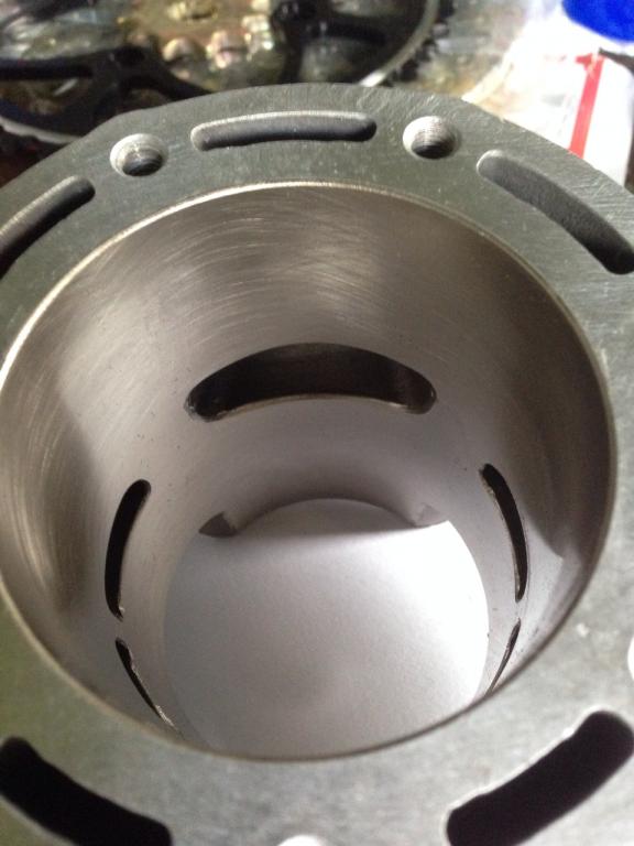

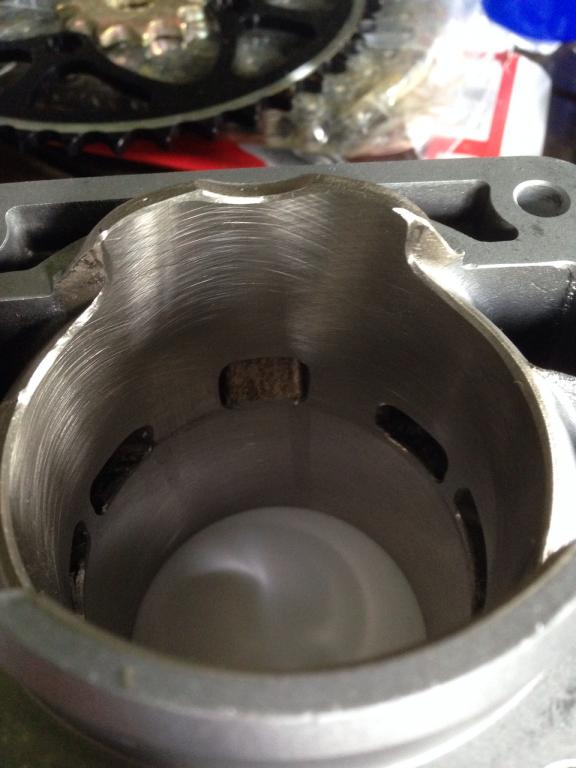

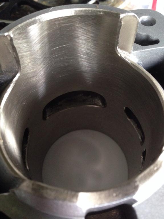

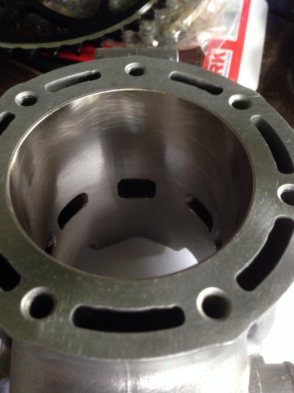

This is the re plated cylinder done by langcourt, looks like new to me.
