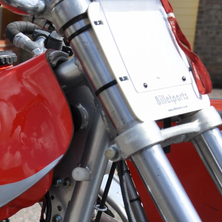

The only down side to these bearings is the fact that they are slightly taller than standard. So the yokes land up slightly further apart. So the bottom yoke doesn't quite line up on the knurled part of the leg. As can be seen in the photo.
