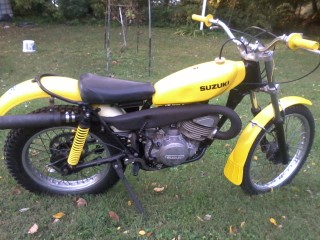

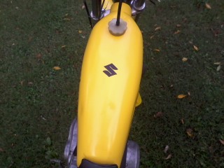

October 4, 201610 yr Author After a long delay the RL is nearing completion. I found a steel tank with a couple of minor dents and decided against the bondo / rattle can repair. Instead I went ahead and used my powder coater and slapped some yellow on it. It's a bit cobby to be sure, but for a rider / loaner it suits me and is durable. The yellow also perfectly matches the new fenders. The frame cut makes for a nice, sharp turn. The silencer isn't standard and a bit on the loud side. It starts very easily and runs strong. The motor puts out a lot of noise, though. I was thinking of some rubber between the fins like my 199 Bul. Didn't these RL's come stock with rubber inserts between the head fins? The top end is new and tolerances what they should be. Here's a pic. Sort of reminds me of the 1975 RM125 tank and graphics.
