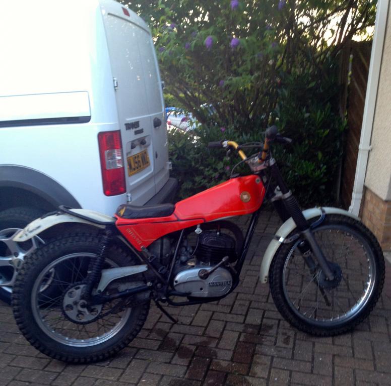

Here is the latest edition to the Cota 247 collection. :)
Picked this one up on sunday, a bit of a gamble as i had not seen it before i made the 300 mile round trip to buy it!
The bike is running great but it cosmetically it is a ruff one.
I want to change the seat/tank unit to the trials one as this one has the trail tank/seat unit with the larger seat.

Here is the one i bought on sunday with the alloy tank and just the seat sitting on it, again thought about a TY tank or something and a seat or pad of some description.
