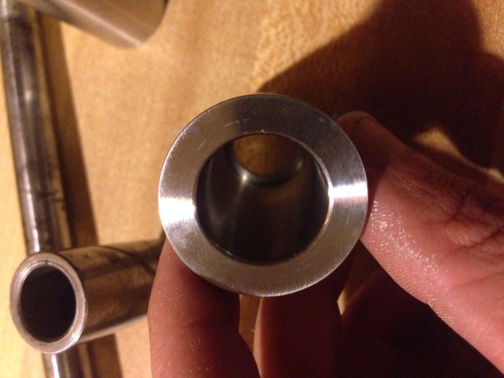

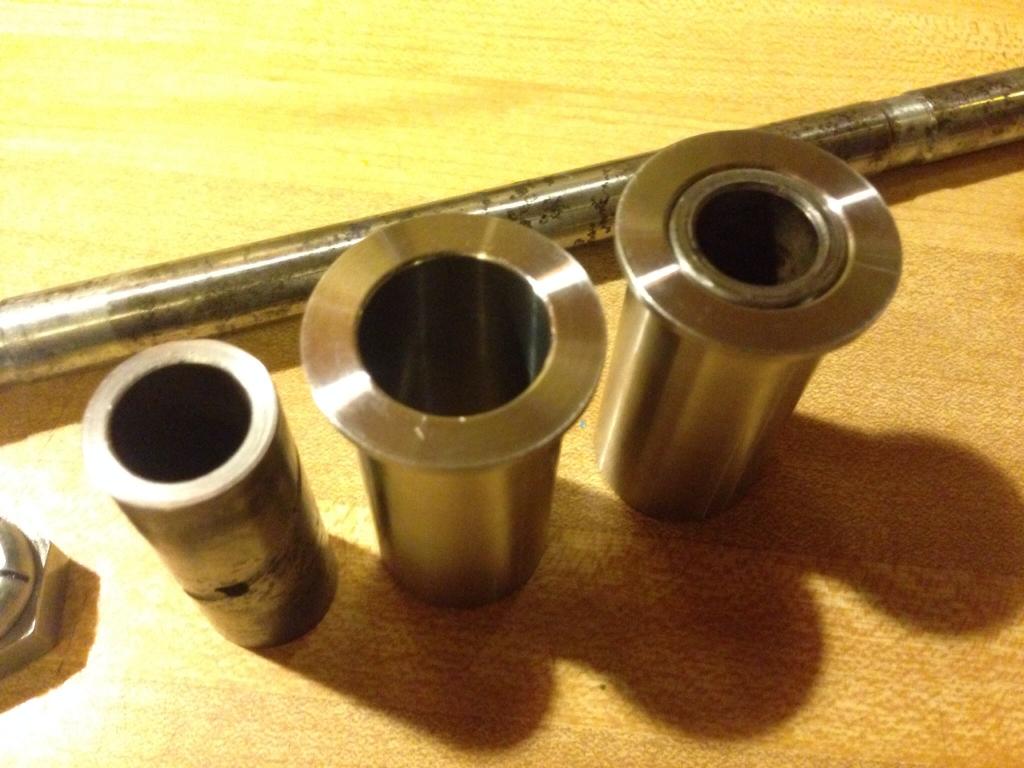

So I've finally made some headway on making new bushings for my swingarm. I really appreciate everyone's input and made the decision to replace rather than work with the originals. What I came up with was to use the axle and bushings from a 70's Honda CB350, which I had laying around. So here is how I am going to make the setup work.
First off the axle is to large a diameter to fit through the original frame holes, so I had to open them up a bit. The CB setup had an axle, which slipped into an inner bushing, which intern slipped into an outer bushing that was pressed into the swingarm. This is what I decided to duplicate. So reusing the axle and inner bushing I had to make an outer bushing to press into the Montesa swingarm. This setup will allow me to have a free moving swingarm that is fully grease-able. I will include a few pictures of what I made below and then a pic later this weekend when I get everything assembled.
The first pic is of (from left to right) the stock CB inner bushing, the outer bushing I made, and the two pieces together...the inner piece is free to rotate and has grease grooves, the outer piece gets pressed into swingarm.
The next picture shows the shoulder inside the bore that will keep the inner bushing in place, the inner bushing sticks out by .005" so that the outer piece will not come in contact with the frame.
