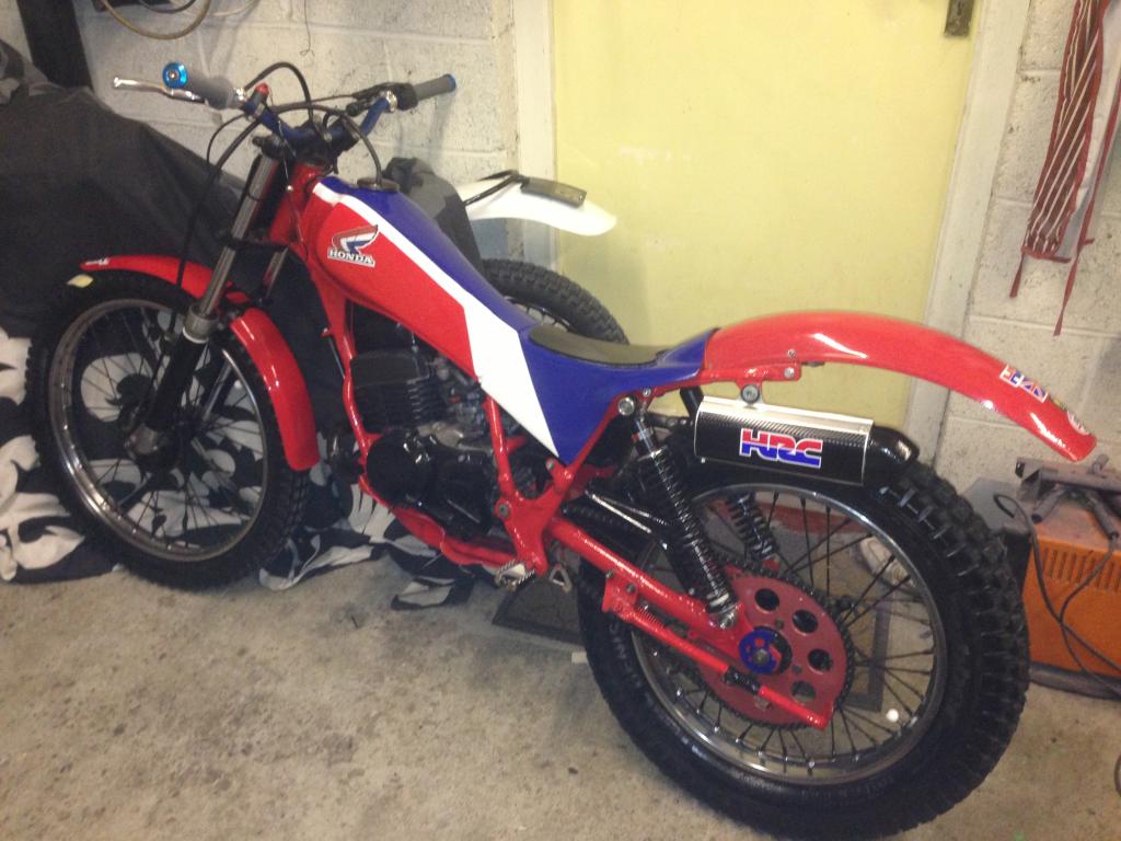

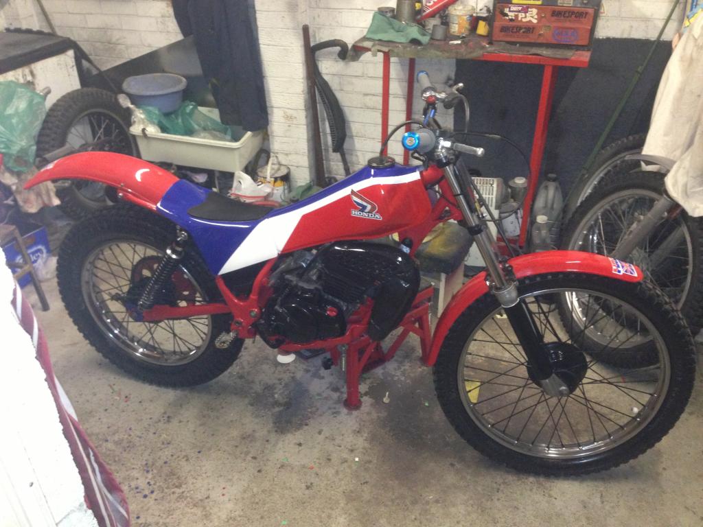

July 14, 201412 yr Hi there Got a TLM 50 for my son, and was after a big bore kit. I cant find anything TLM specific, but can find an MT50 60cc kit below - apparently the same engine ? Can anyone confirm before I buy ? http://www.patternparts.net/fcm-Barrel__Big_Bore_Kits-Honda_MT_50-18-69.aspx cheers John

July 14, 201412 yr Author Thanks for that ! Yeah I've seen Peter Gaunt riding his at some trials - and it certainly is capable ! (as he is as a rider !) We have tried the TLM before strip down - Its being prepped for my sons Christmas present (he's 12) and it works well - just need to rev and splat to get the front end up - but seems a great little bike - a great step uf from his Whitehawk 80 cheers - and think I'll invest in the 60cc kit John
