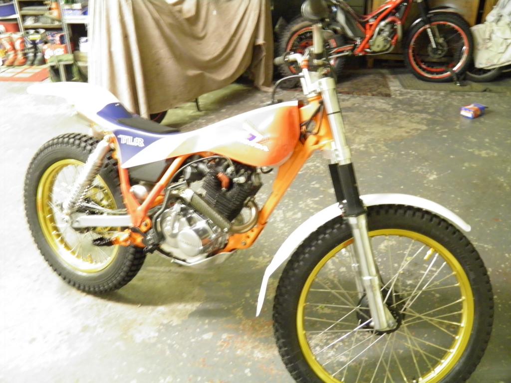

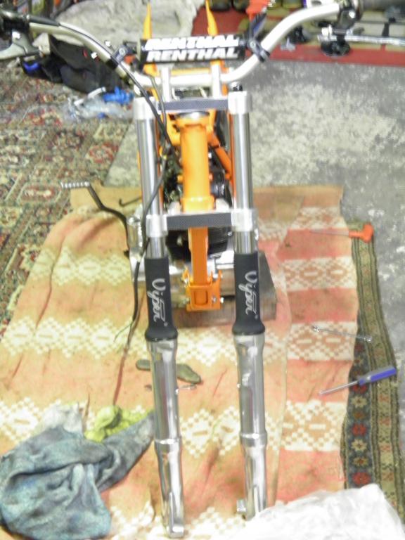

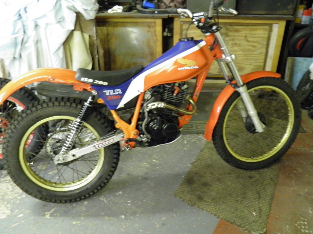

I've just got my TLR frame back from having the steering head modified. Although not back together, I can't see any noticeable difference. So I measured it best I could and it might only have been pulled in by 3 deg.
Is that about right?
I think that sounds about right, 3 degrees at the top translates to more down at the wheel, when you put the forks back in with the wheel in place it should look more noticeable
A friend of mine put 25 ° on her tlr 200 ; works perfectly ;)
Thanks both for the reply. It's going back together now, to be ridden rather than admired in the garage!
Not sure how I'd measure the 25 deg angle. It took me several guesses at about 3 deg because I just had the frame sat on the bench. If I'd thought I'd be questioning the angle I should have taken more care measuring the original angle. Also I measured it from horizontal because that's how the bubble is on my spirit level.
I've found it difficult to get any meaningful info also. Also how to translate onto specific frames. Did you try extending the shocks / dropping forks through yokes first.
No I didn't try changing the forks or shock length.
I have fitted Rockshocks, but they are the same length as the old shocks.
