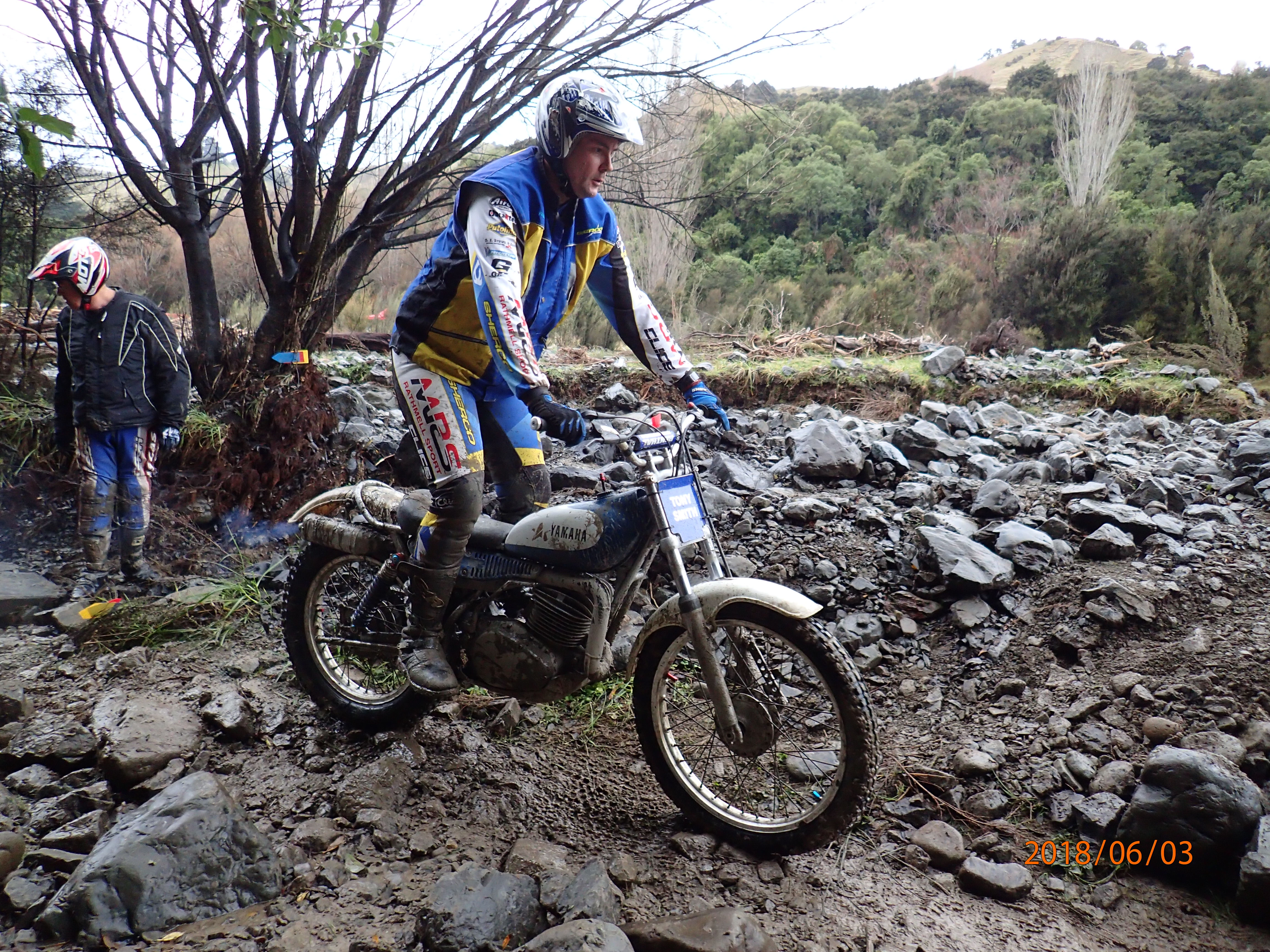

I'm still undecided Guy. The Majesty damper rods make the front end feel less busy than standard TY on stream bed rocks. The gold valves feel like the front suspension is more supple than with the Majesty rods and they provide an equally good (calm) feeling to the front end. Overall both make for a more relaxing ride in rocky stream beds compared with standard but I can't decide which is better. I find the Majesty rods make the front suspension action feel similar to a Bultaco front end.
As for rough downhills with the front end loaded up, the Majesty rods work very well straight out of the box. The gold valves require careful setup to get the right balance between compression damping and fork spring rate and fork spring pre-load to be as good as the Majesty damper rods when riding rough steep downhills but are just as good for this when set up.

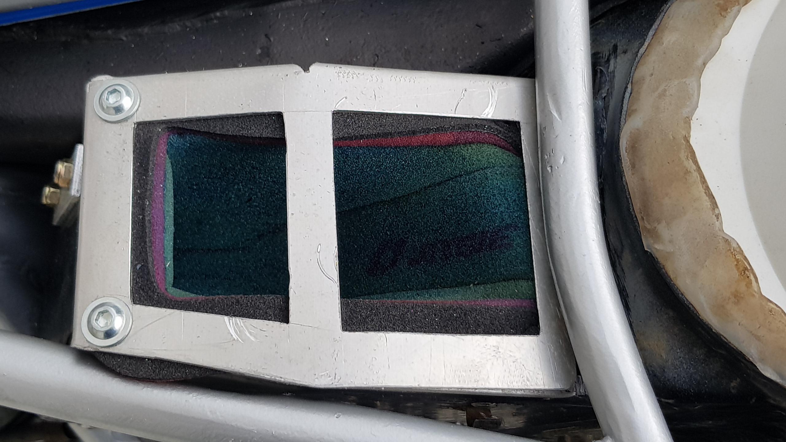

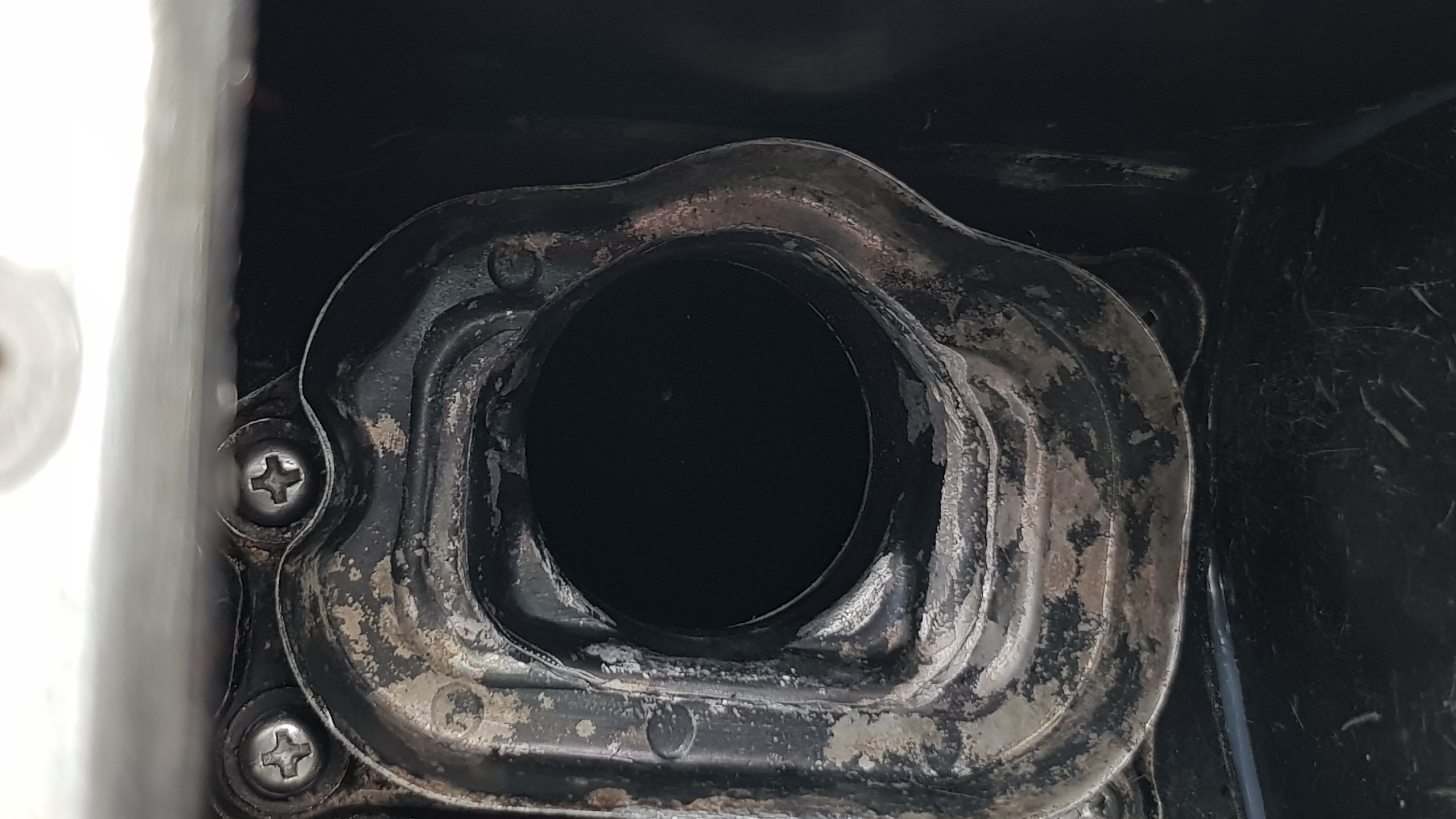

Carb is standard except for #37.5 pilot jet & #200 main jet. The base of the airbox has had the step at the bottom removed & the filter is now at the top like the modern design of airbox so it breathes quite a bit better. I did think the #200 would have been too big but so far it seems right, it was originally fitted when the motor was worn out & sucking air through the crankseals

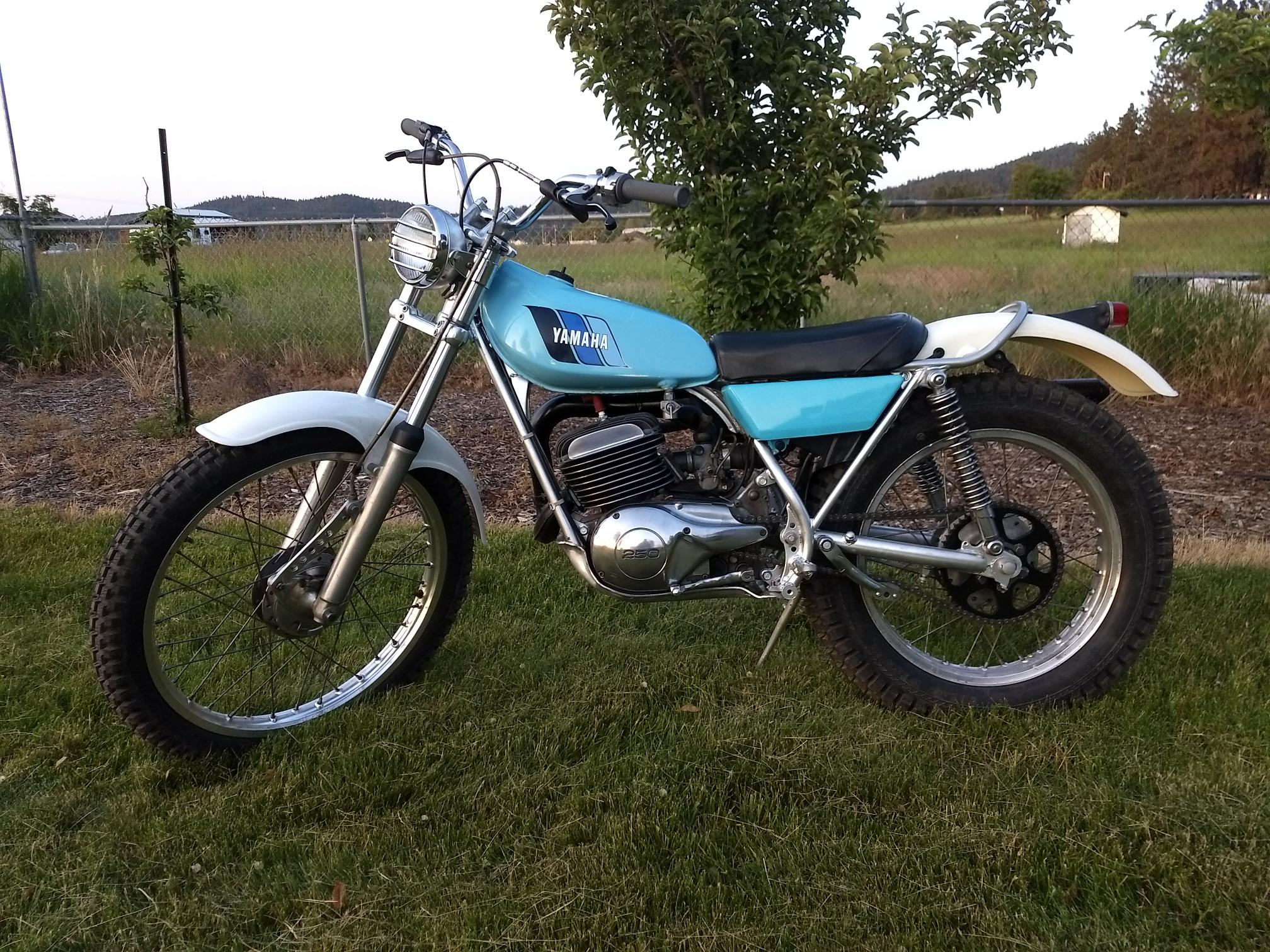

Here is my 76 175 that followed me home after an event... I just got the engine back together after sending the crank out for a new rod,mains etc and a fresh bore and piston. A friend  did a nice job on the tank and exhaust guard and I resprayed the frame. Lots of small bits to get it back to reliable running and I have about 2 hours break in so far. Loving the light weight and handling. P1010017.JPG.2f8dac6cd9653f9363565c865f590b99.JPG
