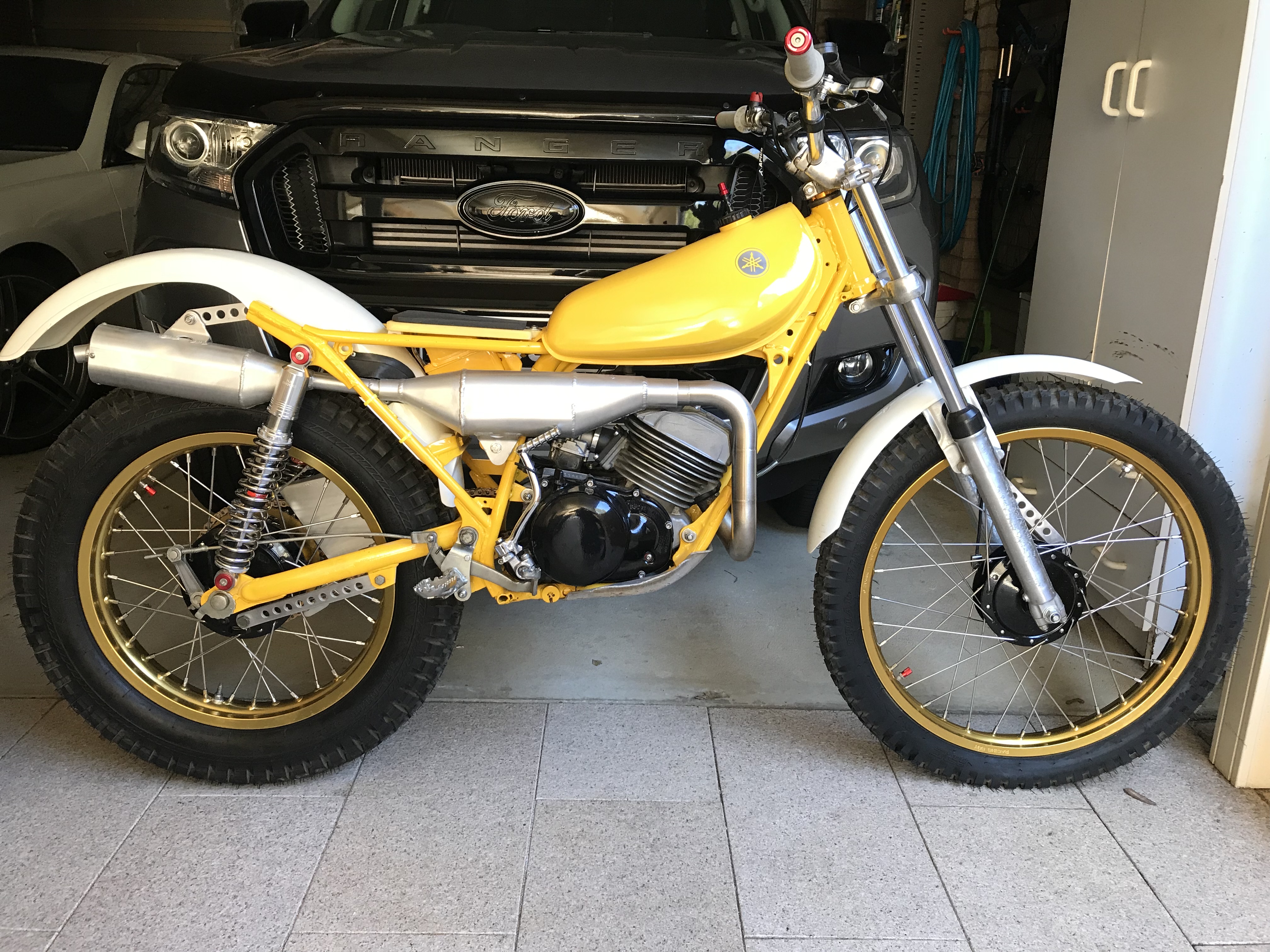

After doing a faithful restore of a UK spec 76 TY175, I had some parts left over....10 years later, another one is saved/created! It actually rides very nicely, OKO carb, Boyesen reeds, RD350 inlet rubber, WES exhaust system, Miller footrest kit, Marcus Rex ignition system, took as much off the flywheel as I dared, NJB Ultimate shocks. Finished now but I just loved the tinkering, even though it took so long!
Wow ! Very nice Rock...I like the yellow and all the bits you added. I didn't know the RD 350 inlet boot would work on the 175 so that will be a  good resource to look for. Did you use the stock air box and carb to airbox boot?
Sam

Hi Sam, the RD350 inlet is straight through rather than the "round the corner" standard item. I just had to remove a couple of rubber stubs that were in the way. I think the use of the WES system and OKO carb allow it to fit easily. I used the stock airbox but opened out the top cover as far as I could. The original boot wouldn't fit the OKO, so I had to improvise using a cut down rubber plumbing fitting at the OKO end and a length of that flexible aluminium auto intake pipe, actually turned out ok.
Cheers - Mark

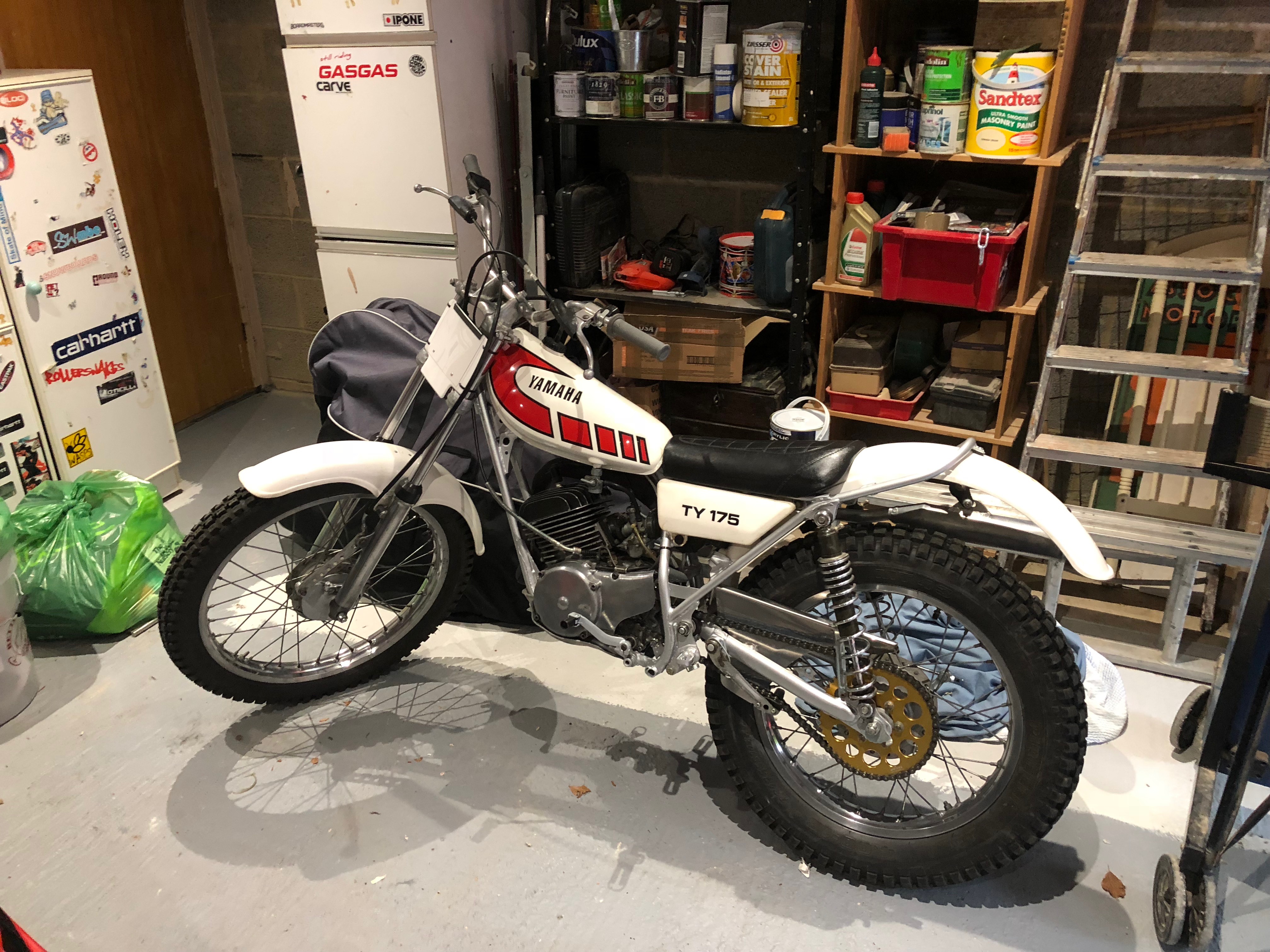

Here we go - my most recent acquisition and trying to keep as bog standard as possible. IMO buy a modern bike if you want modern bike 'stuff' (know some of them look terrific but I like them pretty much as they were). Rest of 'fleet' there too in the world's messiest garage. Z50 clearly my favourite.
I had a TY175 in about 1983 and it was my main means of transport back then but I then competed on it at the weekends. Nothing like carrying a petrol can in a backpack!
Think it's 1976 - about to get registered. I've cleaned it up a lot added a few new stock parts (or best replica versions).
First trial this Sunday (and I have literally not ridden it yet apart from on the drive at home). Could be interesting...
nb. having not had a 2T for a few years - mix for this 50:1? I bought Putoline TT Pro (Strawberry flavour which is pretty weird and not planning on drinking it) - will this do the trick?
Also, will it be OK on regular 95 unleaded or should I go for 98?
Thanks for any help!

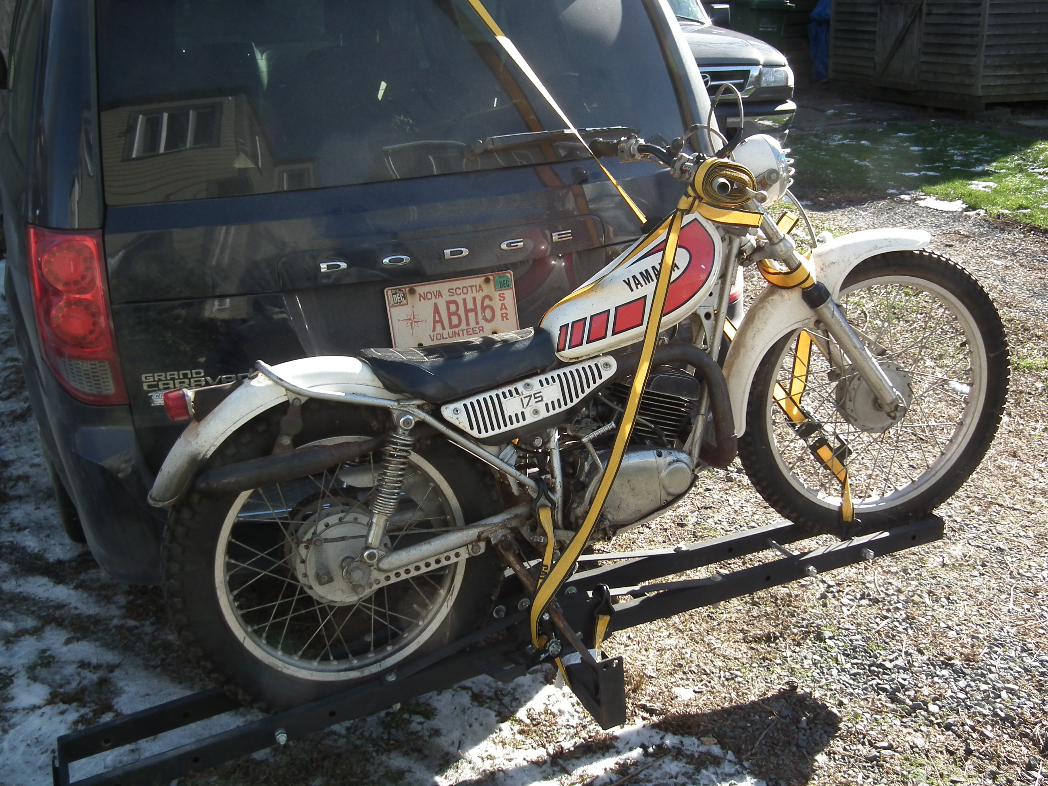

This is my first post here, and here is me bringing home my 1978 TY175. The adventure begins... :)

Bike came from Lunenburg County.

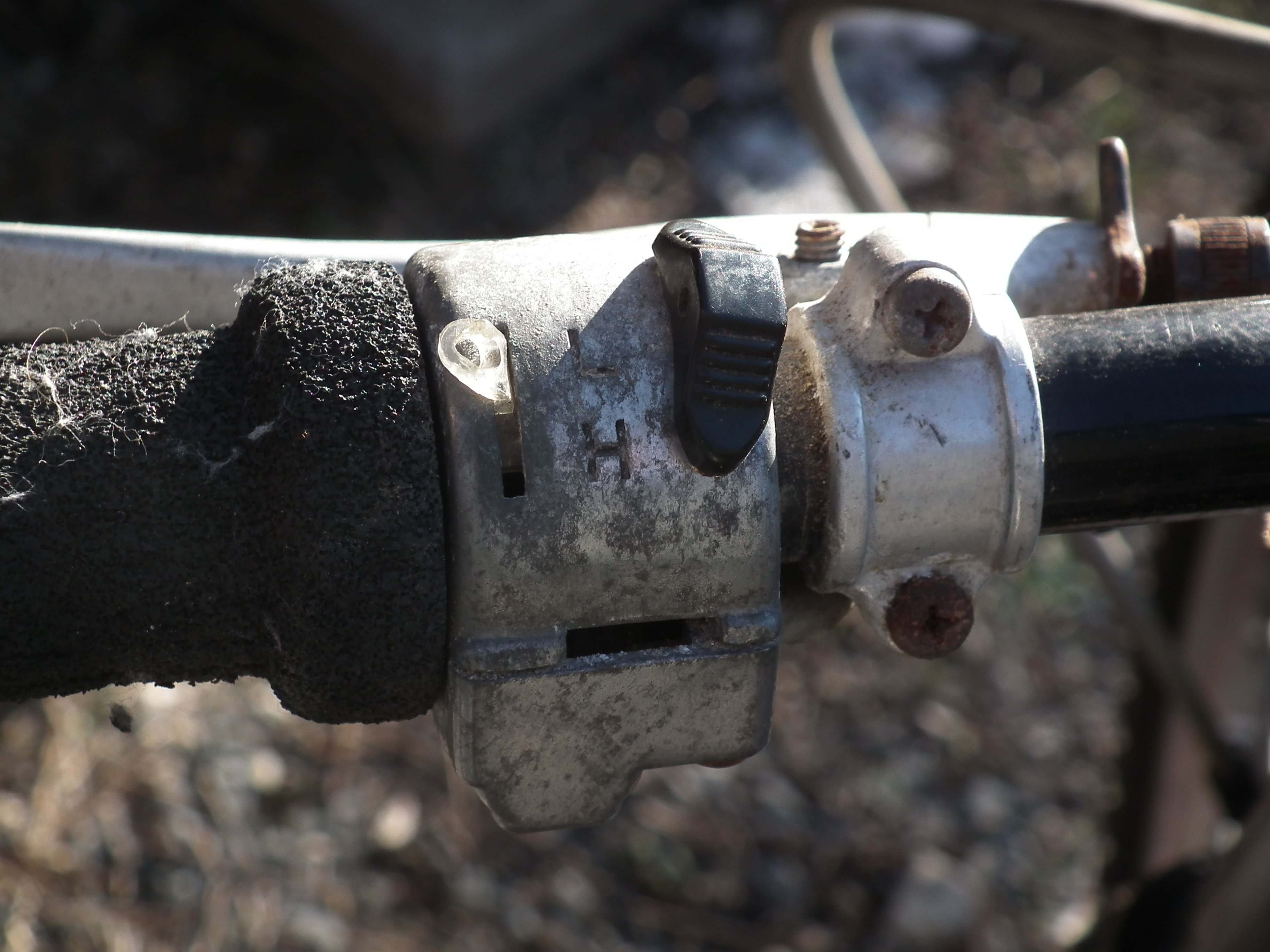

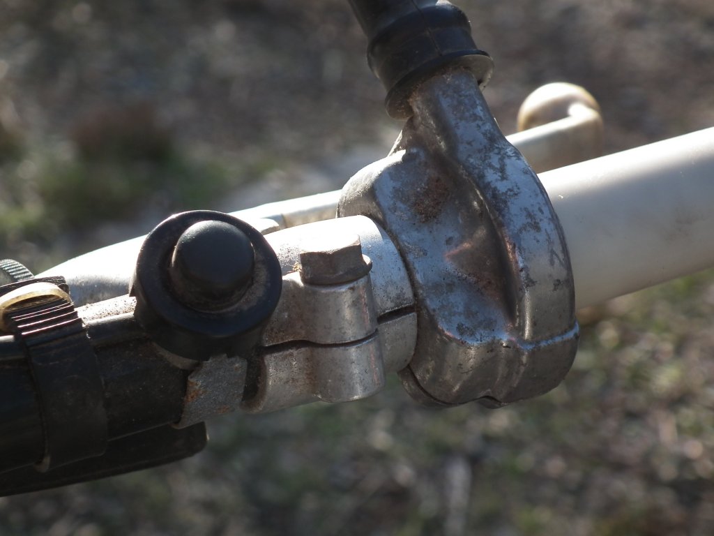

  • My switches are banged up, button broken. Haven't started, don't know if work

DSCF5032.thumb.JPG.681b8499d02c5c589498b60c5479f00e.JPGDSCF5033.thumb.JPG.9b806a9b8d6ae1d4e36008fe38feb968.JPG
Thanks for the tips! I'm getting under way...
