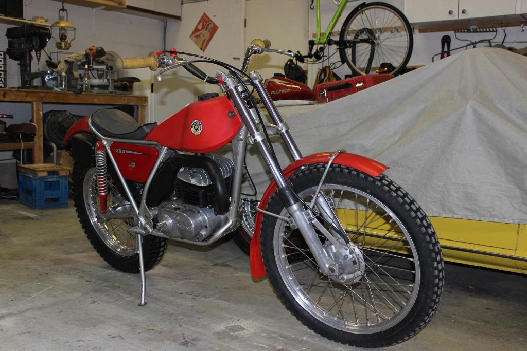

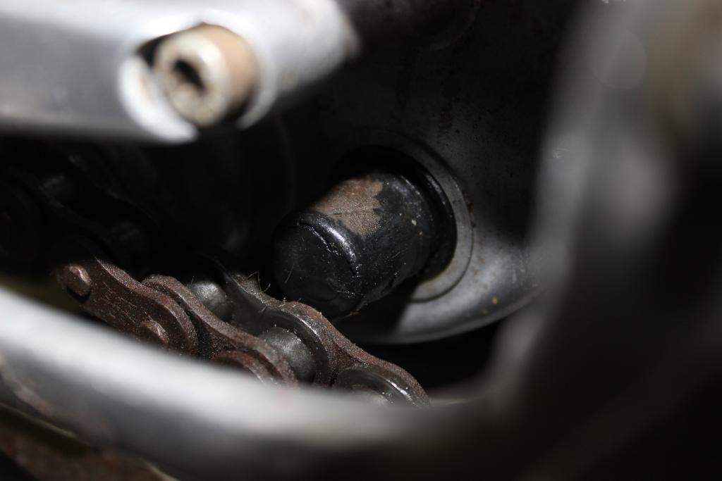

Is it possible to switch the gear shift with the rear brake on the 1976 183 model Sherpa. There is a boss coming out of the engine case on the ignition side which moves with the shifter but there are no splines. It looks like there is a plastic cover on the spline but I haven't investigated it yet.

Yes, you can change to l/h shift, if that's your preference - it's a through-shaft, and you should find splines under that cap (hopefully undamaged if the gear lever has always been on the other side).
You will need a different/cranked l/h. lever to clear the chain.

The cap you have on the shifter shaft is likely to break apart. I found that a piece of black fuel line over the well greased splined end gave a nice look and good protection. The caps are still available but as always, for a price. It might be an idea to get an old alloy lever and cut it to fit with a spot of weld & put it on the left side, vertically and see if you like it before you invest-Good Luck, it is a nice looking bike!
