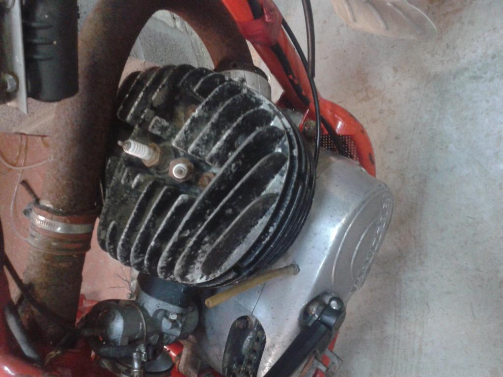

It has a twin spark plug head, a amal carb, little metal air box

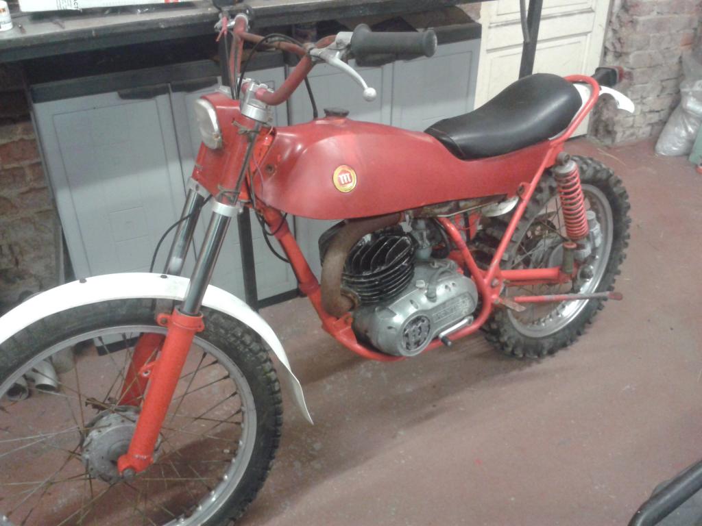

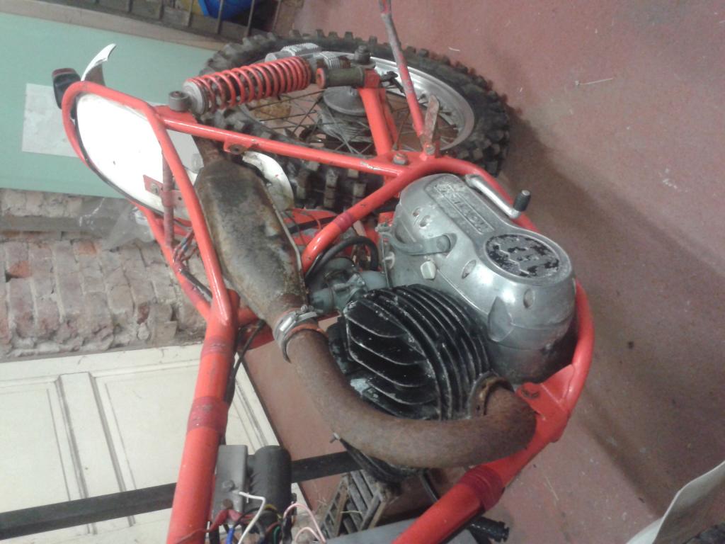

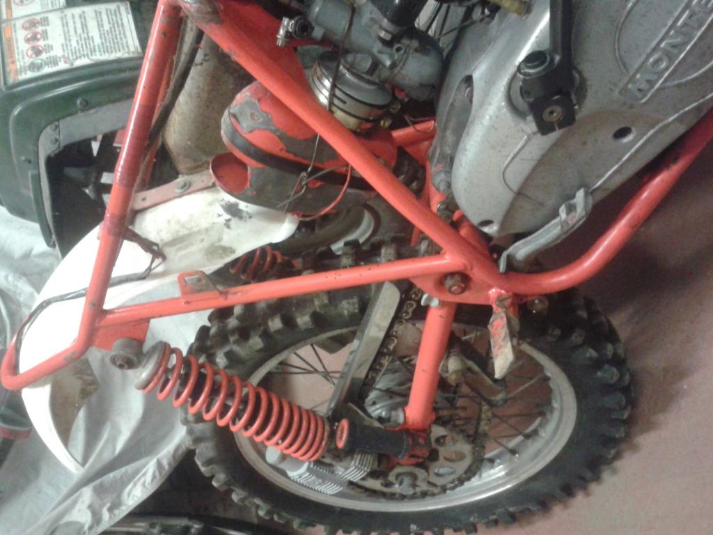

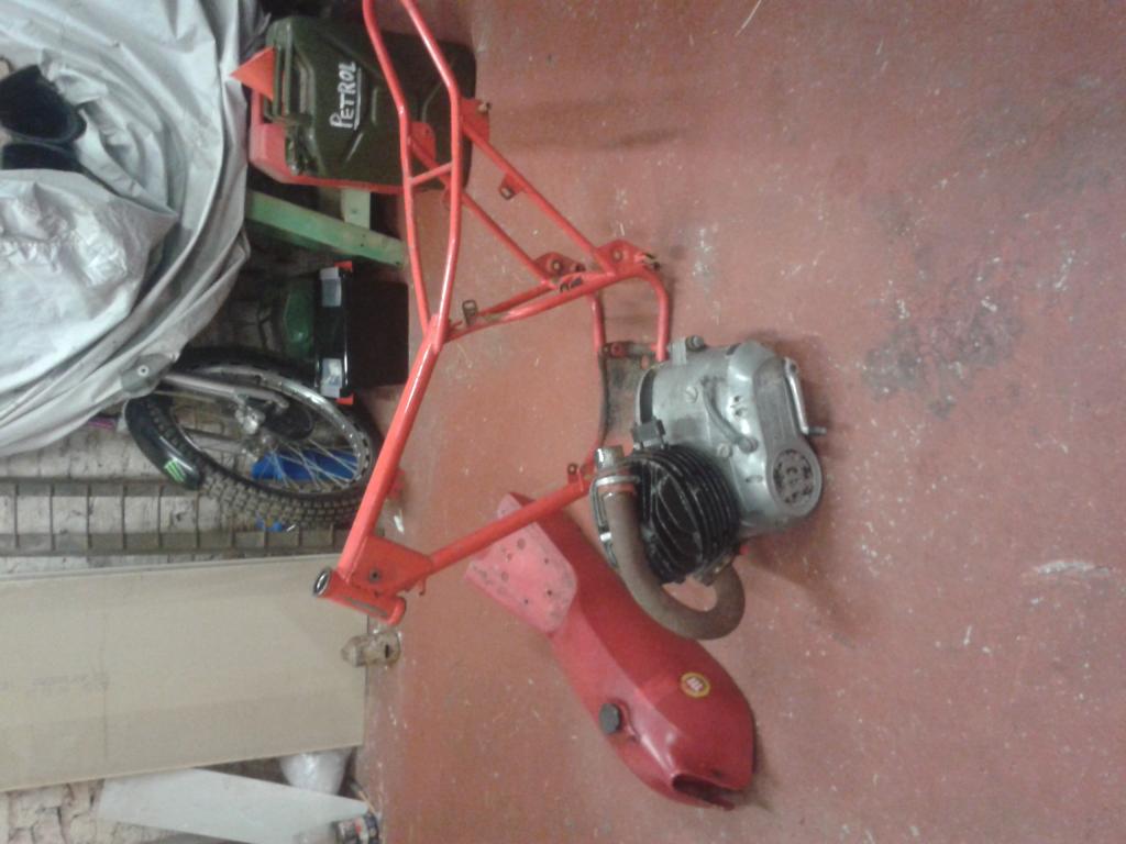

Here are some pictures, it needs some work and parts changing like the rear tyre for a start.
But I will strip it completely down, blast it and paint it!

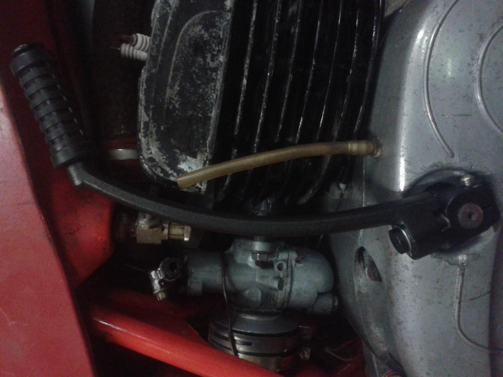

Looks like an Ulf Karlson 247 Cota, circa 75, but diff seat, headlight, shocks, stand & pillion pegs added. It may have been the "T" (trail) version. Eng # will be on top of the front engine mount. Frame # should be on stearing head somewhere. Be careful that the kickstarter isn't rotated too far forward (it looks like it is in 1 pic) as the stop will puncture the ign cover at the bottom of the stroke (if it hasn't already).
Looks complete. Good find. Great to see another one about to get some TLC
Although there are some components that do not match, it appears that you may have a 1977 or 1978 247 Cota. Compare yours to the Model Gallery on www.southwestmontesa.com

Took a picture of the kick start for you, it has no markings on it, only a very tiny "made in Japan" on the end of the foot rubber.
It does go forwards quite a way, so I will have to investigate that further, perhaps it needs fixing, so I will take it to work and weld it there!
