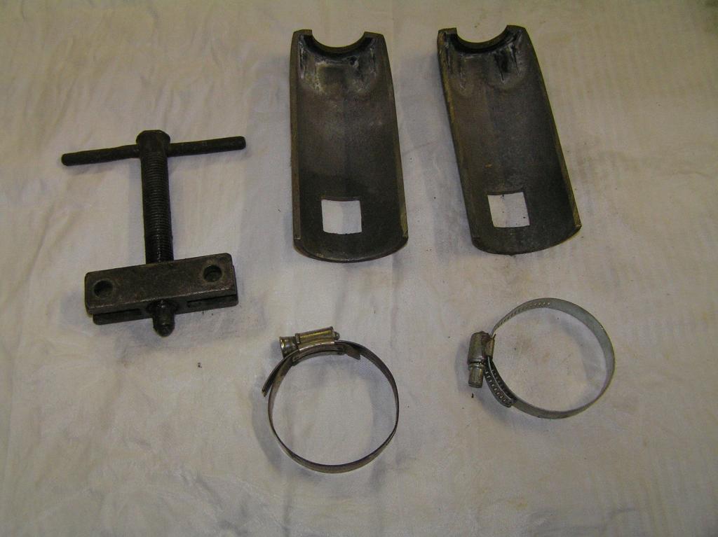

This homemade one works well and does not damage the edges of the gear teeth
Looks just the job but I'm not that clever . Going to try a bearing puller to get in behind it next

I've just got the same puller kit, which nits did you use to get the gear off with? 'Was it the silver straight gear ones or the black bearing ones? As I can't get the latter to fit around the gear?
Cheers
Sorry, my link didn't work. The gear puller looked like this.
