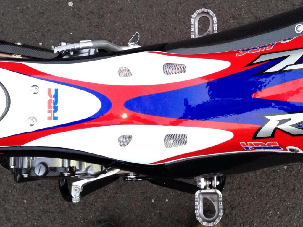

4 bits of mesh on mudguard to stop muck going into air box

Where you fitting the 4 bits of mesh? Just bought a 4rt really enjoying it but the air filter gets stinking every ride, half a ton of mud around it when I remove the rear guard , it's a 16 and there's a plastic piece under the rear guard does anybody tape this area up? or is the muck entering from the front do you think? Thanks
This is what I do, you can spray it (body filler alloy mess, halfords) black if you prefer. Cut it slightly bigger than the holes, mold it to the shape underneath and use electrical tape around the edges. Very cheap and neat and stops all the crap getting to the air filter.
