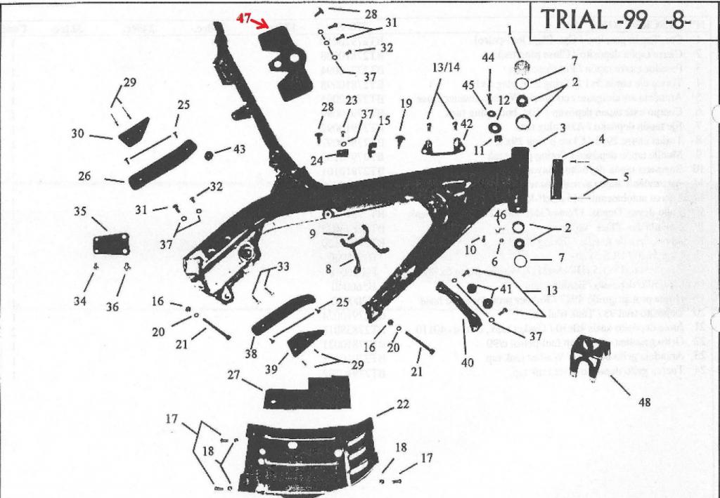

Where on the bike is the tank top rubber(part 47 on the drawing)placed?
Between the rear fender and frame?
Im not totally sure but itsnt that a thin rubber or flap, which lays on top of the frame/shock assembly?
Do you have a part number?

Yes i do  :thumbup: The Part number for tank top rubber is: BT27836024. This is for a 1998-99 Gasd Gas TXT 320
Thanks for helping me out whit this  :thumbup:
The program I have at home only goes to 2000, which does not have that anymore. (the editions have no back frame anymore).
My guess is on top of the shock mounting underneath the tank and seat.
Thanks crazybond007 i will check to see if the tank top rubber fit there  :thumbup:
Edited by thesaint
one of the holes in the rubber should line up with the mudguard mounting holes, i glued mine in place otherwise it falls off if you remove the tank and mudguard together
