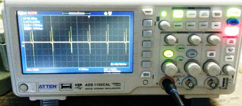

Sounds like you've done a pretty thorough job checking every thing including the eliminating the back angle sensor and ignition coil.
Using a test lamp to check voltage going to the coil may not prove anything (you'd have to try your lamp on a working bike). The attached image shows how short those pulses are (that's measuring the coil terminals on my 4RT idling).
Assuming no wiring faults I think it's starting to point to a crook ECU/throttle body or faulty condenser. Any chance you could borrow such items to substitute?
