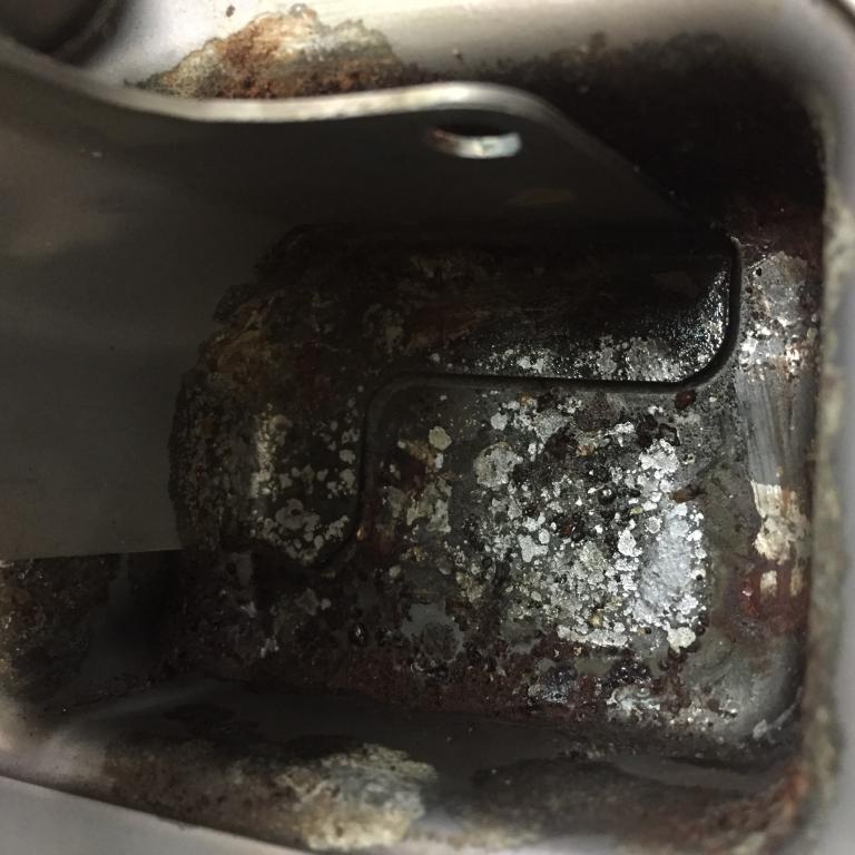

So I pulled the pump out today and found that the filter was basically plugged, the and#39;tea bag' filter on the pump was filthy and the sump that the pump sits in was rusty!!!  Pulled the pump out before I bothered to try and volume test it.  post-13996-0-68768300-1479773869_thumb.jpg
Tomorrow I will call my dealer and see about sourcing a new filter and figure out the best product to coat the fuel sump so the rust will not continue to be an issue.  Caswells is the only one that I know of, any other ideas?
Has anyone seen a rust issue like this?  I noticed on the new models they have changed this to plastic.....?
I'm sure you could test some scrap domestic plastic for petrol resistance then just put a bit in the depression, held in place by the teabag, to prevent rust being drawn in to the pump.
Is it possible that the corrosion may be the result of bad fuel?  I know for a fact that the PO used regular fuel in the bike, most of which would be ethanol blended here now.  I always use ethanol free premium.  I'm worried that if I don't seal up the sump that it will continue to corrode even if I put a poly liner of some sort under the pump intake.
