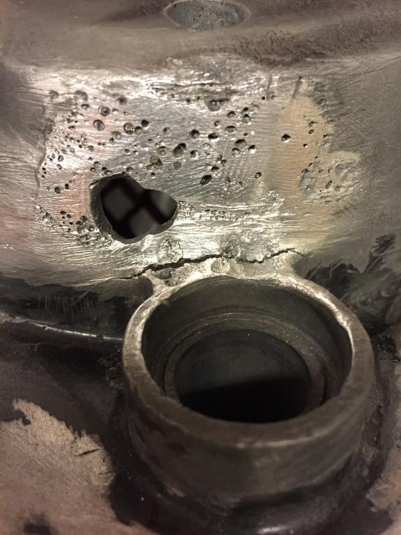

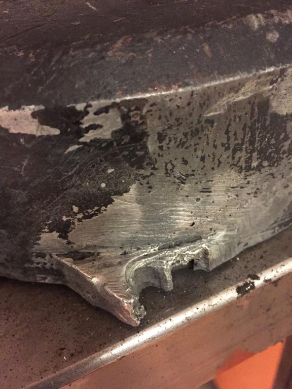

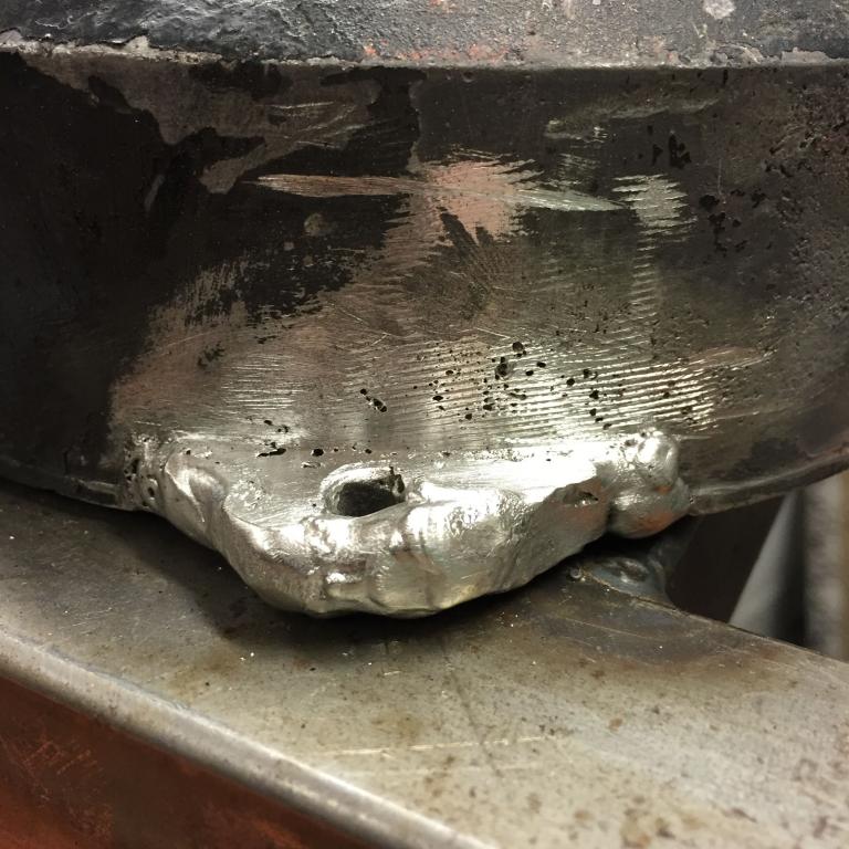

Here are a couple of photos, before and some stages later. The main problem is cleaning, in my case even more so as the parts had been (badly) welded in the past, as can be seen from all the pores. I could have taken all those away by grinding, but I was afraid of warpage and post welding cracks and decided to leave it and repair the worst holes, broken lugs and cracks instead. Before welding, I used an industrial ultrasonic parts cleaner and lots of acetone. Then grinding, almost like your dentist, to clean all surfaces to be welded, from cracks to pores. Took some time.
Before welding I pre-heat the parts for about 1 hr in an ordinary kitchen owen at 200 deg C. After welding I put the parts back for 1 hr in 250 deg C and then for 10-12 hrs in 200 deg C. Finally, slowly cooling off in room temperature.
The welding job itself is rather like TIG-welding anything aluminium. The settings I used are the same as for cast Al of the same thickness, in this case 110A, 70% negative balance, 110 Hz, square wave. Shielding gas is Ar and the TIG-welder is a German EWM inverter with foot control and an air cooled torch. The (sharp pointed) tungsten is grey coded and the rod contents are minimum 90%Mg, 0,1%Si, 0,7%Zn and the rest Al. If the preparations are right, it is almost like welding Al. If not, there is a lot of splatter and smoke. When that occur (and it does), it is just a matter of starting all over with grinding and stainless brushes, then another pre-heating and so on.
These photos show the parts after a first degreasing and brushing, then after the first stages of welding and rough grinding, but before final machine work and final filling/detail welding. If I had aimed for a perfect look, there would have been much more pre-grinding and more extensive welding before finishing, polishing and so on. However, in this case I have opted for function, not looks. Also, to show how relatively easy magnesium welding can be done with the right equipment and some patience.
post-9637-0-11212000-1444726913_thumb.jpgpost-9637-0-19525600-1444726966_thumb.jpgpost-9637-0-19481700-1444727000_thumb.jpgpost-9637-0-66762900-1444727041_thumb.jpg
