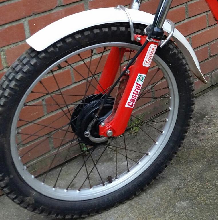

This is the brake plate on my seeley, it might give you a bit more idea as to what your looking for.

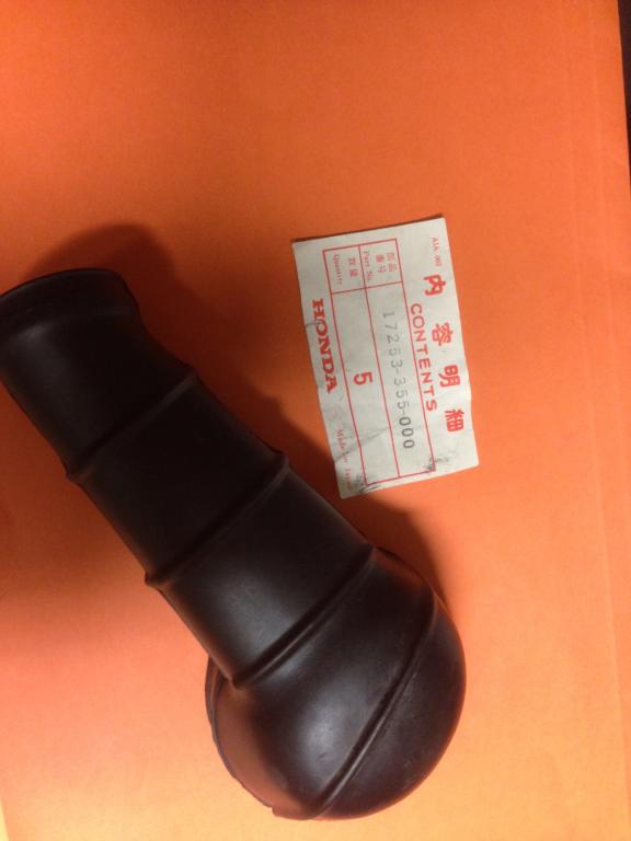

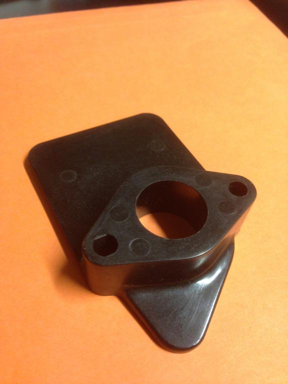

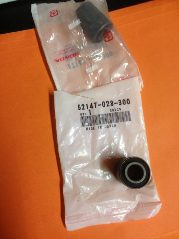

Hello
Please find some pictures that might help!
The first picture is the Carb to Air Box connector
The second picture are the swinging arm bushes
The 3rd the Manifold insulator ( no part number for that sorry)
The hubs are Elsinore CR125 not MT Elsinore which are very different. I'm prettty sure  the CR and TL250 share the same hubs back and front.
The front brake plate on the Seeley has the hideous looking torque arm because the Honda forks had a lug to fit into the slot to anchor it. The Seeley forks are Marzocchi, the same as Fantic 200, so need a torque arm.  As far as I remember Seeley used the Honda spindle and I recall the spindle / spacer arrangement on mine was a real lash up to fit the Marzocchis. I think the forks had to be sleeved to take the smaller diameter spindle - but it was a few years ago I had one now.
On the rear, the brake plate is turned almost 180 degrees and anchored differently on the Seeley in comparison to its original fitment on the TL, to avoid a torque arm I guess, resulting in the crazy positioning of the brake arm

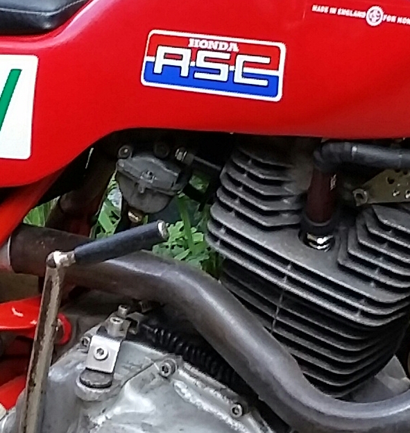

Seeley owners...I need an exhaust!  The picture is of the exhaust that came with the bike.  There is no mid-muffler and the "silencer" is a nicely hand-made piece, but the bike is much too loud.  I don't believe it's getting much, if any, back-pressure.  I have the resources to fabricate and fit different sized exhaust pieces together, but I would really appreciate any help from Seeley owners who have place an aftermarket exhaust on their bike.  The handful of aftermarket exhausts that were similar to OEM and available 10 years ago are not available anymore (to my findings).  I have read that someone fitted a WES silencer to a Seeley, but I need more information and details before I make any investments.  Any help would be much appreciated and picture are always good.  Thank you.
Edited by jimg
The Tlr and Seeley exhaust back boxes are mounted on opposite sides of the bike. Tlr left, Seeley right.
If you are going to fit a WES from a Tlr it will need to flipped from left to right.
It may be easier to modify a DEP system to fit. (and cheaper)
You can also fit a Tlr header pipe to match up with the DEP.
