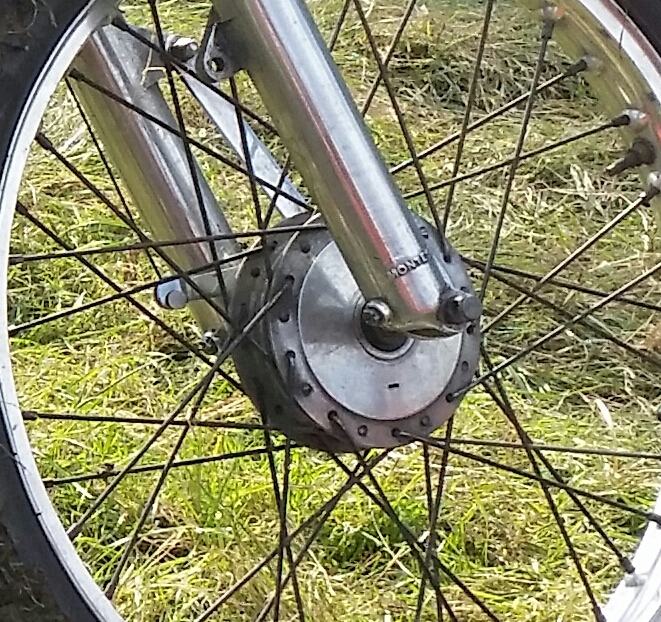

Am I right in thinking that if I undo the drain bolt near the bottom of the fork in the picture it should allow the oil to drain out?
I have undone both sides and nothing comes out. I guess this means there us no oil in them or is there some other reason nothing comes out?

If there was a lack of damping in the fork action before you tried draining the oil it would indicate there's none in there. Sometimes you have to pump the forks up and down after removing the drain screws to get it to come out. This has the combined bonus of leaving a line of oil across your garage floor.

Get the bike on a stand or box then take the front wheel out, undo the top nut on each leg - you will find just about an inch of compression on the spring inside so it won't be too forceful. Then undo the screw at the rear of the lower fork leg, put a container under the leg but covering the hole and push the leg up and down and this will pump the oil out into the container, when it is fully drained replace the screw and add 200 ml of 10 grade fork oil, recap an carry out same operation to other leg then replace front wheel. Take off of stand and pump the front suspension up and down until the damping action returns.

I drained the oil by pumping the forks as you all suggested.
It only had 100ml in the left hand leg and 75ml in the right hand leg. No obvious huge leaks on the seals so I guess somebody was playing with oil levels in the past. I have charged it with 200ml in each and it feels much firmer,
