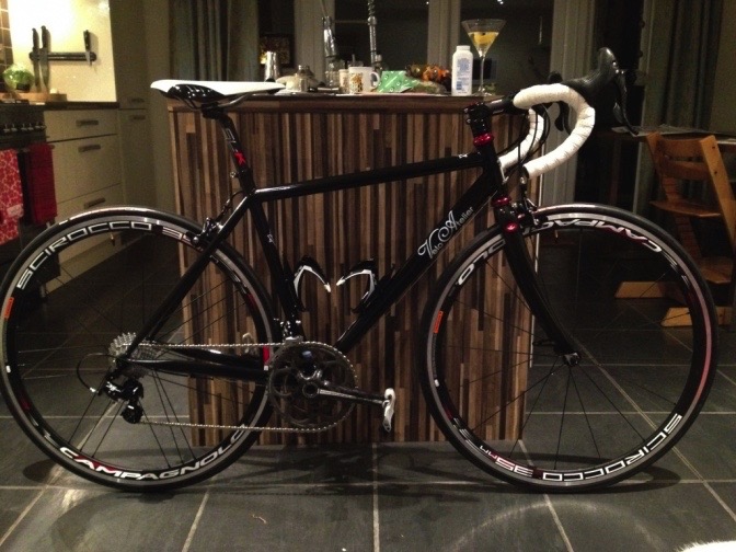

The bike below was built for his sister-in law. the present company logo on the down tube,
Happy New Year.
Charlie.
