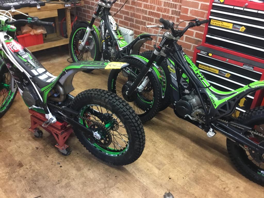

Well again!
Here's our garage!
So if it's a rubbish bike (Nigel

Ian, on the middle ossa in your pic, the one on the far right, do you have taller bars fitted? If so how do you find them?
Hi Canada, the 15 300 has std bars with 5mm risers, the White 300 has std bars, with 10 MM. Risers, I think ? I did try taller 6 inch jitsie bars but the bend was strange? Seem to come rearward somehow. Did not feel right. I like the std bars the best, the 13 bike has Sherco bars fitted, with 15mm riser. The very latest bike is very well built, and starts ace. Sounds and goes great as well. The white one was playing up on starting but changed aaa bsttery yesterday and all good now. The 13 has a ni mh large battery inside air box with switch on bars, fires up ecu and fuel pump with a right whirr! But then goes ok.
