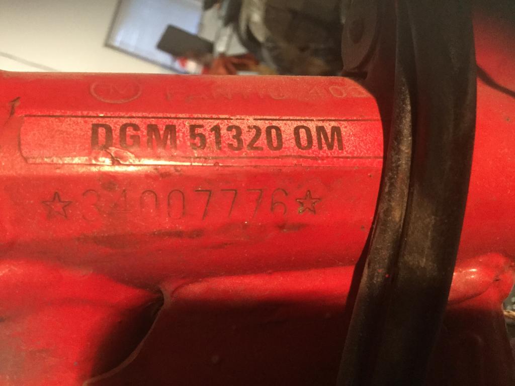

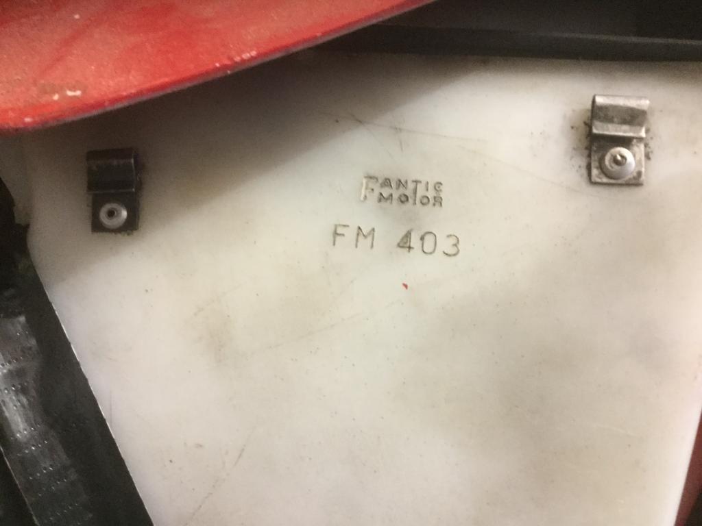

Just started working on fantic ,,,need specs,,year,,Manuel ..post-19829-0-66377000-1455641534_thumb.jpegpost-19829-0-33937900-1455641447_thumb.jpegpost-19829-0-51255100-1455641368_thumb.jpegpost-19829-0-45501500-1455572917_thumb.jpeg

Hi looks like a 301/241/201 to me 1986 era. I have a electronic copy of the  manual not in English but you can get the volumes from it let me know iy want me to send it to you.
Looks like a 301 in good usable condition.
