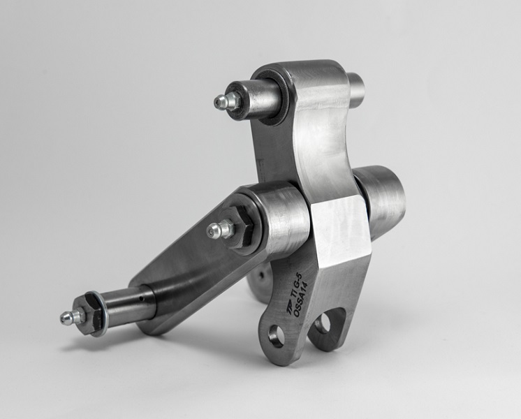

Available now...not cheap...but full titanium with needle rollers and zerk fittings

Just Googled with ossa suspension titanium... and found a titanium dog bone link kit for Ossa. It's not cheap but looks really nice and has lifetime warranty on link failure. Price is 680 AusD

Albeit expensive (445 EUR + shipping from OZ) it's looking good indeed. Lubable nipples are nice. So in theory you only have to replace the bores on the swingarm?
Edited by tsiklonaut

The stock setup will costs about 240 Euro; bushes in rocker included. The price for the titanium set isn't that bad when you have to replace the complete set...
And very friendly on maintenance; no need to take stuff apart.
