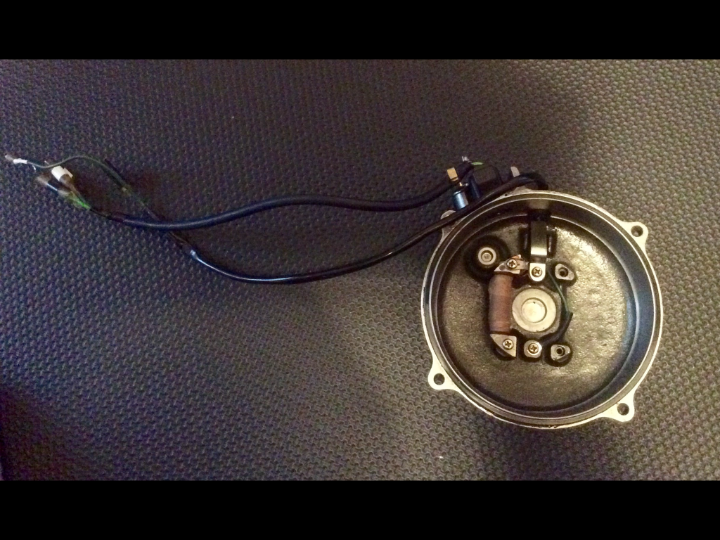

Here's another pic for you. Obviously mine is a jap import, so it's only got one coil.
Hi, this is not a problem to solve, you just add a coil and a voltage regulation (gasgas for my bike)
