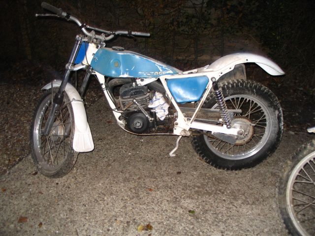

me too big john! dabster thats a discrace !!!!
and knowing how fastidious you are with your bike prep
i am shocked . restoration ??
Dabster, that thing looks like it was prepared by Anthony Rew...........anyone that has seen his bikes will know exactly what I mean :D

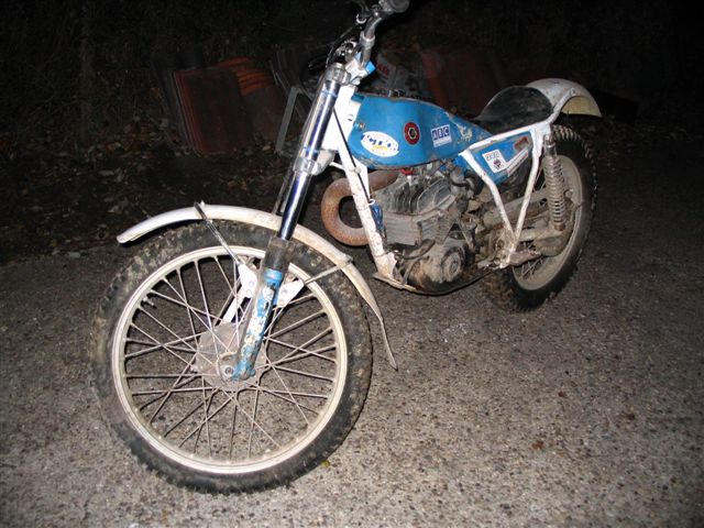

I have beaten myself with a prickly thorn and promised to give it a wash tonight.The one above is a vesty/reynolds copy I think this one is the standard Comerfords, swinging arms interchanged.
What are the differences between a Vesty/Reynolds replica, a standard comerfords bike and a 199B purchaced in the states? Can you tell anything by the s/n? How maney of each were produced?
Both have the late Ally head steadies which were a vast improvement on the old pressed steel things, easy to copy, triangulate from the head to the normal points on the frame and a simple bracket on the head, works well and think it stops the frames from bending aswell.
I would imagine there are very few (if any) comerfords replicas in the USA, unless copied over there Dave Renham might know otherwise.
I think the vesty/reynolds copy was one produced by someone up north possibly for JR. It is nicely done and is a bit more trick looking though the positions of the shocks are not that different and the advantages of one over the other are not great.
Comerfords replica I would guess around 100 the others very few.
