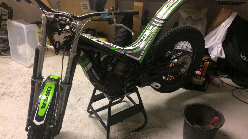

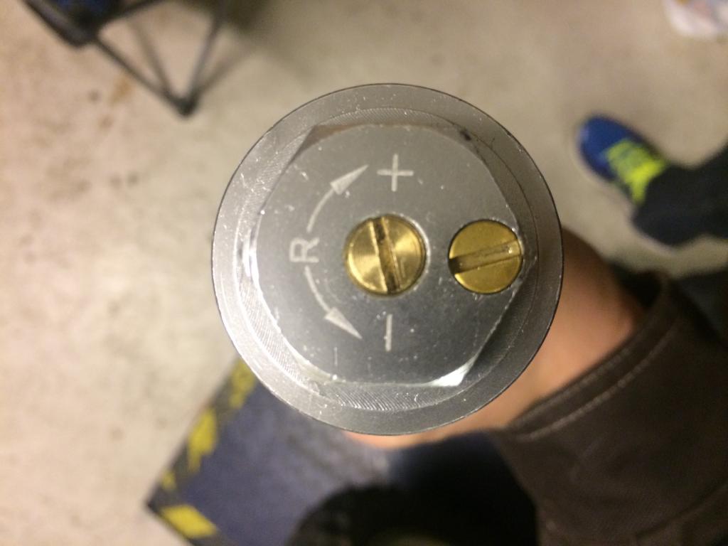

Pictures of the inside. Starting to think that the forks have been swapped??
It does look like someone added some extra holes at the lower tube (sanding marks on some but not all).  Only thing I can think to check is that you didn't get the rebound cap/rod on the compression leg; one leg is comp, one is rebound.

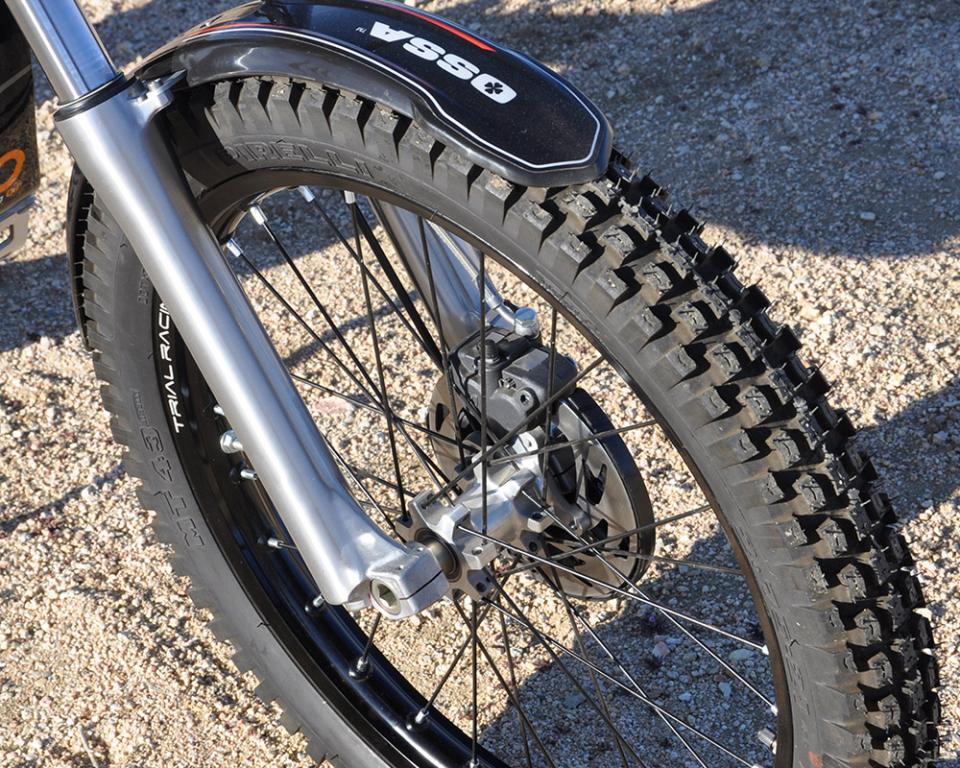

The more I read about it, the more it seems that the forks are as you say from an explorer. Found a picture of the Explorer fork to and I think we got the answer to all this confusion!!!
Edited by dares
Yes- certainly look like Explorer forks.
