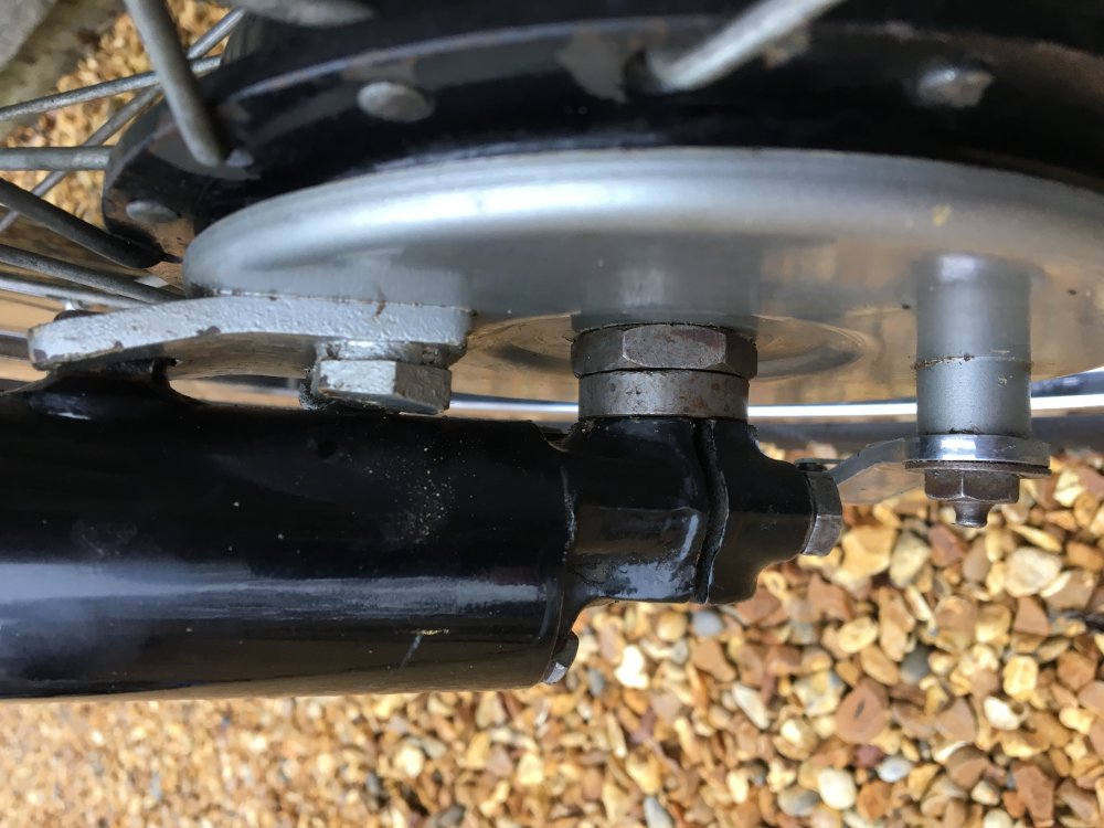

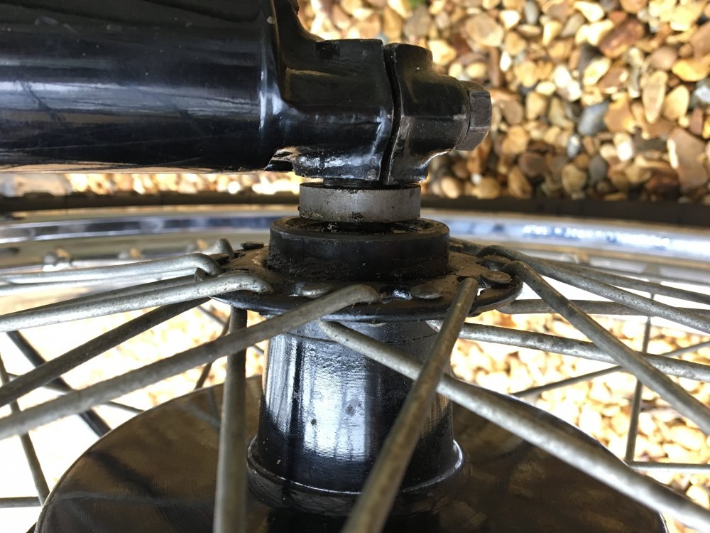

January 26, 20179 yr Hi I have a 1958 Cub with what I believe are the original hub, spindle, spacers into heavyweight forks. There is a gap that I'm questioning on the opposite side to the drum. Am I missing a spacer? Should the hub pull through further when I tighten the nut on the drum up? Or does it just have a gap!?
January 26, 20179 yr Yes mine had a gap, before you tighten the two nuts fully on bottom of legs, gently tighten them first, and then push forks up and down too center axle then tighten, if legs are pushed in and then tightened, forks wont work properly.

January 26, 20179 yr Author Thanks vinnied, I've had the wheel out, so I'll loosen off fork bottoms and check it's all sitting right as you suggest. I initially nipped them up whilst off the ground. Samwisemcg, I can only compare to fairly modern forks. The oldest being standard TY175. Obviously, compared to those they aren't all that. Lift the front wheel off the ground and they clunk, but they go up and down when you want them to. As I'm not wanting to take the bike too far from "stock pre 65" they will remain untouched. Edited January 26, 20179 yr by jonnyjibs Badly written initially!
