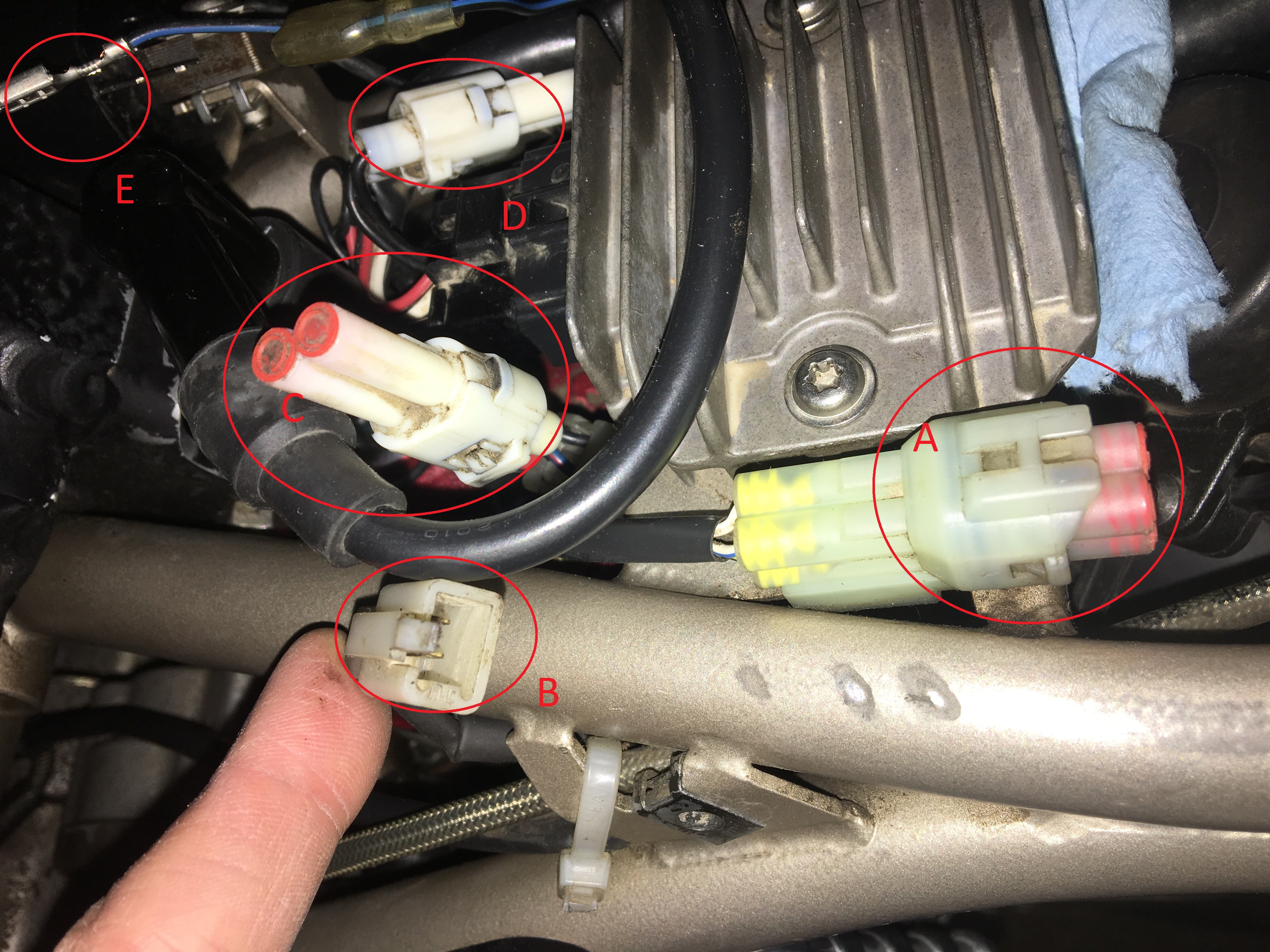

I’ve try to find where to plug the 4-pin female connection from the cable… but I only find as picture below.
Questions:
How can I connect the diagnostics cable?
Based on the attached "connections" picture... Should I connect the cable on “A” ?... if so do I need to remove the red cap?... and if so, how to remove it…I haven’t been able?
“B” comes from the rear brake ???, “C” comes from the harness ????. “D” goes to what seems a copper “something” on the cylinder-head-cover???.
“E” is the cable (blue) that I believe comes from the engine into the “Ignition Coil” that goes to the spark plug. Can it be tested with a volt-meter?

the software is pretty easy, yes- you plug I to 'A'.  It may or may not need an adapter (if I recall, the factory setup came with the old 4 pin connecors and the newer 6 pin connectors.
use Kscan. It has a testing section, where you can have it produce spark. Best bet is to pull the plug and connect, then III can see it, but you should be able to hear it even in place.
none is that hard, just need to take it one 'section' at a time.
i forgot- to take the cap off 'A' see the little slot near the letter you have? Push down on the plastic tab with a small screwdriver or something, then pull the cap out. I use a small pair of needle nose pliers to grab it.

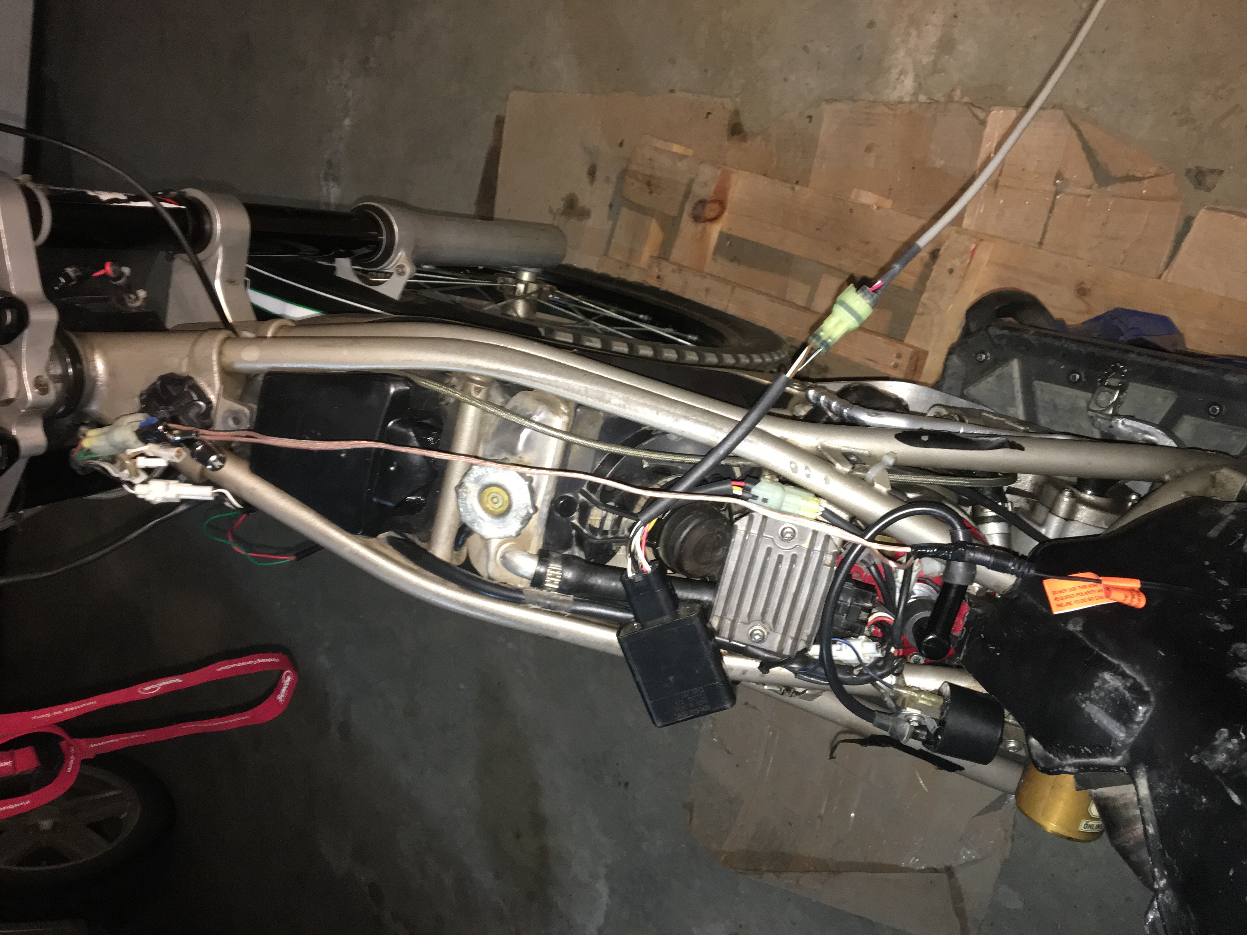

Use either a 12v car Barrera with croc clips, or us a 12v power supply like I do. You connect it to the connector behind the headstock, the side that goes to the wiring loom, not the black box
Hey Guys... thanks again !
Lotus - I was able to remove the red-cap "A"... what a bummer... but eh... it's off  :-)
Canada280i - I found where to connect the 12v supply (I think) - thanks a lot for that too.
Now, I'll need to find the 12v Supply, battery or I guess a regulator should work too, right?... what about polarity when connecting it to the harness?... either way works?

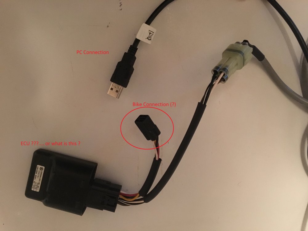

Then, I guess I connect the diagnostic-cable, power up the PC, start the KScan... and then ?
Finally, after spending literally hours looking for the crocodiles clamps and visiting 6 hardware stores... found them on the "Dollar-Store"... go figure eh?
See Picture Below
When I connect the power supply (adjustable voltage regulator, 12V and 1,200 amp) the "Fuel Pump" kicks in just for about 3 seconds, then shuts-off ????
At the other end on the PC, after I click on diagnosis and the ports windows comes up, an error messages comes that says "Cannot connect to ECU"  ???
What should I do here???
You are in the right direction as the fuel pump noise means the system is powered up. The cannot connect to Ecuador usually means the software is not seeing the right port. Auto setting should find it but I had a similar issue and ended up specifying a port, in my case port 5. If your laptop has multiple USB ports try different ones to see if the auto selection finds it, you will know when connected as a green box with OK in it will appear on screen instead of the red one. You may have to recharge the system a couple of times by disconnecting the power and reconnecting for the software to connect to the ecu. Good luck, keep us posted, it is very interesting and fun when working
I seem to recall when I used the factory setup it had a serial connection? . Does yours have that, perhaps with   serial to USB?
i have a BTWICE one now and no ready access to the old factory setup.
Edited by lotus54
my cables are original factory serial port type but I just added a serial to USB connector, setting the port was always the biggest issue I seem to recall
Yes, my cable is a Serial-Cable, then it has an adapter from serial-to-SUB.
Q - so does the pump should make noise and then shuts-off?  or should stay on all the time?... mine shuts-off after 3 seconds...
shouold shut off after 3 seconds. if you unplug the power and then re-plug it will make the noise again. Occasionally I have to do this a couple of times to get my software to see the ECU
