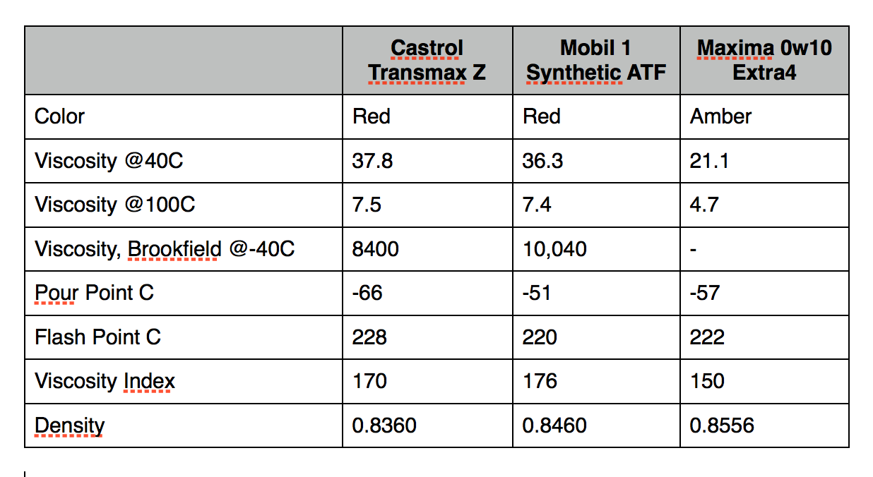

heffergm Posted March 9, 2017 Author Report Share Posted March 9, 2017 Of the synthetic ATF brands I could find spec sheets for, only Mobil 1 had basically the same numbers as the Castrol. I have no idea how (or if) the maxima compares, haven't looked to see if they publish a spec sheet yet. Link to comment Share on other sites More sharing options...

heffergm Posted March 9, 2017 Author Report Share Posted March 9, 2017 (edited) 8 hours ago, billyt said: Because they sell Maxima...... I'm sure they do, but they likely carry all kinds of other oil. But they mentioned it was 'recommended'. By whom I have no idea. Based on the numbers, I'm more inclined to run M1 simply because the viscosity numbers are closer to the Castrol recommended in the manual, and the fact that any additive package in the M1 is going to be more similar to the Castrol, being that they're both ATF. Edited March 9, 2017 by heffergm Link to comment Share on other sites More sharing options...

billyt Posted March 9, 2017 Report Share Posted March 9, 2017 4 hours ago, heffergm said: I'm sure they do, but they likely carry all kinds of other oil. But they mentioned it was 'recommended'. By whom I have no idea. Based on the numbers, I'm more inclined to run M1 simply because the viscosity numbers are closer to the Castrol recommended in the manual, and the fact that any additive package in the M1 is going to be more similar to the Castrol, being that they're both ATF. I actually asked the same question of LS of why Maxima 0-10W ? I would agree the Mobil 1 ATF is a good substitute. Link to comment Share on other sites More sharing options...

heffergm Posted March 9, 2017 Author Report Share Posted March 9, 2017 (edited) Yeah, none of those are Transmax Z though I've looked at the spec sheets of almost all those that seem relevant (Dexron III stuff), and the M1 is still a closer match on all the published numbers. Edited March 9, 2017 by heffergm Link to comment Share on other sites More sharing options...
