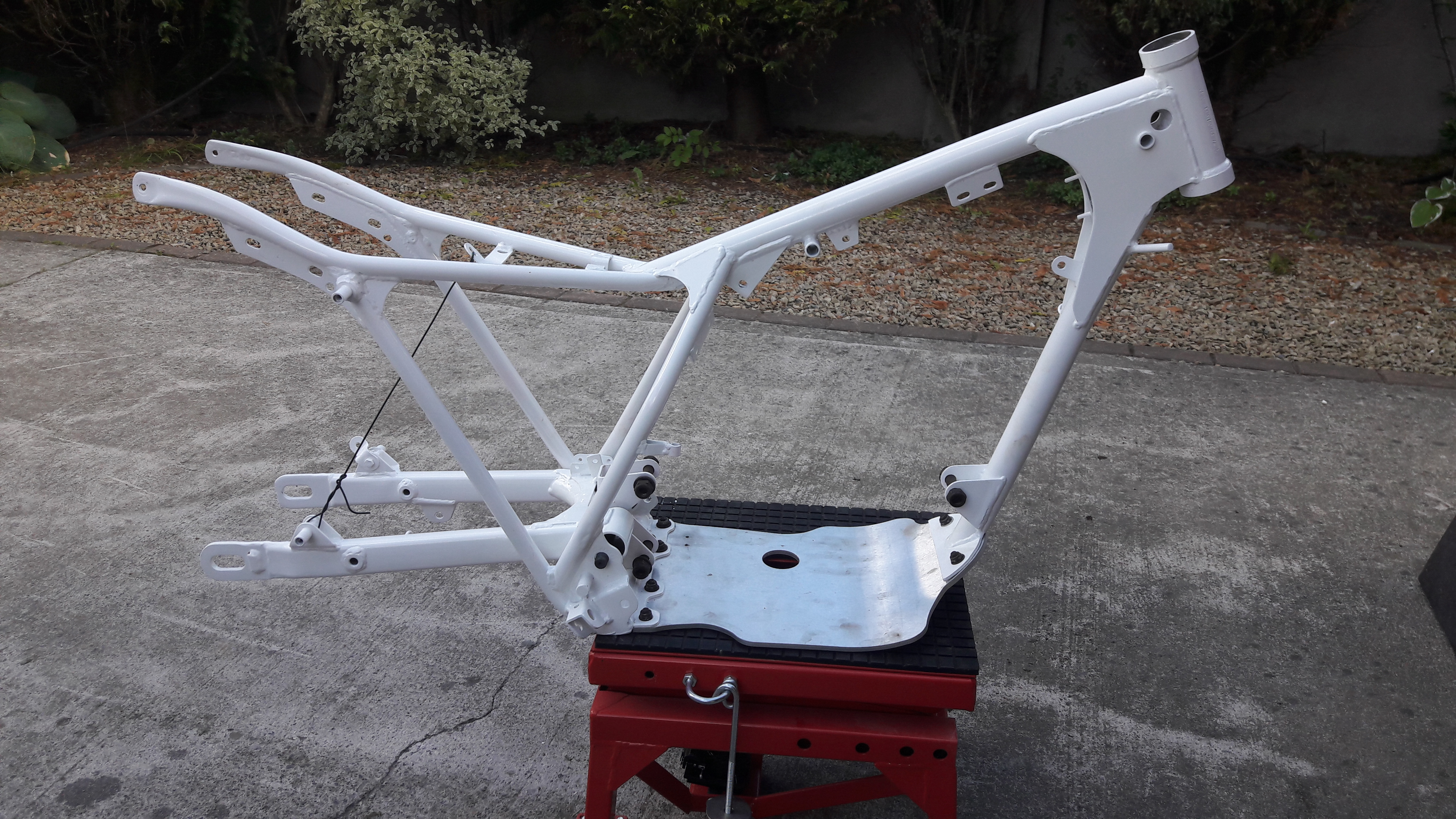

Well after a number of false starts, I finally got the frame away to the powder coaters, collected it today and I'm delighted with the finish.
Of course as soon as I got it home I couldn't resist fitting the bash plate that I got from Todotrial. Which fitted perfectly and offers way more protection than the original.
Next on the list will be swinging arm bushes and a new airbox.
