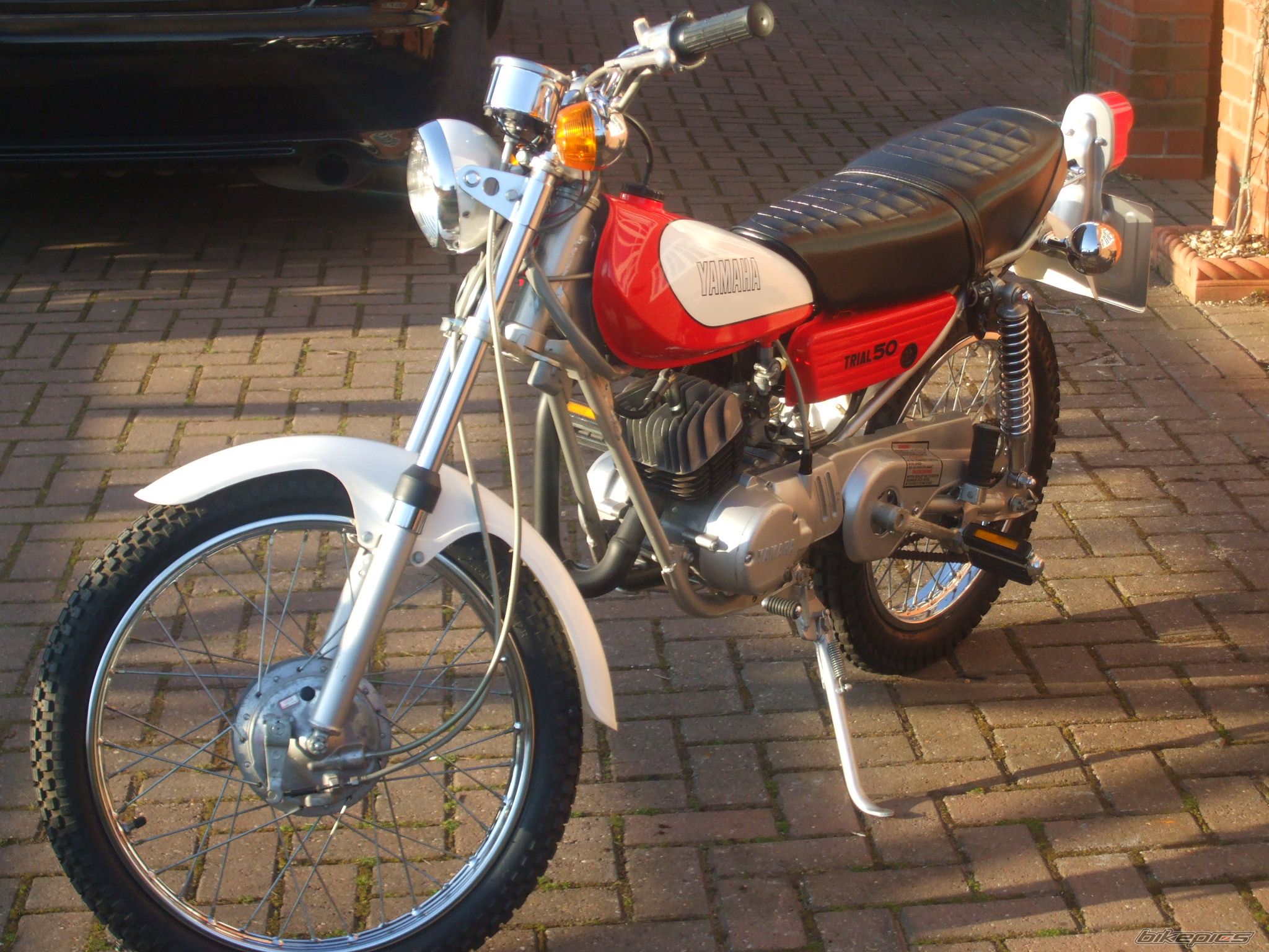

I think the only one that my have had steel rims was the TY50
