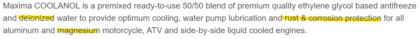

Wanted to revive an old thread. The biggest benefit I see to Evans is the fact that it's waterless and should help resist corrosion for those of us with magnesium engine cases. However, once you factor in the Prep Fluid you're spending about $70 for the Evans Package. I also don't love the super high boiling point.
I'm also considering Maxima Coolanol. They claim to use deionized water and that it's safe for magnesium cases. It's also less than $20!
What are the thoughts from the group?

I take it you don't trust their claims. Not really surprising I suppose in a world of lies/liars. Its made in the usa by an american company so its got be your first choice really. Regards Alan
