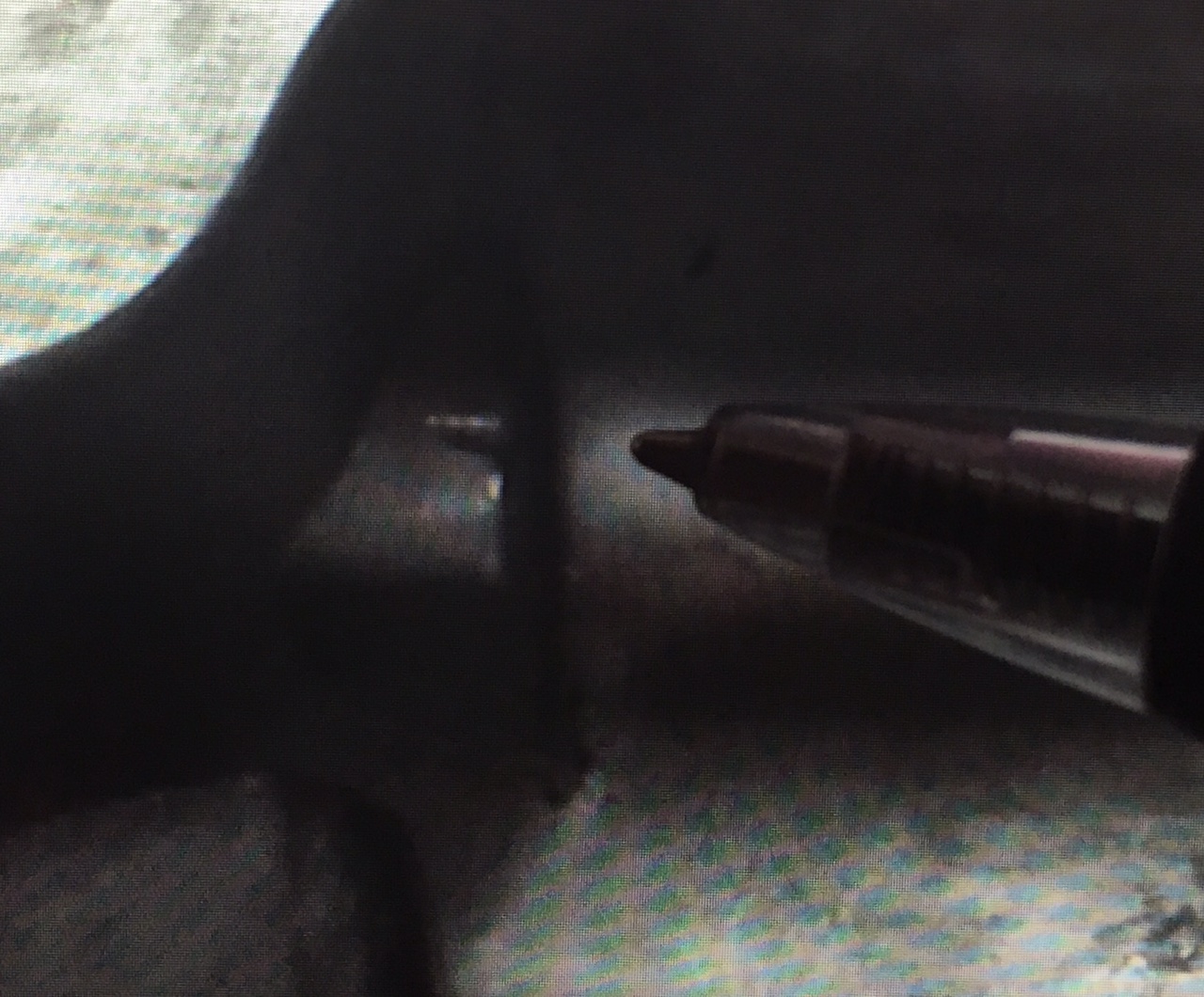

In looking in more detail at your float bowl. Specifically the part where my pen is pointing to the marks/gouge is witness mark that at some point in time there was an issue with the pin that holds the brass tangs to the float carb body.  This heavy gouge mark means that the pin was not in securely when the carb was placed back on the float bowl.  After working with this carb for many many years I had seen one of these gouges before where it put a hair line crack in one of the posts and caused all sorts of flooding issues.
The pin can and will float about from left to right however this is not on the side but rather a mark that has been forced into the top due to poor fitment.
Can you get  take a better more detailed picture of this area on the float bowl?
Hello feetup my cab does not have an overflow standpipe. It is exactly as dan described, it is built into the castings of the carb body and float bowl.
Interesting point billyt about the mark in the float bowl. I completely missed that, well spotted. The pin has always been in place when I have taken the carb apart many times, but as you say it there has clearly been some kind of problem in the past. I will take a better photo of this, it will probably be not for a couple of days.

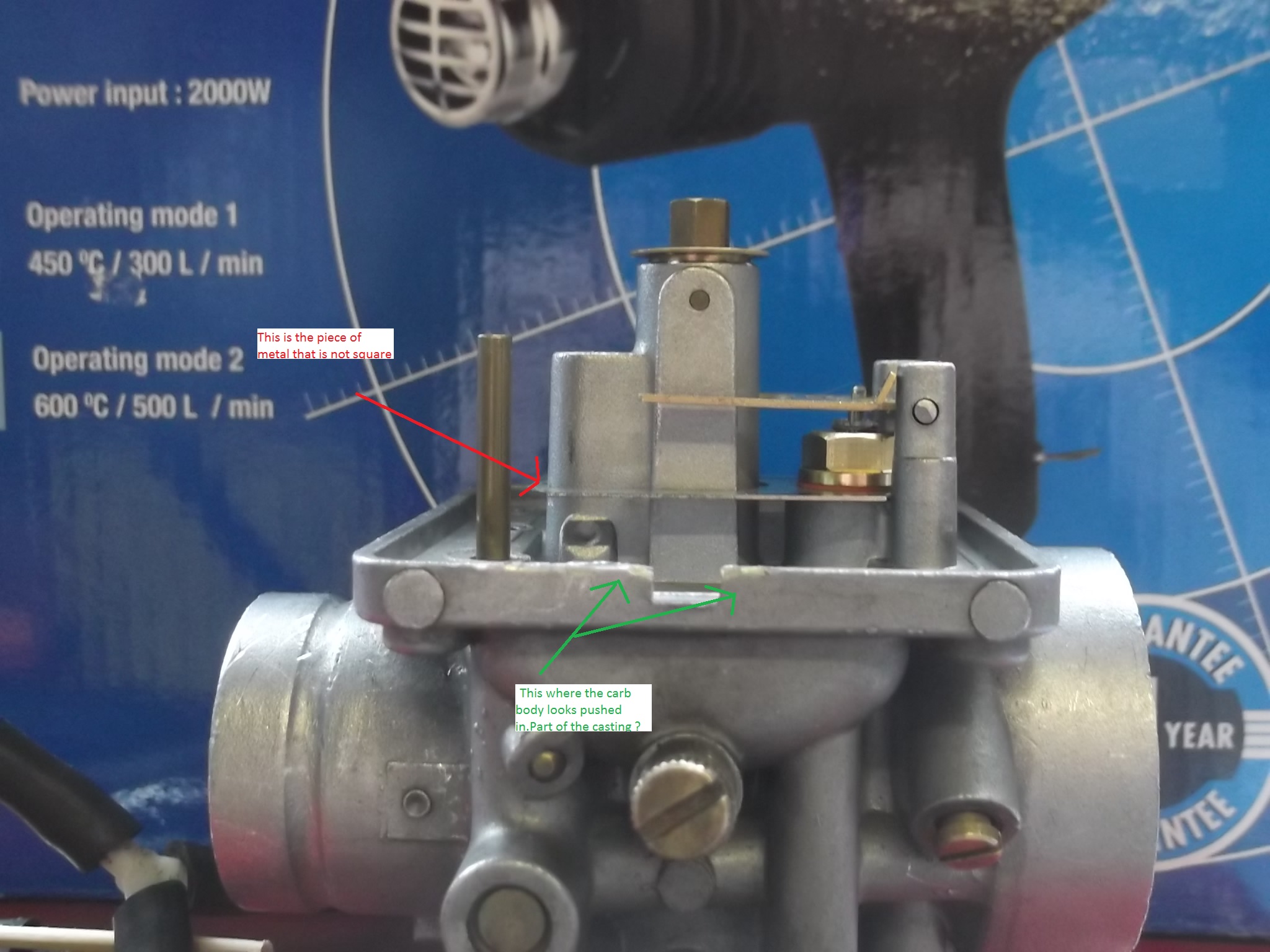

So I had some time yesterday so was messing around with the bike, I remember people mentioning about the floats catching on the gasket. So I had a look and noticed two things. Firstly the gasket did sick out one side a tiny amount we are talking 0.5-1mm.  So I carefully trimmed this down but it made no difference. Secondly the casting of the carb where the gasket sits was not square. I will again take a picture of it. It may just be how they are all made, I don’t know? To describe where it is - there is a cut out where the gasket has a tab on that locates into the carb. It looks a bit like someone has hit it with a hammer. By that I mean that it is punched in a tiny bit, there are no signs of damage. As I say I will take a picture of it.
The other thing I was thinking about that you guys mentioned is the whole vibration thing. Specifically about the carb hitting the exhaust.  So I removed the silencer and the middle section and ran the bike but this did not make any difference. The fuel lines on the bike do touch the cylinder wall and a bit of the exhaust. I was wondering if they are a bit old and have gone hard could this be enough to disturbed the carb? I should say that I have ran the bike with one hand on the carb to see if that stabilizes it or if in some way that dampens the carb, but again it made no difference.
I have a question about a flat piece of metal in the carb that the needle seat bolts through. What is its function and can I remove it. The reason I ask is that I have noticed that it does not sit squarely in the carb. I could take it out completely or I could try and file it down to make it sit squarely. Again I will take a photo of this.

This is not a new picture but show a couple of the things I mentioned. I will be taking better photos when I can tale the carb of in a couple of days time,
