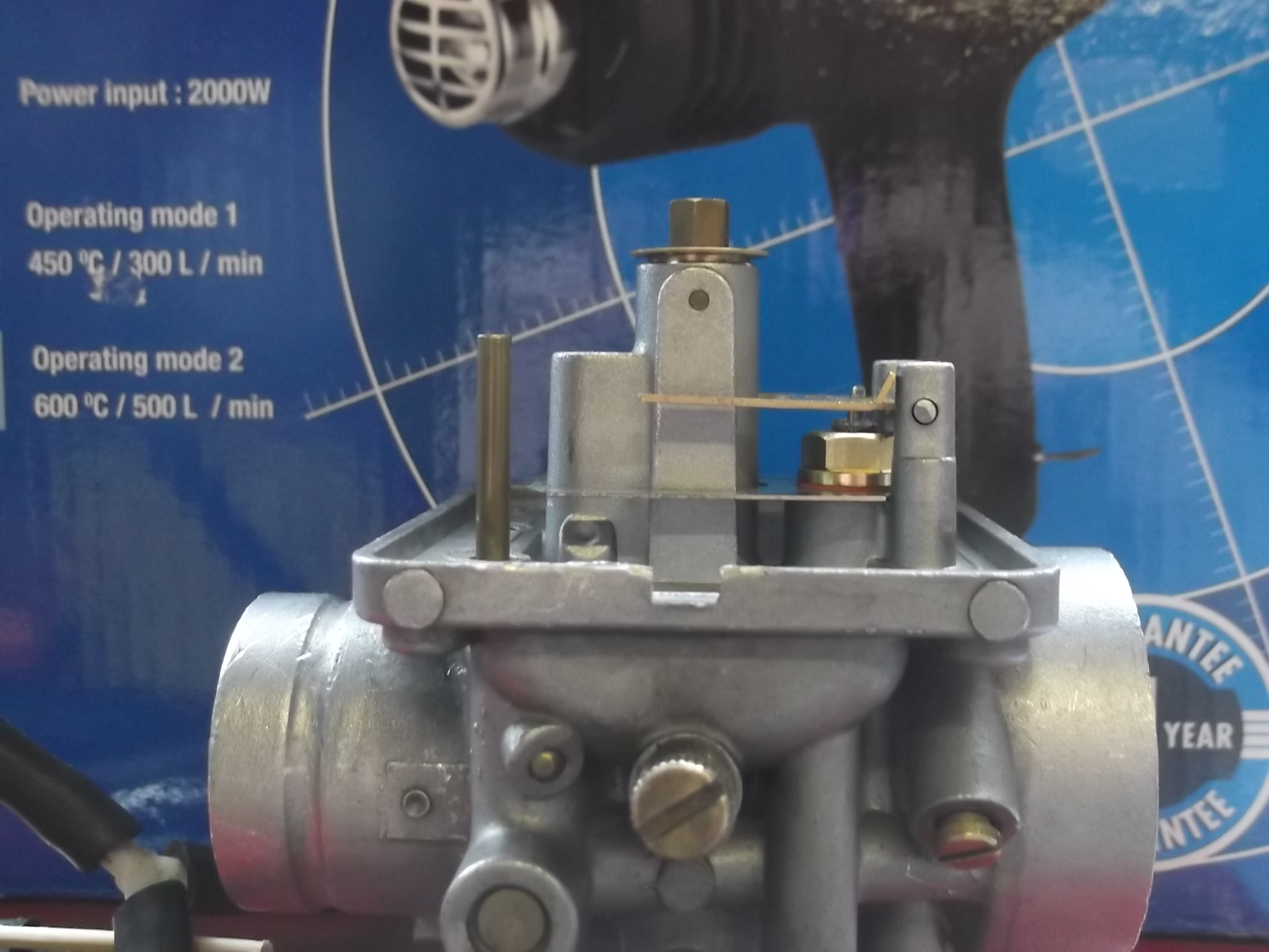

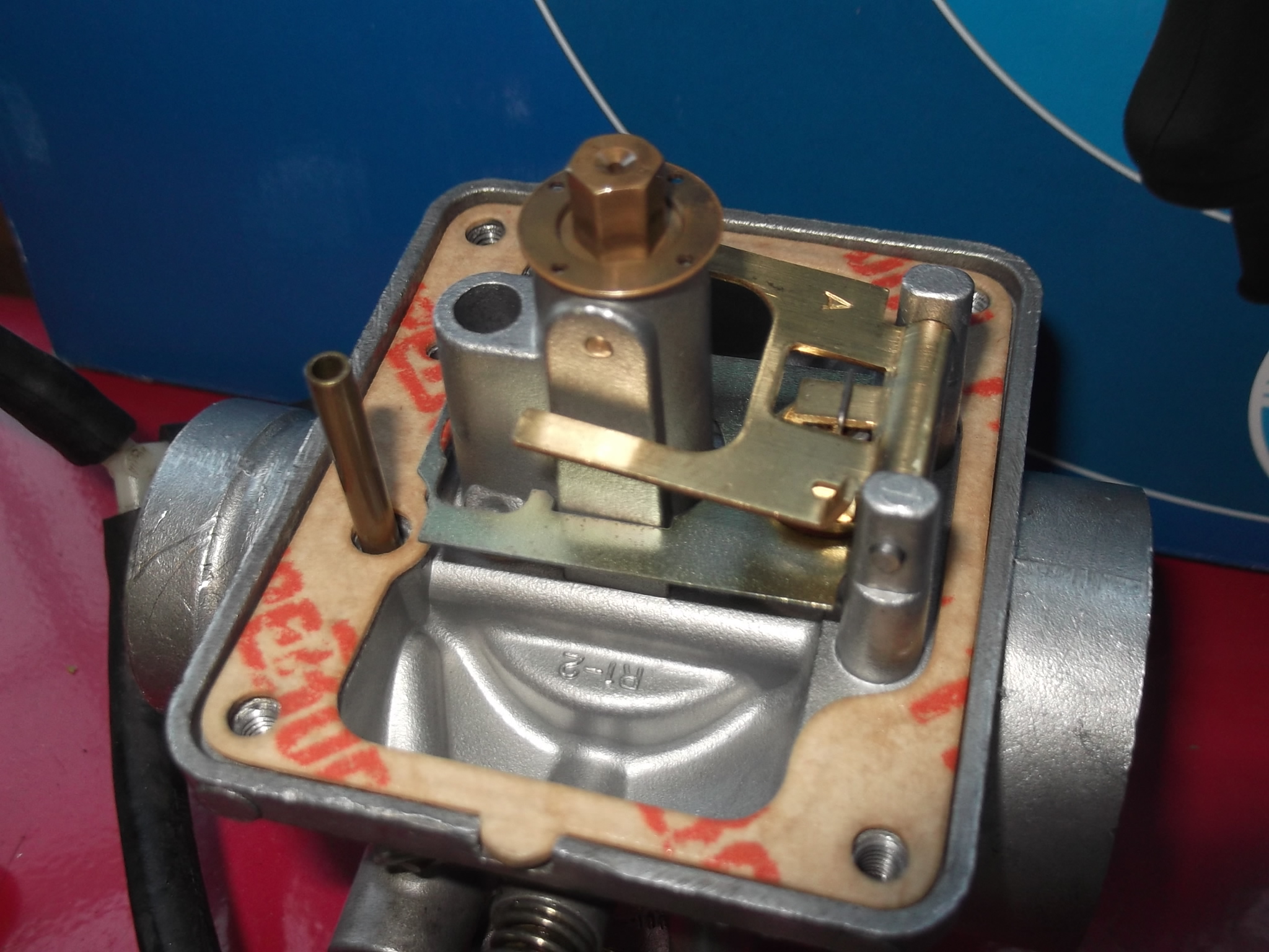

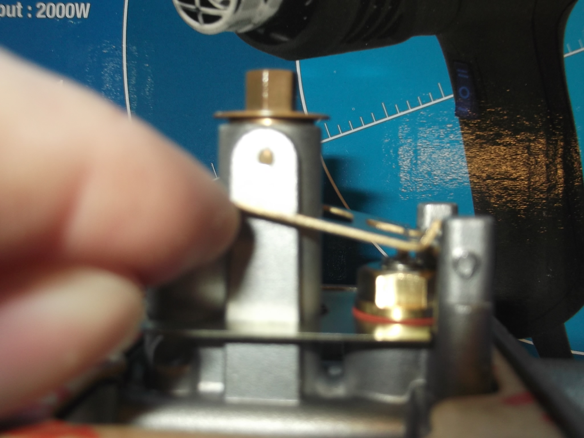

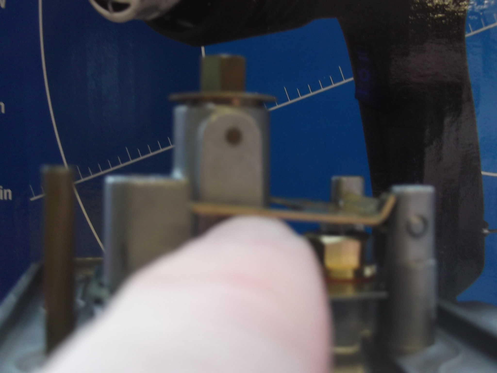

Ok here is where I am at I have been adjusting the carb all day but it still drips from the overflow on the float bowl when the bike is reved. I have a new float arm so I thought I would start with that as the old one has been probably bent to many times. I have set it up as per instructions, I have taken a couple of photos. I have adjusted it so I have about two mm of travel but the carb still drips. If I adjust it any further it will not let any fuel through. I have piped the carb up to a test fuel tank to check that when the arm is in a closed position it shuts of fuel which it does. I can’t see that the carb is fouling on the exhaust or anything. I have taken the floats out they look a little rough in a couple of places. I have sprayed carb cleaner down the float tubes, they seem to slide nicely. I took the floats out of the carb and put them in a bowl of petrol and held them down with my finger, there was no bubbles. The floats have some lines on them but I think it is from when the where moulded. There does seem to be some surface cracks so am thinking about buying some new ones but they seem to function as far as I can see. Thinking about the whole vibration thing when I got the bike the metal tube which comes out of the top of the carb was loose and I tightened this up when I have been fiddling with the carb. So I wonder if this need some free play in it and if it was tight maybe it could vibrate disturbing the carb. But I have slackened this off and further loosened the play in the throttle cable but this has made no difference. I have nipped a hole in the atmospheric pipes. I can’t see the floats fouling on the gasket. I am out of ideas really as I say I could replace the floats but beyond that I don’t know what I can do? I could lower the float height and then adjust that for the 2mm of travel?
The picture  3 with my finger in it shows the lower position of the float arm and then the next photo 4 shows the float arm in the stop full position.

Whoa! That adjustment is really wrong. Pointing to that angle bit on the jet tower should be the limit of travel with the valve open. Resting upside down like that the float arms should be level when the valve closes. Parallel to the float bowl. Are your floats upside down?

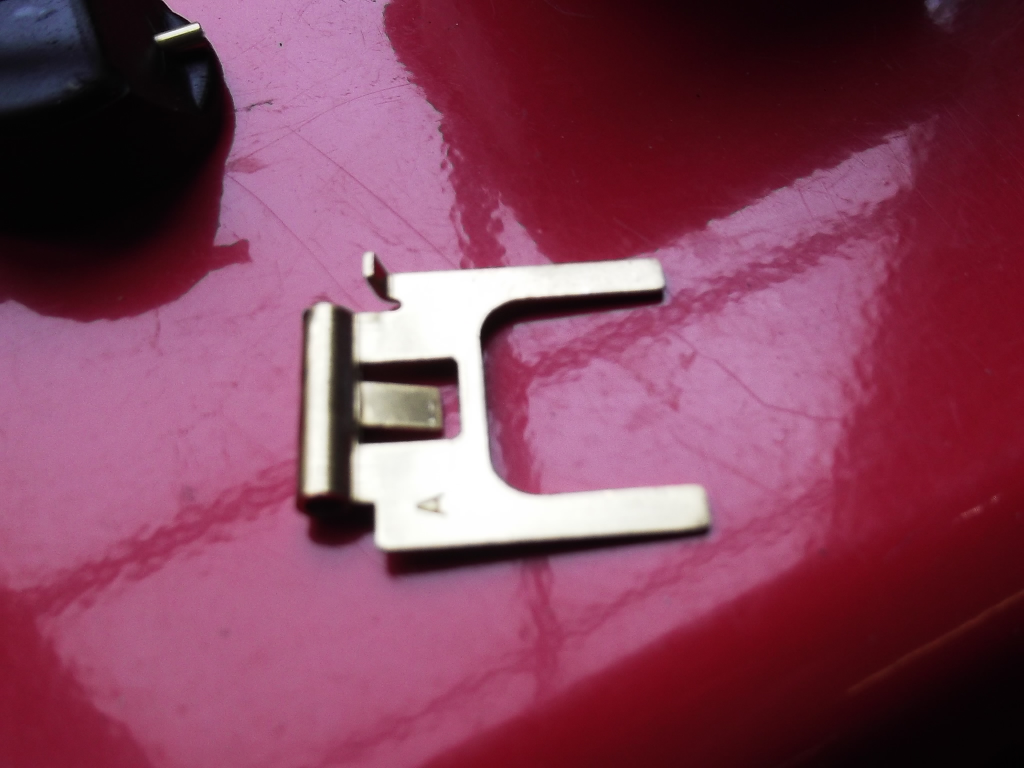

Notable  The inside brass tab is bent all wrong.  Take the brass tab/tanga off and make them all flat. Before you do take  a side profile picture of the brass tang off the carb. You never bend the outside long tabs only the smaller tab in the middle.

Nope,  angle of the carb slightly affects the pilot mixture on a Beta which is why they tend to stall on downhills. If you look at the main/needle jet tower it is in the center of the float bowl. The pilot is also close to the middle but still on the centerline. Pour yourself a glass of water and stick a straw in the middle. No matter how you tip the glass the water level in the center where the straw is stays the same. So with a concentric carb no matter how you tip the bike the main/needle jet combination always sees the average level of fuel in the bowl. Keeping the pilot circuit on the centerline means the pilot circuit is unaffected by leaning the bike side to side.
Your adjustment is way off. When you hold the carb as shown the float arms should be level. Flat. Parallel with the float bowl seam.
You should then be able to lift the float arms up to where they are stopped by the stop tang pointing to the right angle where the pilot jet platform meets the main/needle jet tower.
The little brass tang stops the travel of the fuel shut of.  It is VERY undeniable to have move more than a few millimeters as it change the angle of the longer arms arc the further it travels there is also a chance of debris or dirt getting in.
The fuel needle is not analog its like a digital on or off.
However the perpendicular tang does NOT stop the movement of the floats.

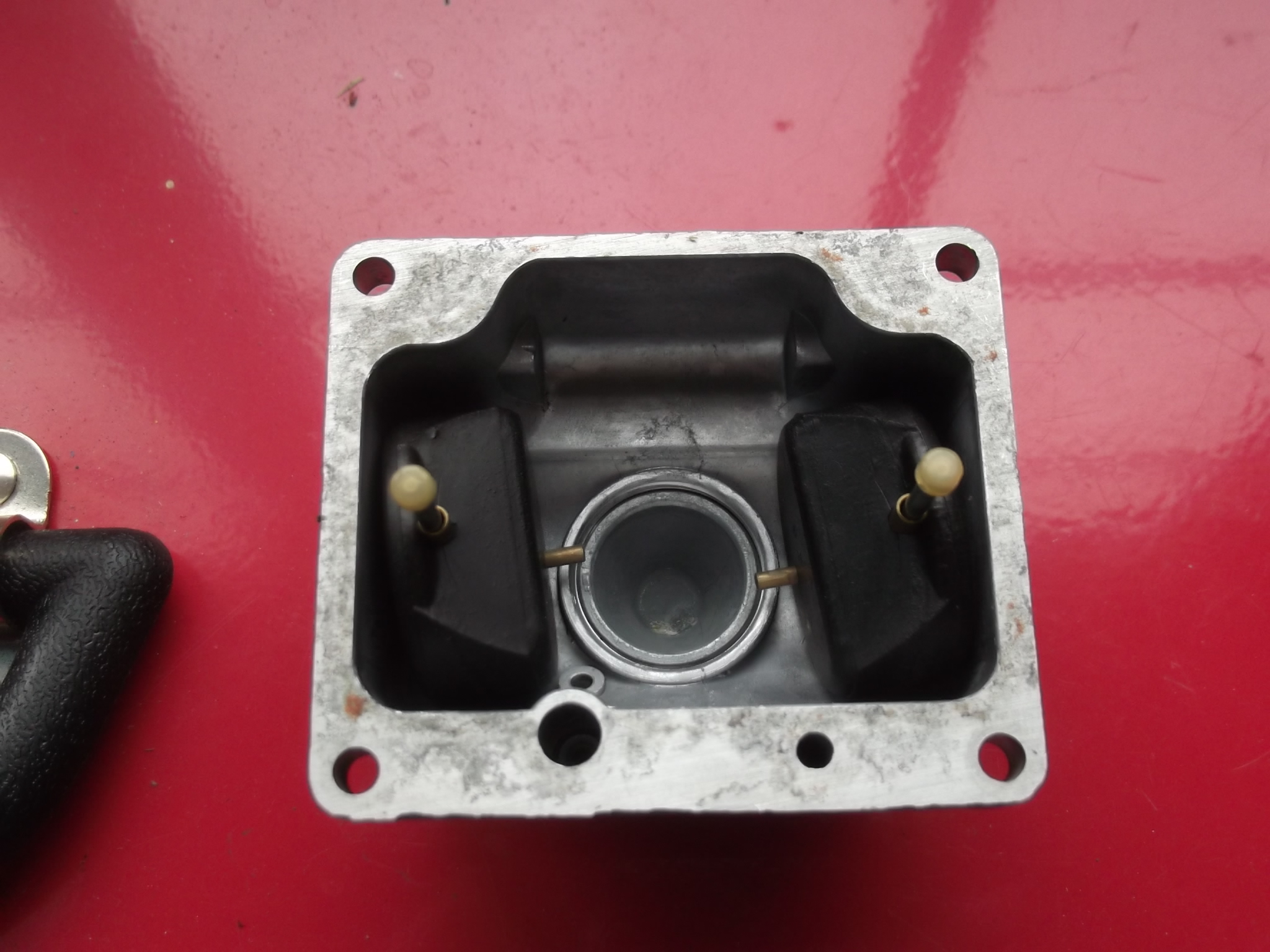

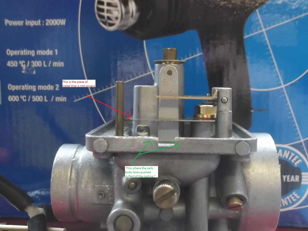

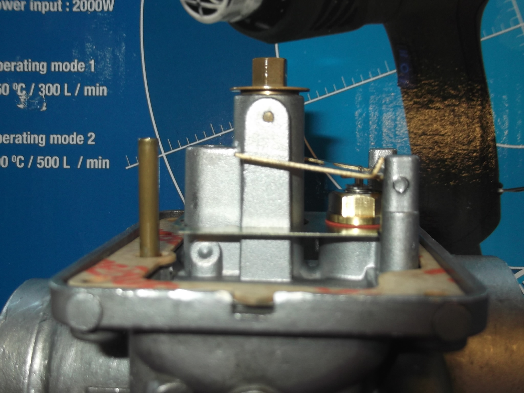

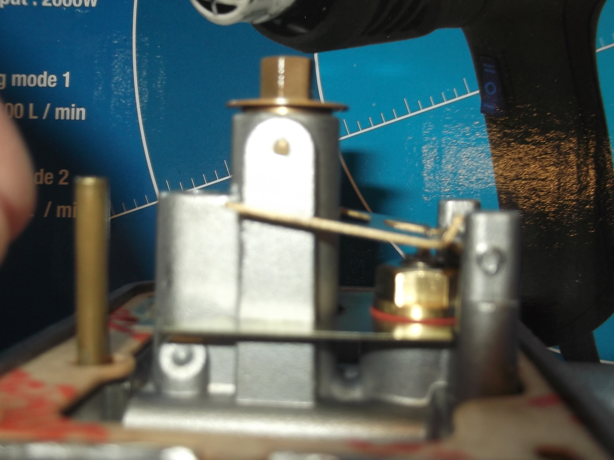

Hello guys, ok I have taken some photos as you requested. Yes Dan I had set it up all wrong, thank you for the education. As I said I don’t know what I am doing and am trying to learn as I go. Thanks for explaining about the straw and the glass of water I understand what you mean.
The floats must be the correct way round as if I reverse them I can’t close the carb float bowl. I have straightened the tangs and have tried to reset it as you said. With the height adjuster tab straight the float lever arm is not quite parallel to the bowl as you can see from the photos. I would have to bend it in the opposite direction to make it completely level. This that what I should do? I have restricted the movement of the float arm and got it to almost line up with the lower tower. I am not sure if I am now adjusting it as I should have done in the first place? And if I am getting closer?
I have put the carb on the bike with the adjustments shown in the photos. I still get the same results.
