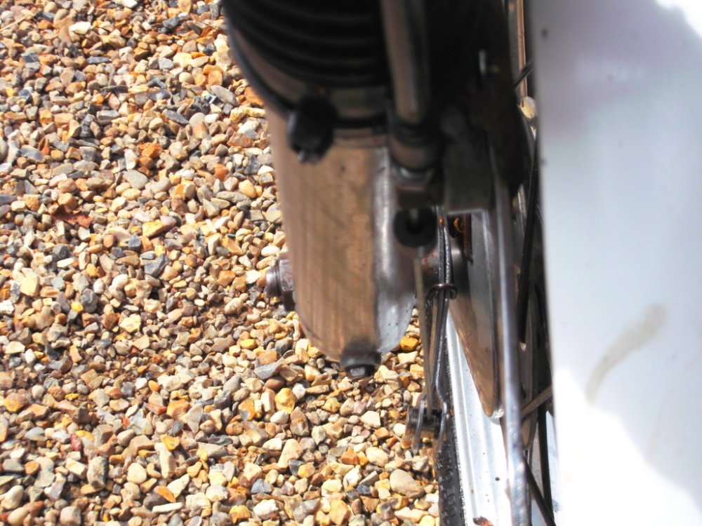

Hi guys, my front brake still isn't as hard as I would like. I have noticed that my brake arm is at a poor angle to the where the cable meets it. The arm pulls up and flexes sideways due to this.
I also think my brake arm is delaminating and will get it to my welding friend to see if he can beef it up. Maybe bend to out to suit cable and weld plates to it?
It is bad angle normal?

A picture tells a thousand words....or two thousand in this case.
Yes it looks wrong.
I'm thinking the cable holder should be on the inside of the mudguard mount and then when you straighten the brake arm, the cable will have a straight pull.
I have done as I just described with my Cota 348 which appears to have the same brake hub, arm and mudguard mounting arrangement, and it works very well

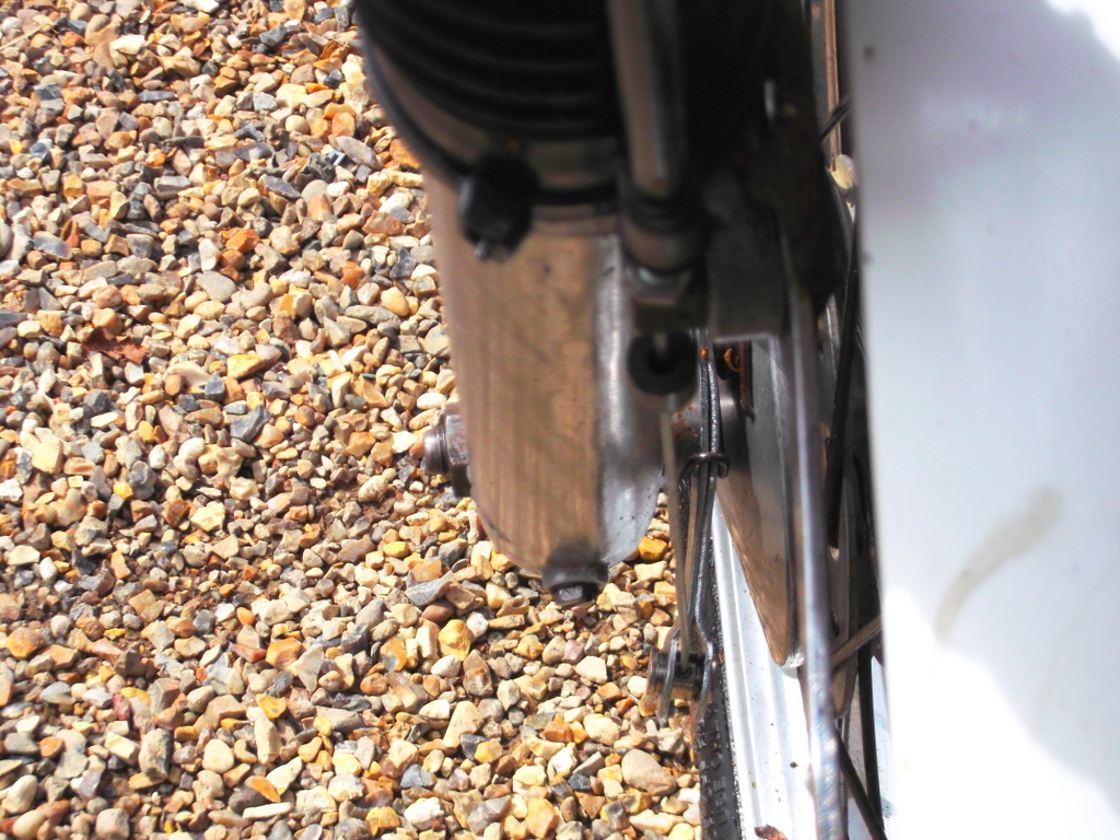

Just had quick look and it looks as if there isn't enough room to place the cable retainer on the onside of the fork leg....odd?
Wow thats tight....maybe I do have room afterall.
Thanks for taking the time out to take that pic'B)

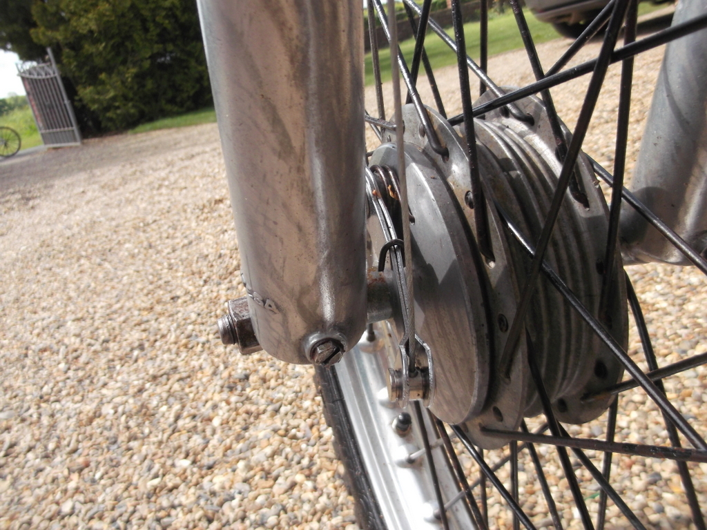

It does fit on the inside of the fork leg!
Well I measured the gap using my vernier and low and behold there was room.....just, to fit the cable retainer on the inside of the fork leg.
Angle is now perfect but had to take a nibble out of the mudguard for the cable.
That front brake arm is still bugging me though. It seems to be two pieces of tin spot welded in but two places and really needs beefing up. I can still see it flexing and it's super easy to bend.

Not sure if your brake arm is an OEM part.... looks like a replacement  ...?
Also the original run was on the outside of the mudguard stay

Sounds like the typical brake arm, mine was made the same way and bent/twisted like yours when I got my bike. The cable retainer had been fitted wrong and the front wheel was in backwards, so plenty of angles were wrong. The brake arms seem strong enough when they are straightened out (takes some doing to get them right) and the cable angles are correct. If I find mine starting to twist under pressure with the angles correct, I'll make new brake arm/s as needed or find stronger alternatives.
