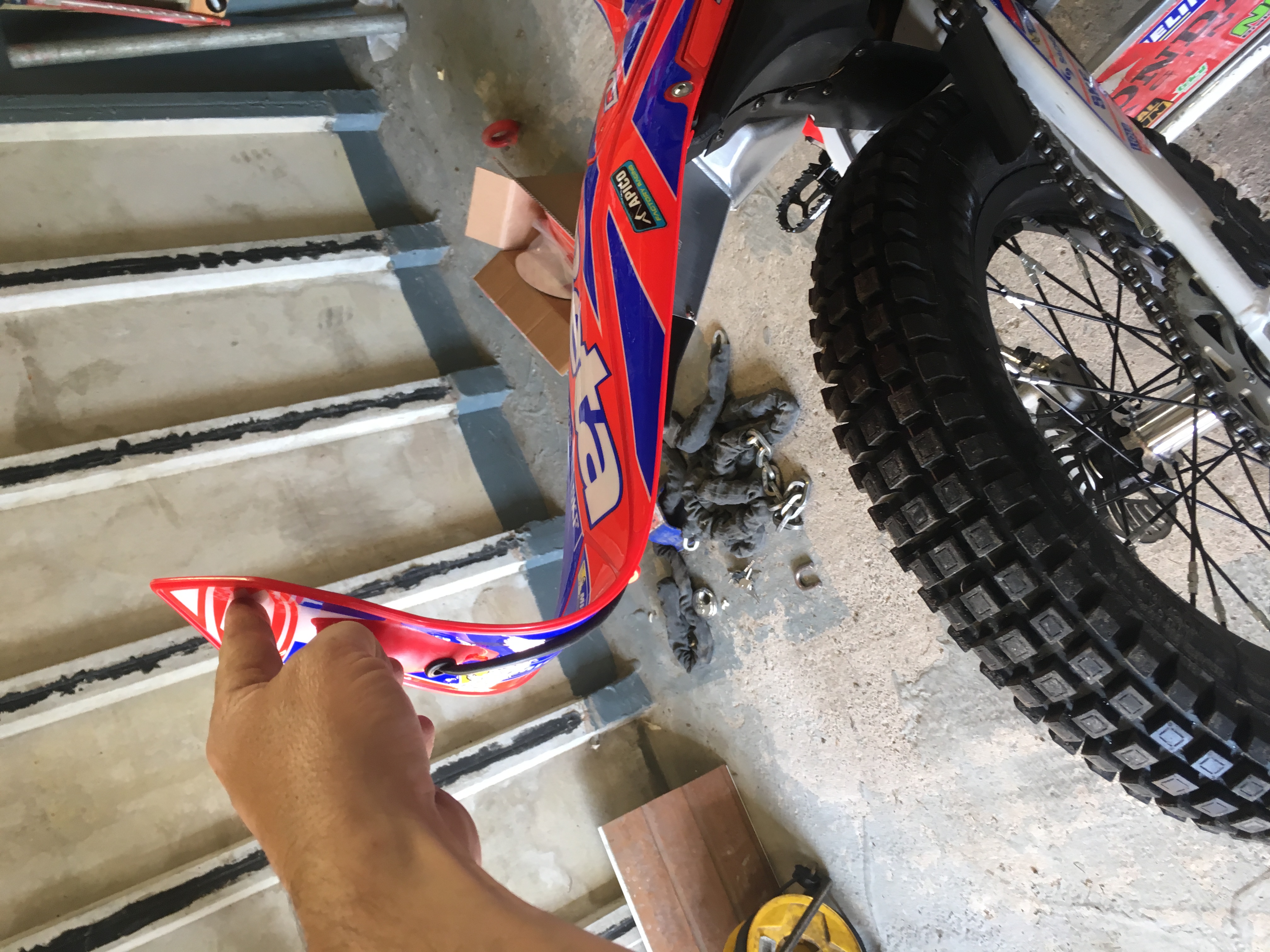

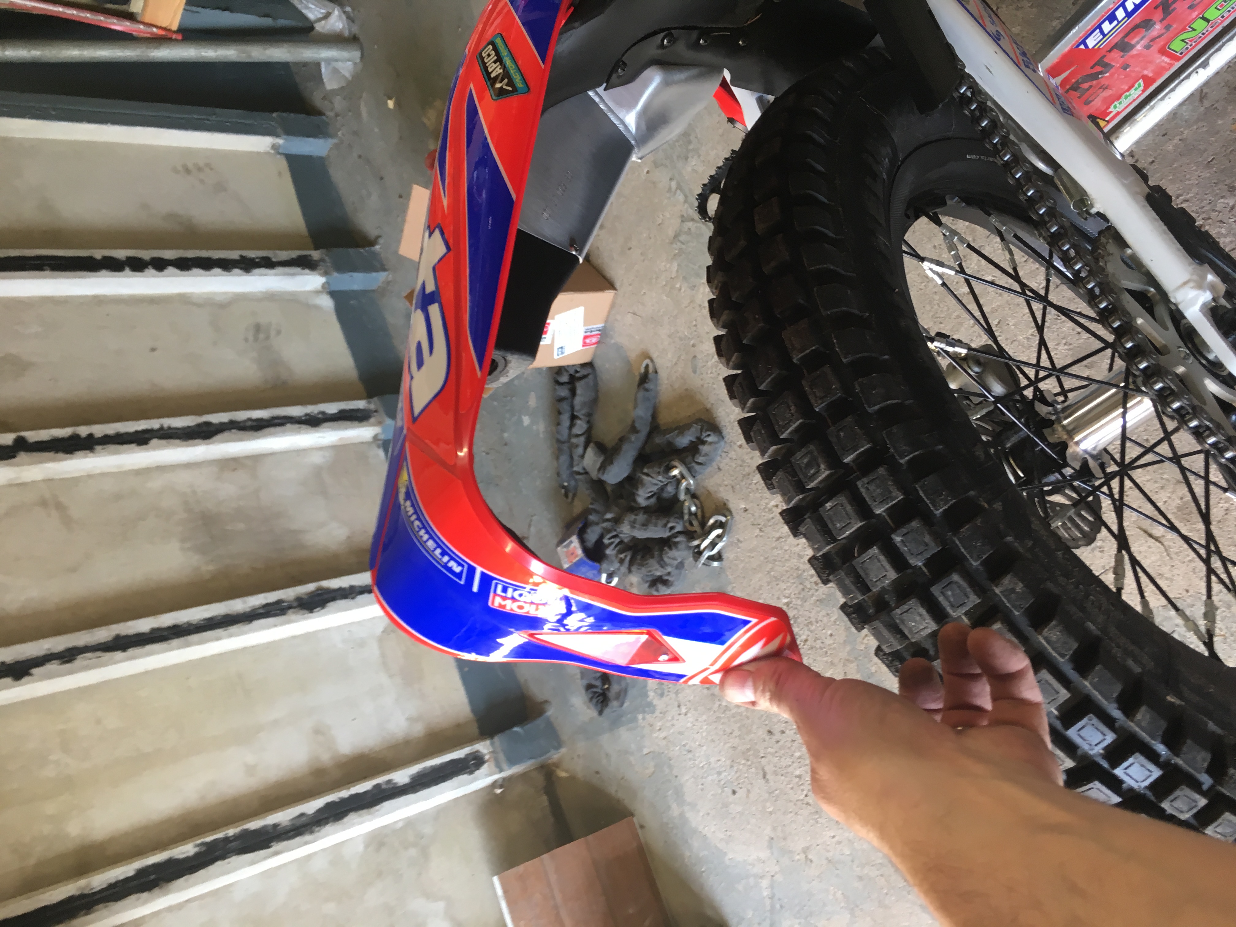

Whats the deal with rear fenders that break easy? Is it real?

I all way's turn the rear fender and airbox cover into a one piece unit by putting two wood screws into the under side of the airbox cover. Trim a little off the bottom of the airbox lid hole, then fill the top with hot glue gun. Then not using any of the bolts and using 2 zip ties at the front holes to hold the fender on. Rear fender will pop off rather than bend, crack, then break. Carry some extra zip ties in your bum bag. Still using my 2013 fender on my 2016 4t.
