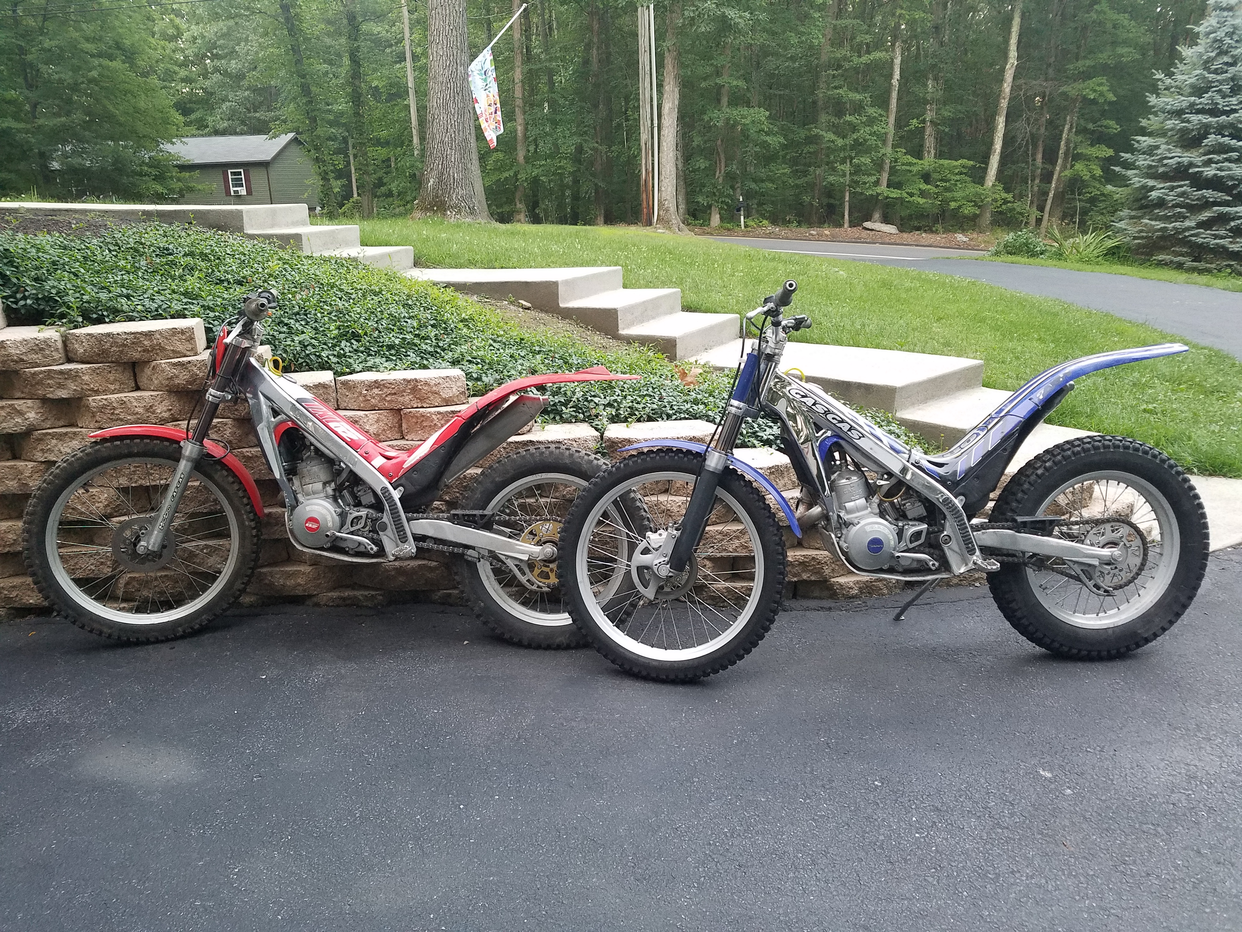

July 11, 20179 yr First post here, hoping you guys can provide some guidance. I just picked up a 2001 TXT 280 and a 2002 TXT 280 Edition (from the same seller) and need some help. Does anyone have the owners manuals or a way to obtain them? Same thing with the service manual. I need to change fork seals and would like oil height, torque specs, etc. Also, are there any things I should be looking for on these machines? They've been loved, but are in workable condition. Lastly, how much rotor float should there be on these bikes? Both bikes' front rotors are loose. Bolts are tight, but there is a large amount of axial and rotational slop. I don't know if the bushings are worn, if the rotors are past their prime, or both. Or if this is just normal. Hopefully a service manual will shed light on some of these questions.
July 11, 20179 yr You can download an parts manual from the GasGas website: http://www.gasgasmotos.es/us/manuals/models-1-2001.html but no owners manual I'm afraid. The brake discs (rotors) are floating so there should be some movement. I think the older bikes tend to have more float. There are washers that hold the disc on but allow float, as long as these aren't bent, the float should all be normal. Cheers Wayne. Edited July 11, 20179 yr by waynerobshaw
July 11, 20179 yr Author Thanks for the responses, guys. I did find that link to the Gas Gas site the other night and the parts diagrams were very helpful. Bummer on the owners manuals, though. I'd like some of the simple information such as fuel/oil ratio...the owner was running 40:1, but I've 'heard' that these need MUCH less oil. I literally know nothing about these things...other than I can have a blast in my backyard for over an hour! I'll check out that YouTube link, thanks! Back on the brakes, though. How good are the front brakes supposed to be? I get a really good squeak out of it and it doesn't bite anywhere near as hard as I'm used to. Even my lousy old KTM has a better front brake. I guess I expected a stronger brake on a trials bike to loft the rear wheel. Something like the rear brake which works AMAZING. Hopefully just a matter of a fresh bleed and new pads(?).
July 11, 20179 yr The brake rotors are “floating” type which means they can move some, but they should not rattle. Pop off a couple screws (or all if you want) and put a dab of silicone glue on the tabs, then reinstall the screws. The squeaking can usually be eliminated with a little deglazing of the rotor and pads with some 280-220 emery cloth. New pads are pretty inexpensive if they are badly worn or too thin. Bleed the brakes well with new fluid. Rebuild kits for the master cylinder are also pretty inexpensive. I thought my brakes were OK but after rebuilding and bleeding I was pleasantly surprised at how much better they worked. Compare the size of the rotor on your KTM to the Gassers. Probably a lot bigger diameter on the KTM. You don’t need massive braking on a trials bike, you need to learn proper body position and techniques. Watch some good riders who can hop their rear wheel when completely stopped. That is not about brakes, that is technique. Enjoy your bikes.
July 11, 20179 yr Most people run about 80:1 fuel:oil ratio. Reducing the oil will result in a richer mixture so you may need to adjust your idle screw a little.
