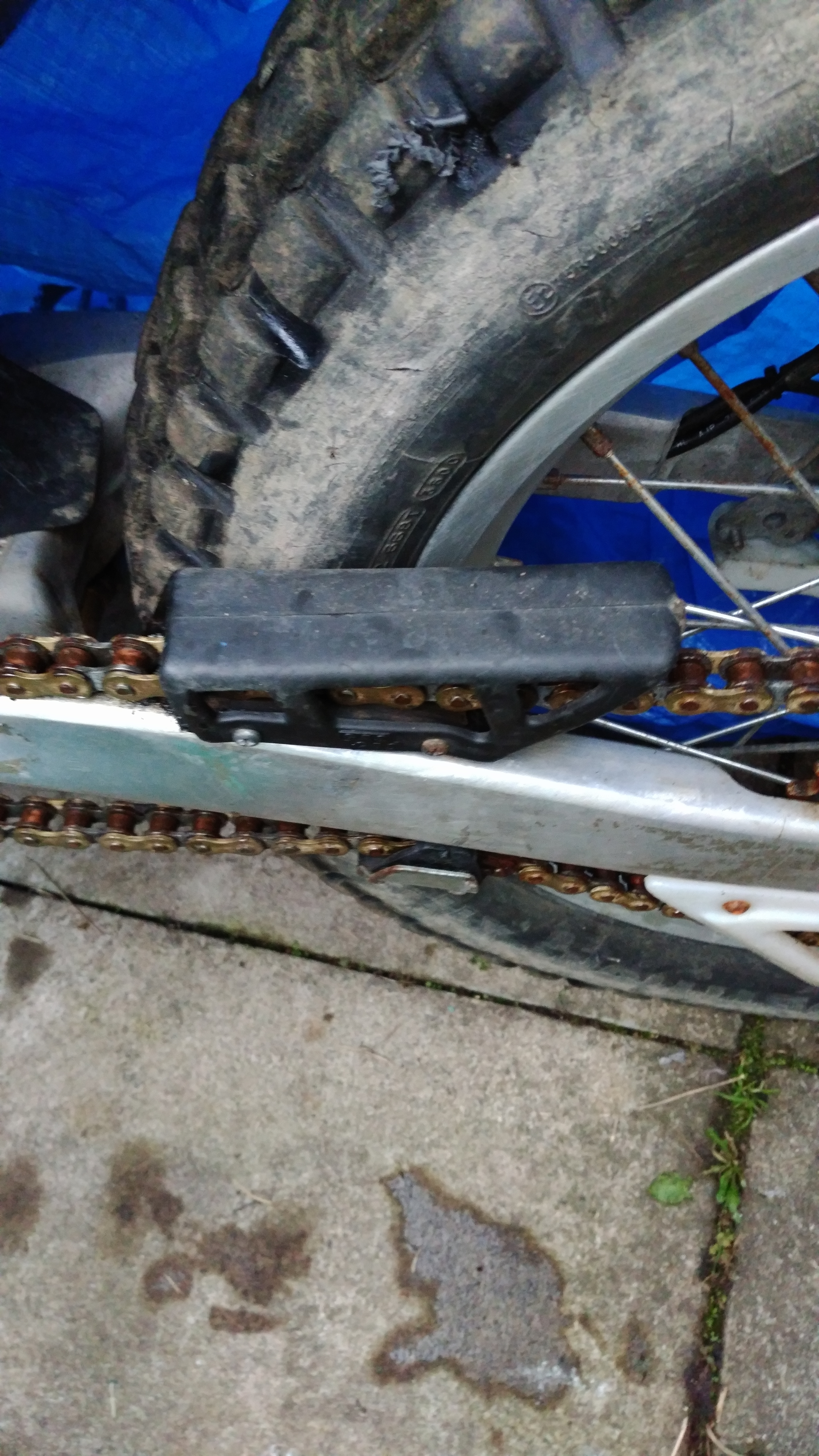

September 27, 20179 yr Author Thanks a lot lads, Here are piccys, so I assume all is ok. Just need to get the bike going and fit a lanyard type cut-off switch/
September 28, 20179 yr Author Yes. Must do. It also looks a bit loose, so must adjust. It seems to have some lube on it. I ride a bike which is shaft driven. Much easier. Nubsey
September 28, 20179 yr Yes, does look rather slack. The top run of the chain appears to be drooping. After adjusting remember to check the chain tension when someone is sitting on the bike as that takes up some slack.
September 28, 20179 yr The general rule of thumb (pun not intended) is a fingers width between the top of the chain tensioner block and the swingarm. Edited September 28, 20179 yr by faussy
