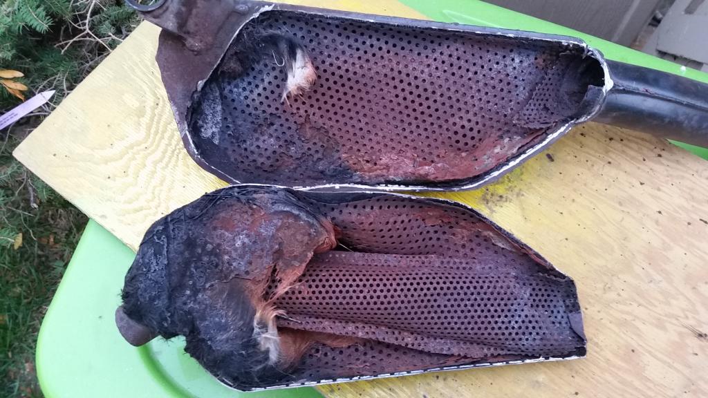

I cut a small piece out of the back of the box for a look-see and it is a real mess of packed solid gunge and carbon.
I've seen the very helpful pics from Searay175 on 03/11/16 (attached) but can't quite figure out the best place to cut the rear end of the box. There doesn't seem to be a lot of space to cut between the outlet and the mounting bracket like he did and it looks like that would be a real pain to weld up again.
Any words of wisdom would be greatly appreciated.
That's the "attached helpful pic from Searay 175".

The pics I found previously showed the rear of  the box cut off , but you have cut off the front, which seems much more sensible so I'll do it that way.

I did mine the same way as Searay175 did - doing it this way makes the cuts & rewelding less visible when fitted on the bike.
Takes a while to dig all the crap out but definitely worth doing!
