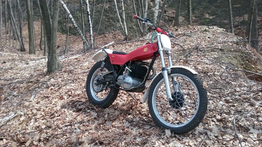

    Picked up the Montesa the other day finally had a chance to take some pictures last night
  • dirtrider6
    dirtrider6
    From the first initial ride up in the mountains behind my house
