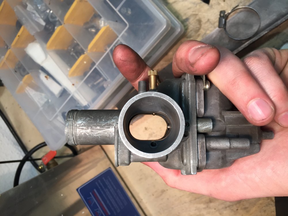

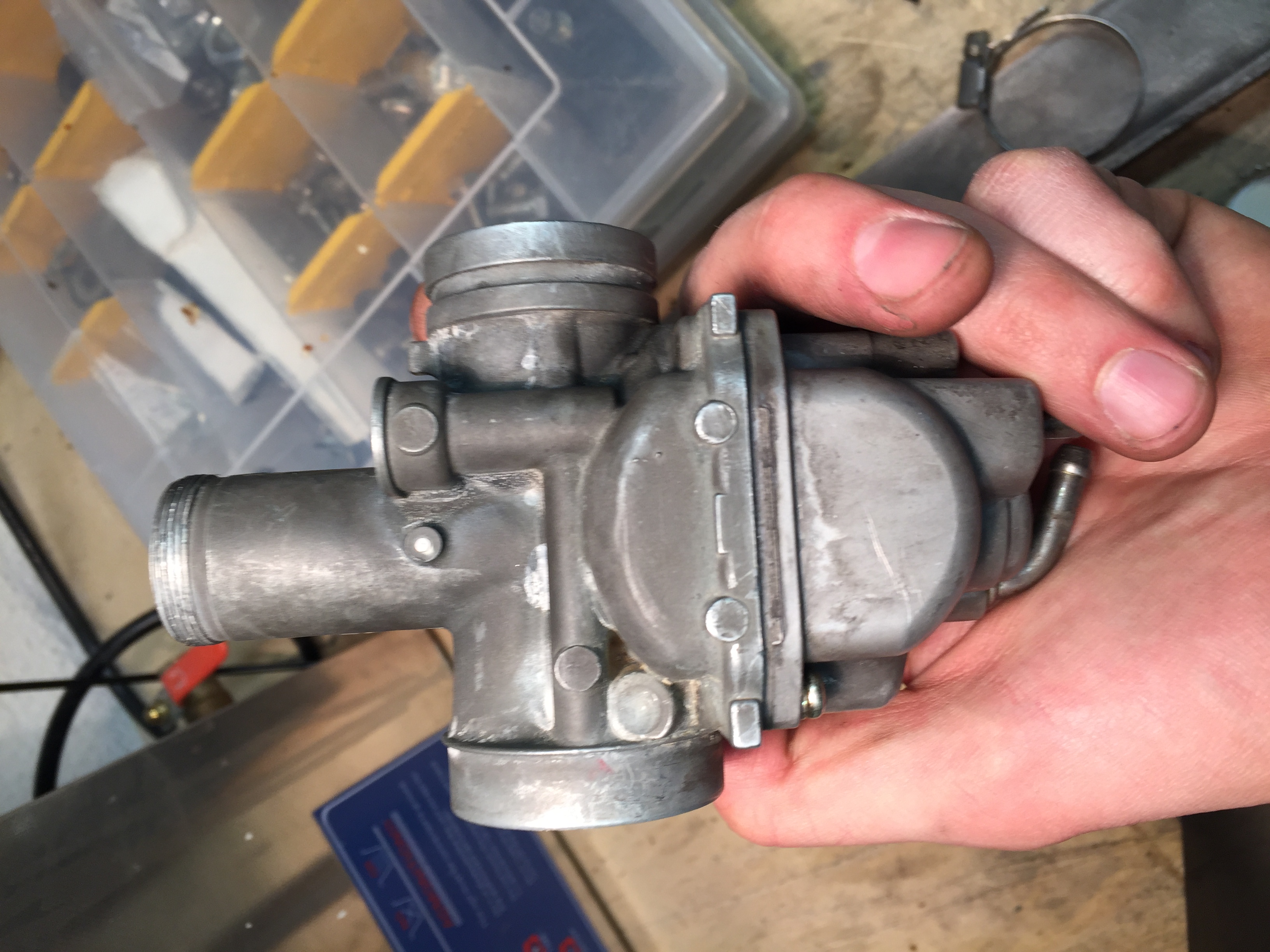

I have searched the depths of the internet to find a replacement for this carburettor but I have just about given up on hope in finding one.
Please can someone point me in the right direction to a mikuni specialist or advice on a suitable replacement. Its is for a 176.3cc 4 Stroke engine.

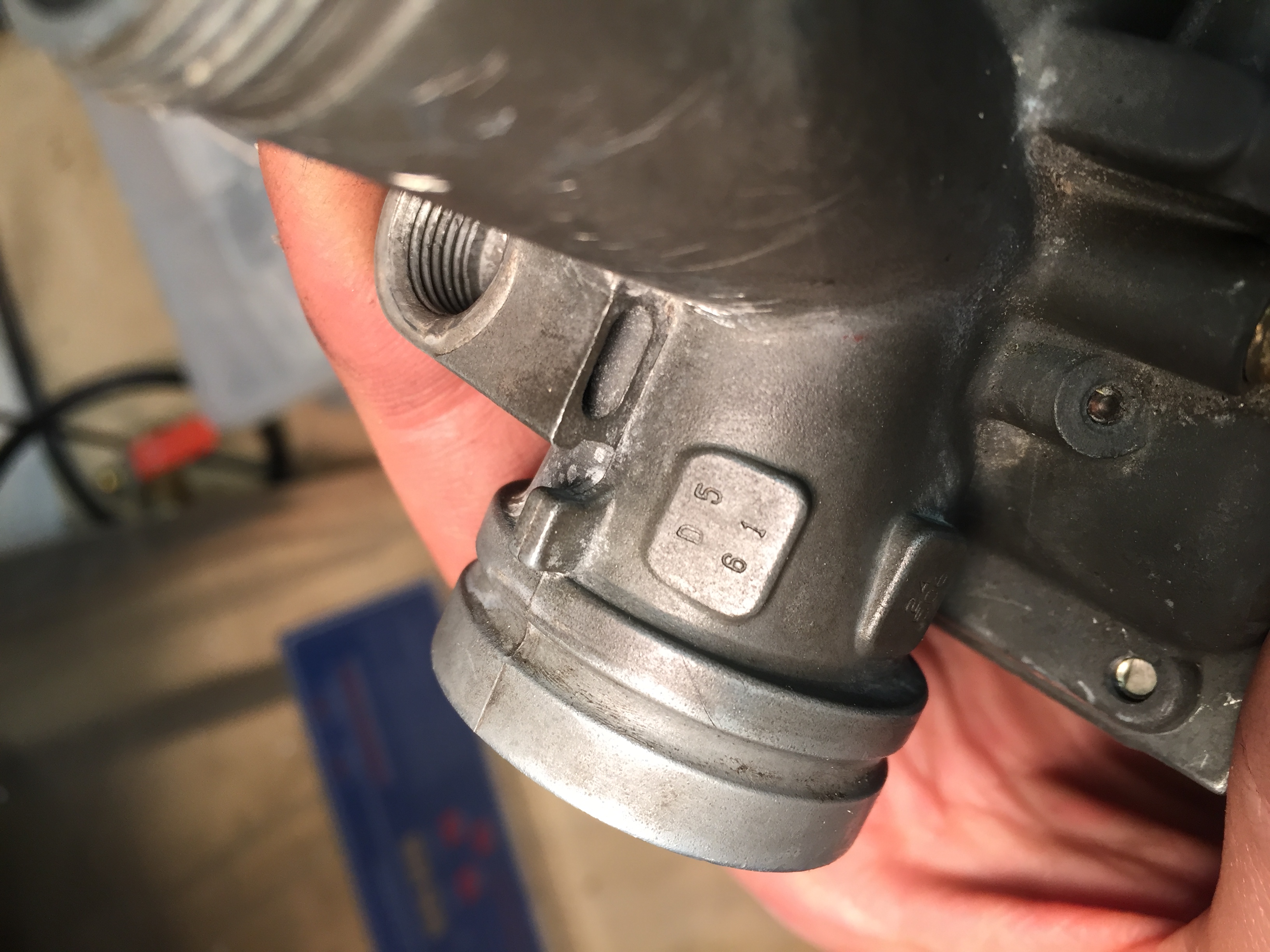

The numbers on it are :
24506
D561
Thanks in advance.

I would suspect Yamaha DT175 but not sure of exact model. 506 looks like pre80 model numbers
That looks like a carby made specifically for a manufacturer for a particular model bike so will not be available new from Mikuni. It would be helpful to share what motor the carby came from.
Yamaha 506 is YB100 (two stroke)

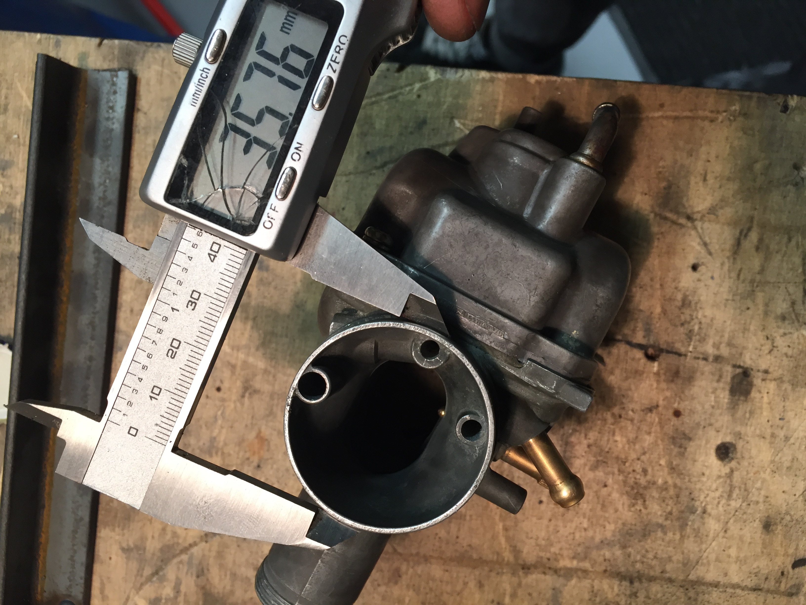

If the existing carby mount attaches to the head with two studs, you might be able to use a (flange-mount) pit-bike carby. It would require a flat isolator and longer studs
Thanks for the replies so far, its for a HERCHEE Adly 220 Quad 180cc. Ive tried fitting a 28mm MOLKT carb this week but it was a bad idea, even with the jet kit it is just to big for that engine.
  • 6 years later...
I have those carbs, I was the Tech manager for Adly Moto until they pulled back from the US. It's a 24mm carb, 105 main, 22.5 pilot jet, NJ 1E, Needle 5Ngy72 and a 2.o slide. They are set up for a cable choke but you can buy pull or lever chockes for them on the market. Not sure since Sudco is closing up.
