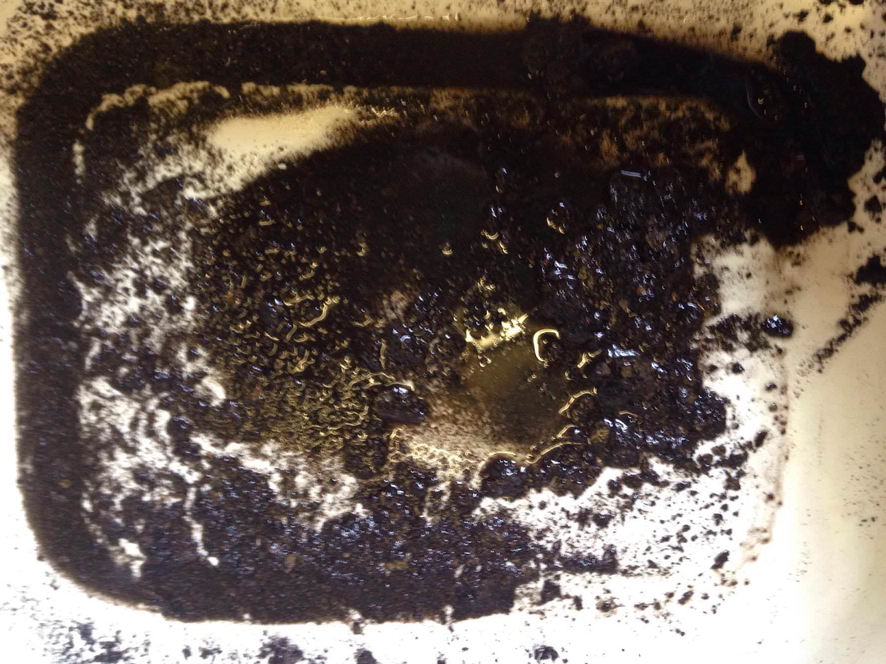

shakennstirred Posted April 14, 2018 Report Share Posted April 14, 2018 (edited) Apple cider vinegar works great, this came out of a friends tank, after nothing else he tried worked. The tank was totally clean after. Leave it full for a few days Edited April 14, 2018 by shakennstirred Link to comment Share on other sites More sharing options...
