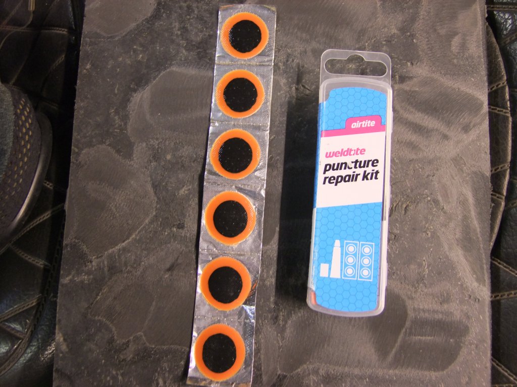

May 9, 20188 yr This is the one I use, small, light, tapered edges, cheap & two minutes for the glue to dry if applied thinly. Get 'em from a cycle shop. I always carry two tubes as well. Message me if ye stuck, I'll send one to the IoM for ye, I'me a bit nearer than you are. Dick.
