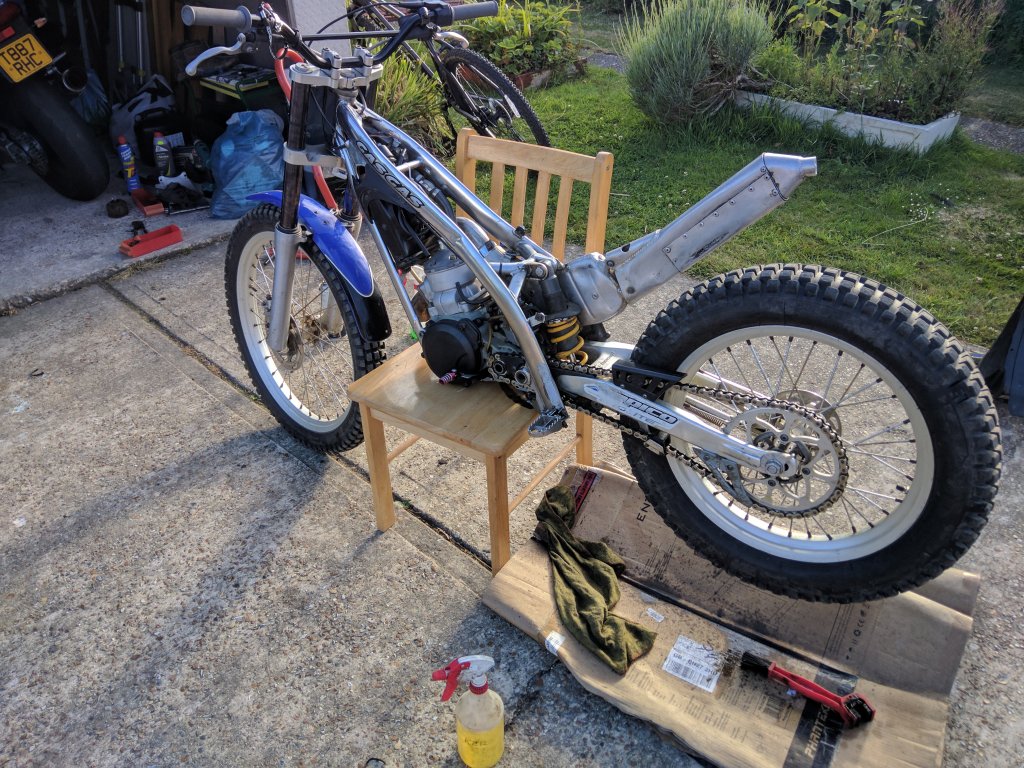

I recently bought a 2004 GasGas TXT 250, I might be completely new to trials but I'm not new to spannering bikes.
So today I stripped it all down and cleaned it all up, inch by inch and inspected as much as I could today and made a note of things that need changing/upgrading and or may need attention in the future. I didn't pay a lot so I expected to need to do a little work
Things I did
Downloaded the parts list and manual from GasGas
  • Drained all the old mix from the tank as well and washed it out with fresh fuel,
  • Inspected the spark plug. Seems to be running alright, not fouled. Electrode gap off by a fraction - may just replace it.
  • Removed the bash plate and cleaned the engine casings - discovered the sump drain plug needs a new washer. All other gaskets seem to be holding tight.
  • Stripped the plastics off and cleaned out the airbox - discovered needs a new air filter.
  • Inspected the carb - needs a service and a needs a new linking section between the airbox and the carb.
  • Inspected the front forks, no pitting but seals weeping slightly, so needs new seals. So may as well strip those down, juice them up with fresh oil and check the internals while I'm at it.
  • Front tire needs replacing, serviceable but old and worn. Rear tire ok.
  • Axel and running gear, calipers seem alright, but no harm at all in dropping the wheels out to inspect bearings and regrease things. Likely do that tomorrow.
  • May as well bleed the brakes while I'm at it and drop fresh fluid in.
  • May as well replace clutch fluid as well.
  • Brake pads are ok, but may as well replace them as they're inexpensive. Discs are good.
  • Chain old and greasy, cleaned that up, will adjust for slack otherwise seems in good condition. Sprockets are good.
  • Next up will be checking the rear suspension linkages, regrease/replace anything that needs it.
  • Rear wheel seems a bit p****d so will look at axial runout/axel/bearings, may replace.
So got a pretty decent list but I'm looking forward to getting it back up to standard. I have ridden it and it rides alright and the engine runs well.
