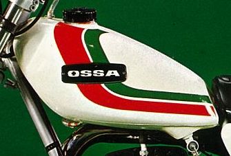

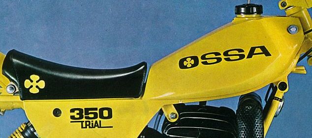

Has anyone experience with the new fibreglass replacement petrol tanks, coming out of Spain for MAR's and TR80's? Do they stand up to the new fuels or do they have to be lined?

Isn’t that white tank an aluminium, looks very like it to me...weld seams etc. The Gripper looks like an alloy one two, last one I had anything to do with had exactly that.
They're both fibreglass, Ossa only fitted fibreglass at the factory. Only UK bikes had alloy tanks. The MAR alloy tank is a different shape from the glass tank,  the Gripper alloy tank is the same shape but the tank and side panel are seperate units on UK bikes and the tank didn't use the front fixing bolts
Those "weld seams" on the white tank are present on all the original fibreglass MAR tanks I've worked on
