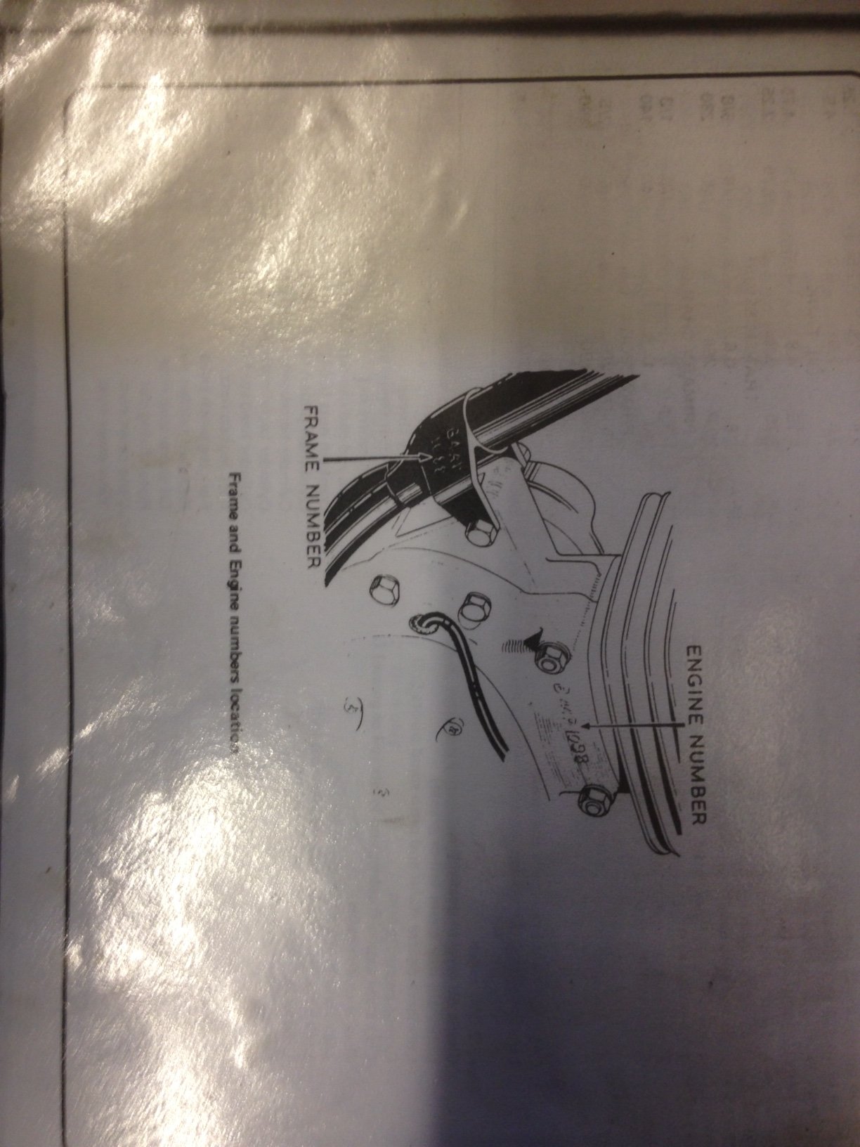

August 30, 20188 yr I was wondering if anyone could help me identify a bsa frame. The engine is a b40 and I was told the frame is a b25. There are a couple of things that seem strange. The log book has it down as a March 65 bike, but I am pretty sure the earliest b25’s were 68. I have the frame number in the log book, but I can’t find it on the frame, does anyone know where it should be. Also it seems like the frame has been modified. There should be 2 center posts, from the foot pegs up to the front of the seat. It seems like these have been modified to one center post. After having a look on google I can see a couple of b40 trials bikes that look the same. Does this look like a modified b25 frame, or maybe a c15 frame? Any help would be much appreciated. Thanks Sam

August 31, 20188 yr Author 17 hours ago, windlestone1 said: That's nice. Try the BSA Otter site, Charlie the site owner is very helpful and has a wealth of knowledge and archives he refers to It's funny you should mention that. I have spent a lot of time on that site this week, it's a great read. 16 hours ago, b40rt said: My B40 has the frame no on the left (as your sitting on it) front engine mount. I did check here and can't locate it. i wonder if the paint on the frame is so think it has covered it up. 12 hours ago, trialsrfun said: I think you may have a modified WD BSA B40 frame. The two tubes from the rear of the tank to swing arm pivot have been reshaped attaching much lower so as not to rub the ridrrs legs also I think the head angle has been altered, look at the down tube above the engine mount. You have a good looking bike which ought to work rather well. Thanks, I did look into the b40 frame, but they have a removable rear subframe and my bike doesn't. I haven't had the chance to ride it in anger yet as it still needs running in. I'm looking forward to getting out on it.

September 8, 20188 yr Author On 3 September 2018 at 11:46 AM, b40rt said: @samwisemcg Thank you, I found the number in the end and it is a b40 frame. It is under some thick paint and only just visible. I probably wouldn't have found it if I didn't know where to look. Thanks for the help all!
