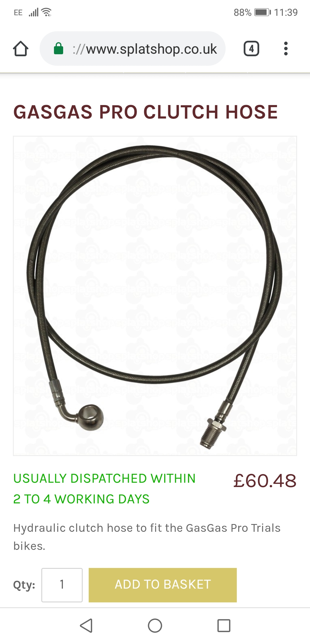

Looking at replacing it and the only place I can find for sale is splat shop...at 60 quid plus p and p!!!!
Does anyone know of any cheaper places? Or can I replace the hose with a non gasgas branded alternative??

Try Venhill, Goodridge or Hel for after market parts. GG UK sell Venhill kits Inc' clutch and brake hose with a throttle cable for £70. So £69 for just one hose is a ripoff.
