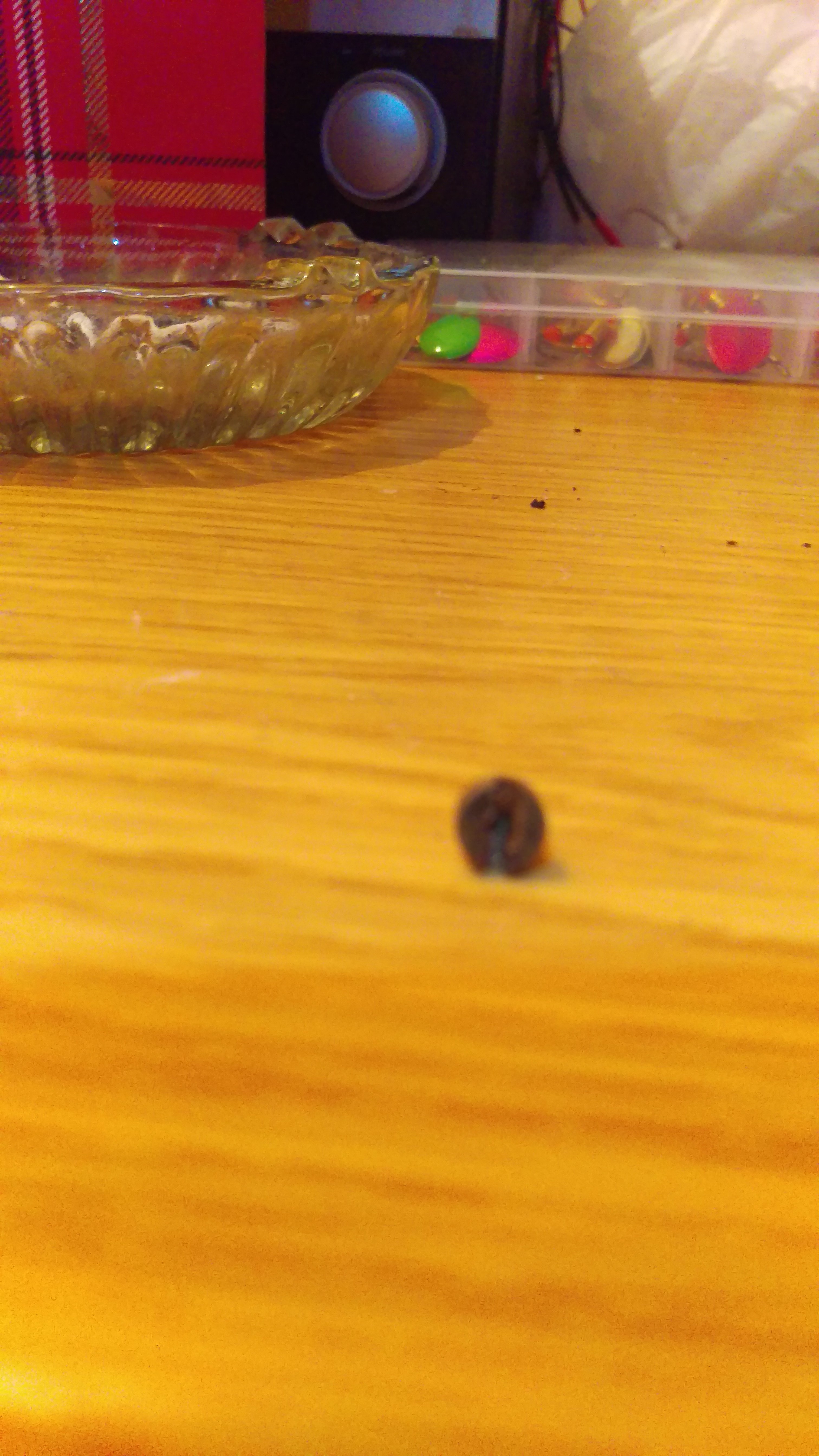

Evening chaps..the latest in my shenanigans..is this my pilot jet,and shouldn't there be a hole through it?IMAG0960.thumb.jpg.98341e1f65dd4aae367173d7c86d019e.jpg
This should have been your first post ...
But it isn't blocked with crap,it's just brass,there's never been a hole through it,or so it appears..can't get my head round it tbh,I thought it was just a bung and not a jet..
The hole is very small (which makes it block easily) Soak it in carb cleaner / brake cleaner, blow out both ways with an air line. Guitar strings will clean it but this is NOT recommended. When you last put it away it was running ok ? It so, did you drain the carb ? No ? The fuel will evaporate and leave deposits / varnish, this is probably the problem.
