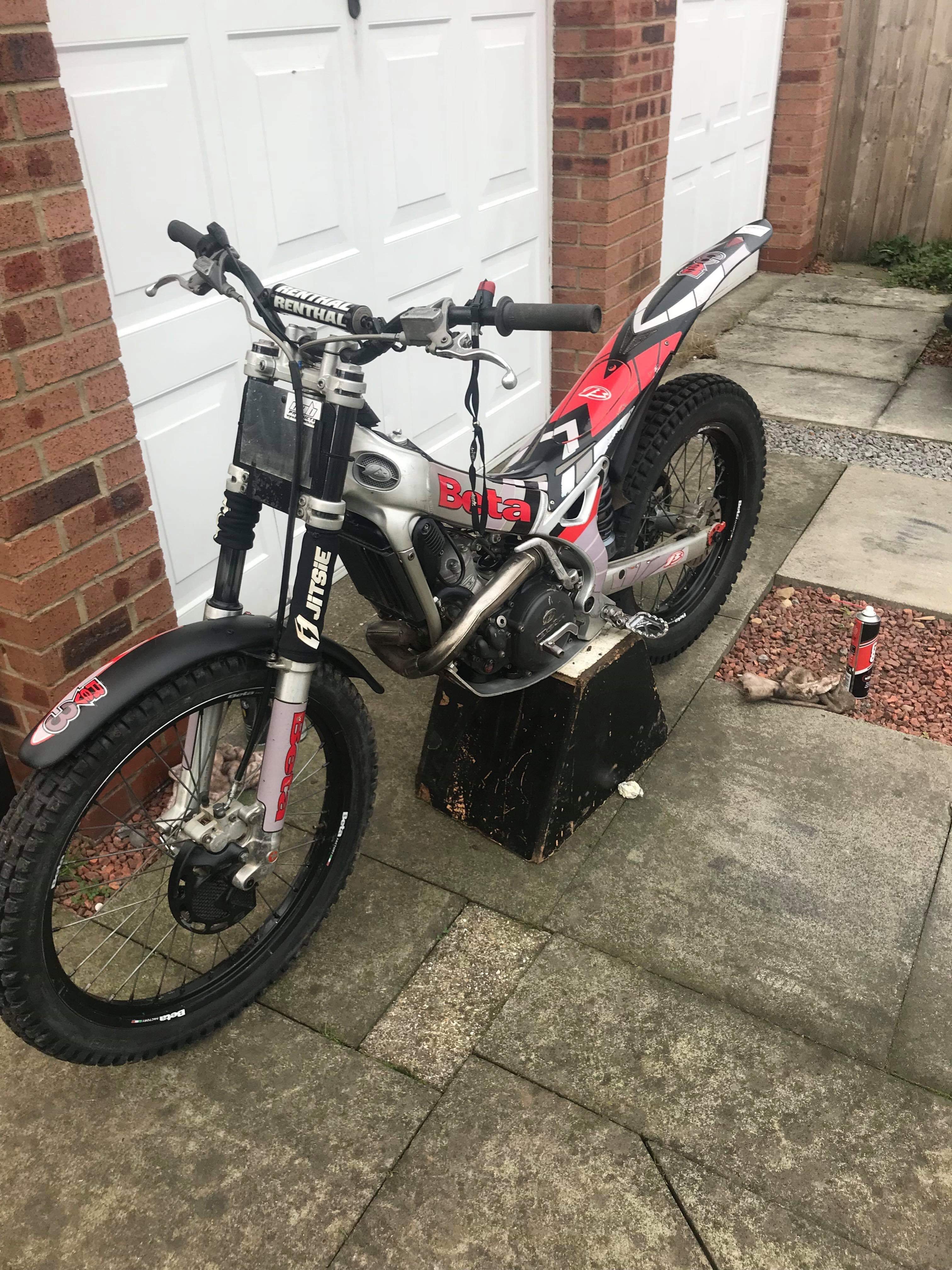

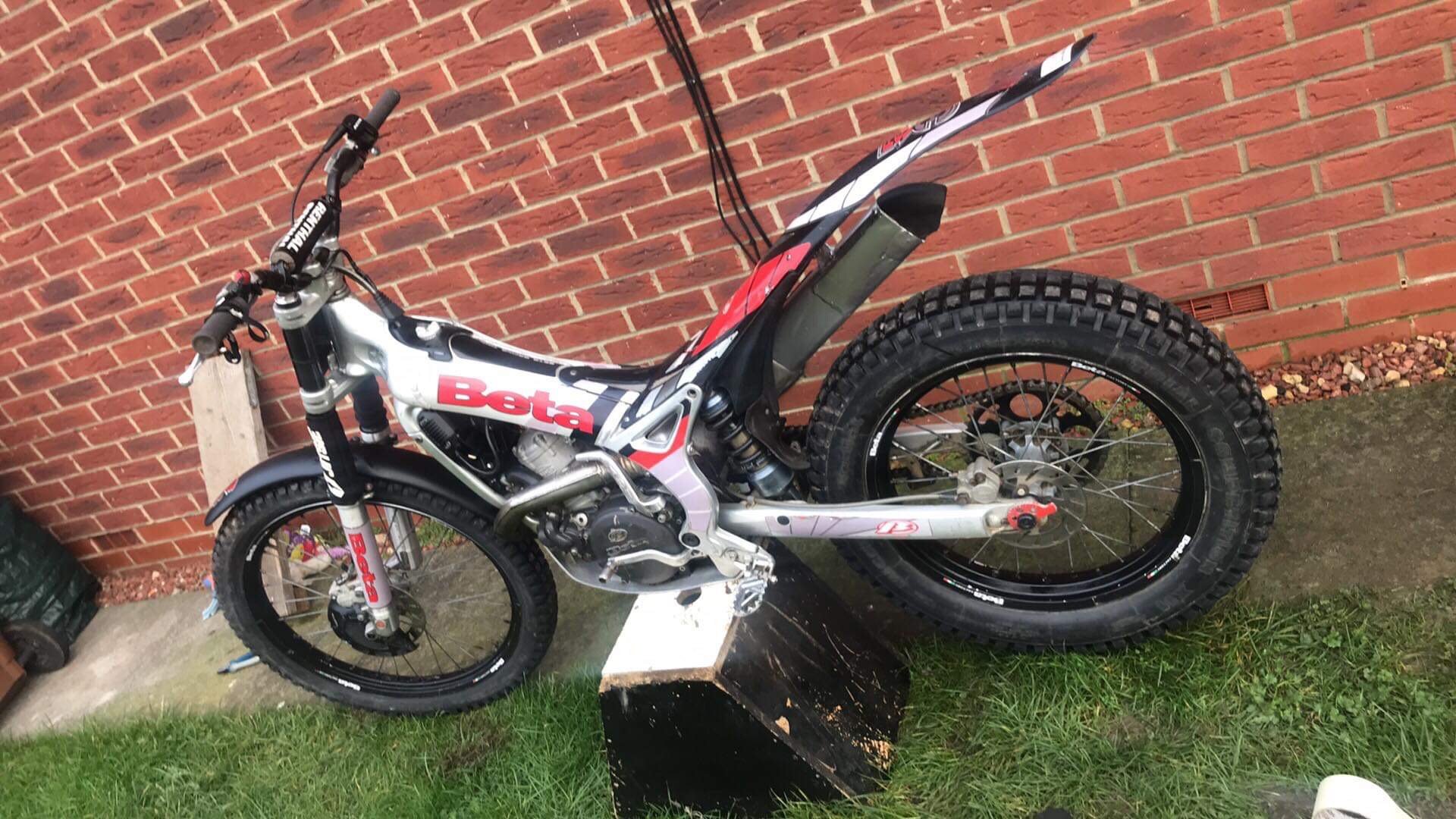

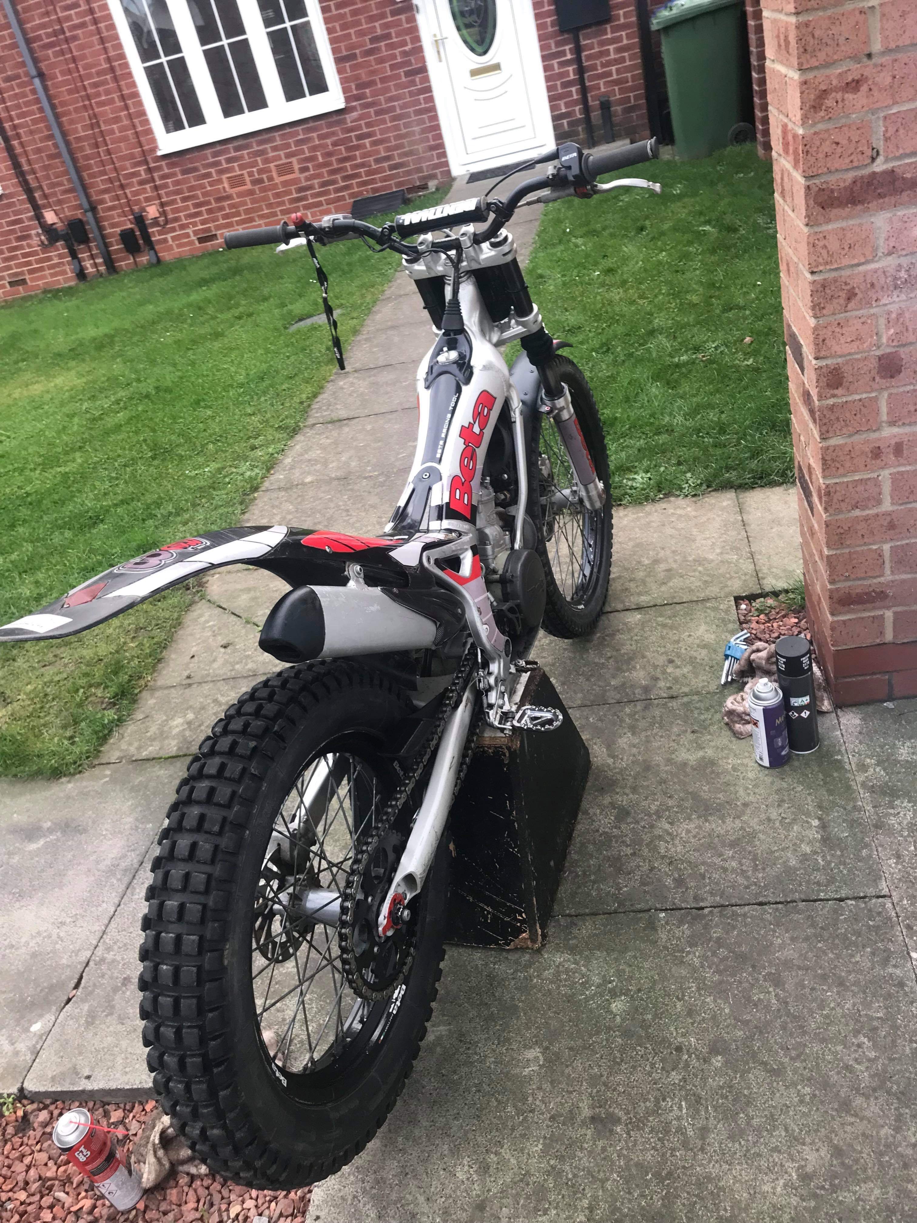

Hi Bought the old girl today £1000
its a genuine bike nothing really wrong only age related things ie: wore out Allen bolts  looks all ok  but going to go through it like a fine tooth comb
Looks a good one for £1000 mate , health to enjoy buddy
